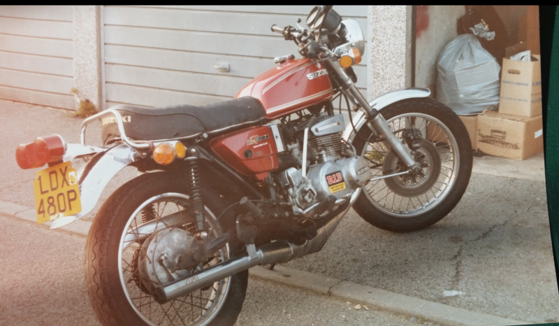

Had a Piper 3-1 exhaust on my GT550. The noise was spectacularly agreeable, even if the loss of power wasn't.

Lad I know back in the day had the same, TMB525R, iirc. You could hear every gear change from two miles away at night, still had to be the best sounding 2T ever with that pipe on.
A 380 has come up somewhere not far away for £3,000, might go and have a shufty at some point. Despite their bad rep from some people, they were great, if not a little thirsty and heavy on back tyres. 16mpg and 1,500 miles out of a Dunlop were the worst I'd managed.

My 550 was far more econominal than your 380 Billy-around 18 mpg was average. I had an  good supply of slightly used Avon AM38 tyres, and was able to change a rear quickly, but cannot remember how frequently I did so.
I'd only own one again if it had a 3-1, and only for the sound, as the bike was pretty much meh otherwise.

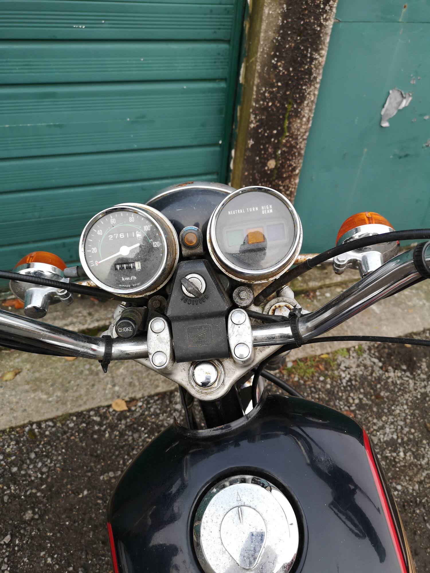

'Was running but revved a bit and wouldn't tick over, now tries to turn over but won't start'.

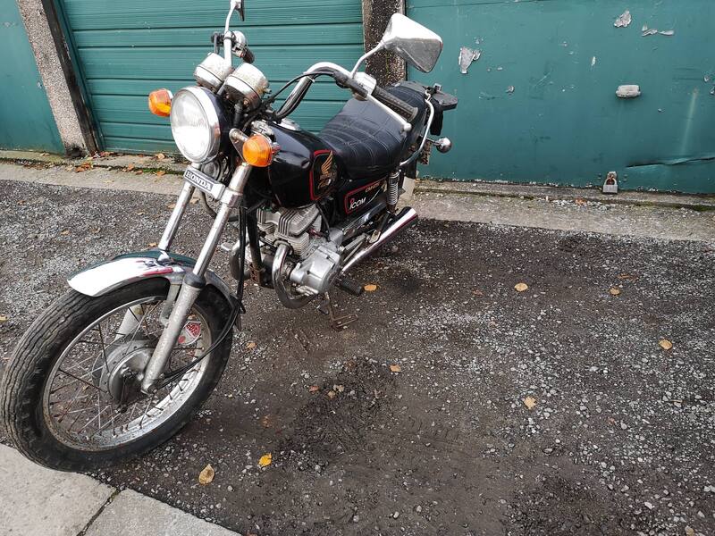

Ooh, a CM125.  Like a CB125T but with (even) less power and the most half-arsed "chopper" styling in the history of motorcycling.  Good effort!

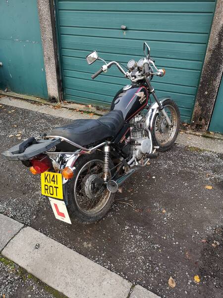

Right, put the battery (flat) on the CM this afters, then tried a jump. It does fire up but like seller said it just revs it's tits off, not good for a cold engine imho. The throttle cable seems to work in that there's resistance and return, but it doesn't really seem to do anything. It'll only start on full choke, won't rev up and doesn't really drop unless you push the choke in a bit. Suspect there's something amiss in the carb, possibly blocked jet but I do wonder if someone stripped it and put something back wrong?
(Didn't run it for long at all)
I'd check the inlet manifold for air leaks, if any of those O-rings look dodgy then a bit of blue Hylomar should do the trick. I'd defo clean the carb while it's off, though, there's so little to them and there's probably all kinds of crap lying in the bottom of the float bowl.
Nice one, thanks will try that. Noticed one (exhaust) manifold nut is missing, but that's not such a big deal at the moment. I'll try and get the carb off tomorrow for a gander, cheers for the suggestion.
No worries, I've had a couple of 4-stroke scooters revving their knackers off from idle and both times it was down to a shagged rubber inlet manifold. I think they're metal on those little Hondas, but it's the same principle if the seals go, or the manifold itself cracks or - as you say - someone's fiddled with it and not put it back properly.

I will *almost guarantee (if it's fitted with a slide not a cv carb) the carb slide is 180 out of whack. Try unscrewing the carb top and rotate, you should feel the slide drop.
On no account replace with Chinese manufacturered replacement carb....its grim

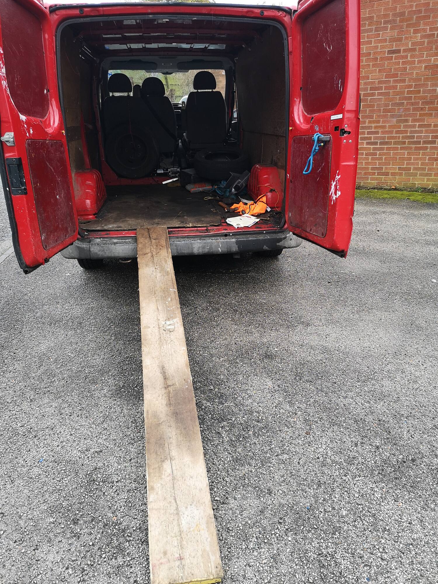

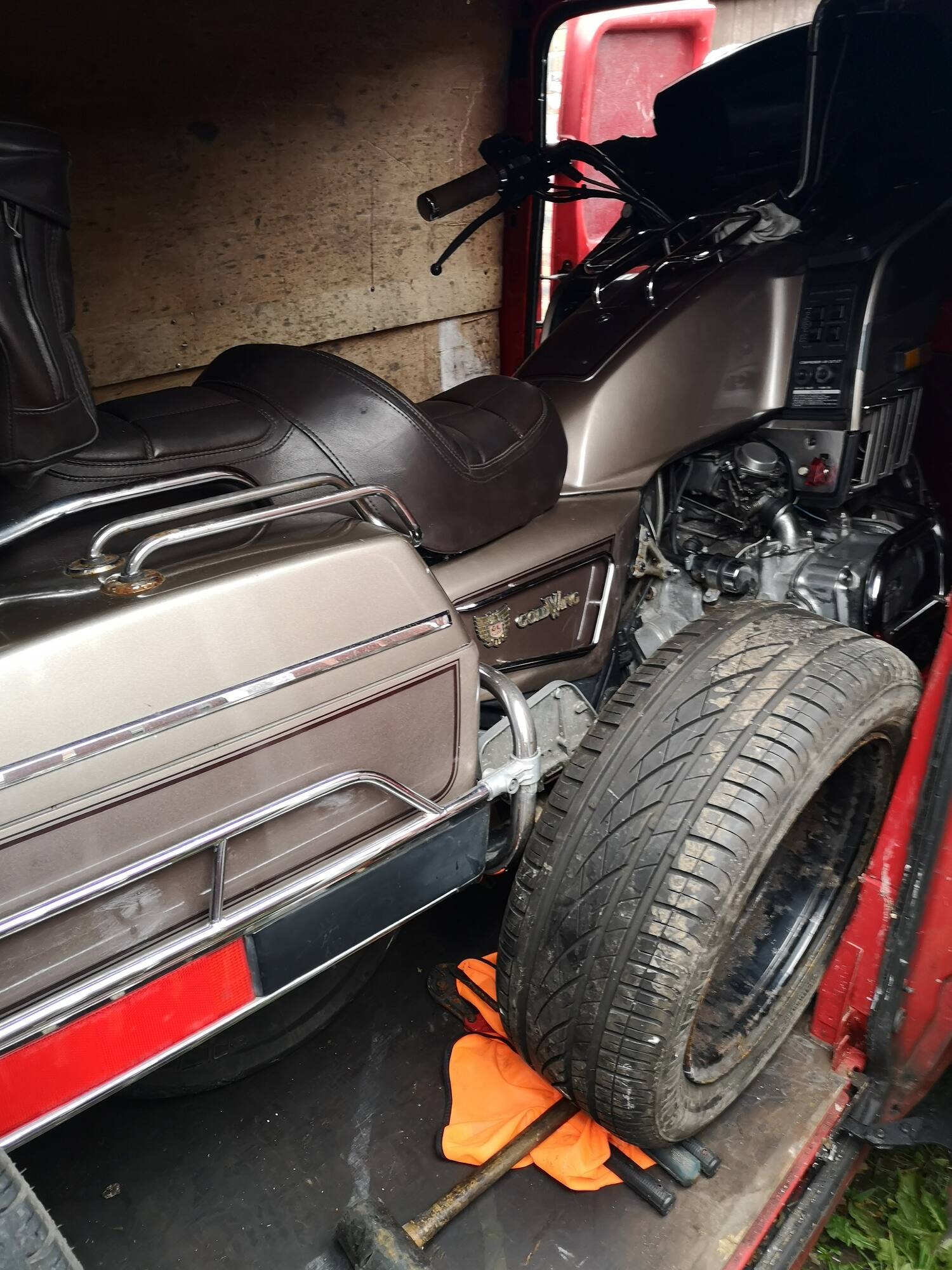

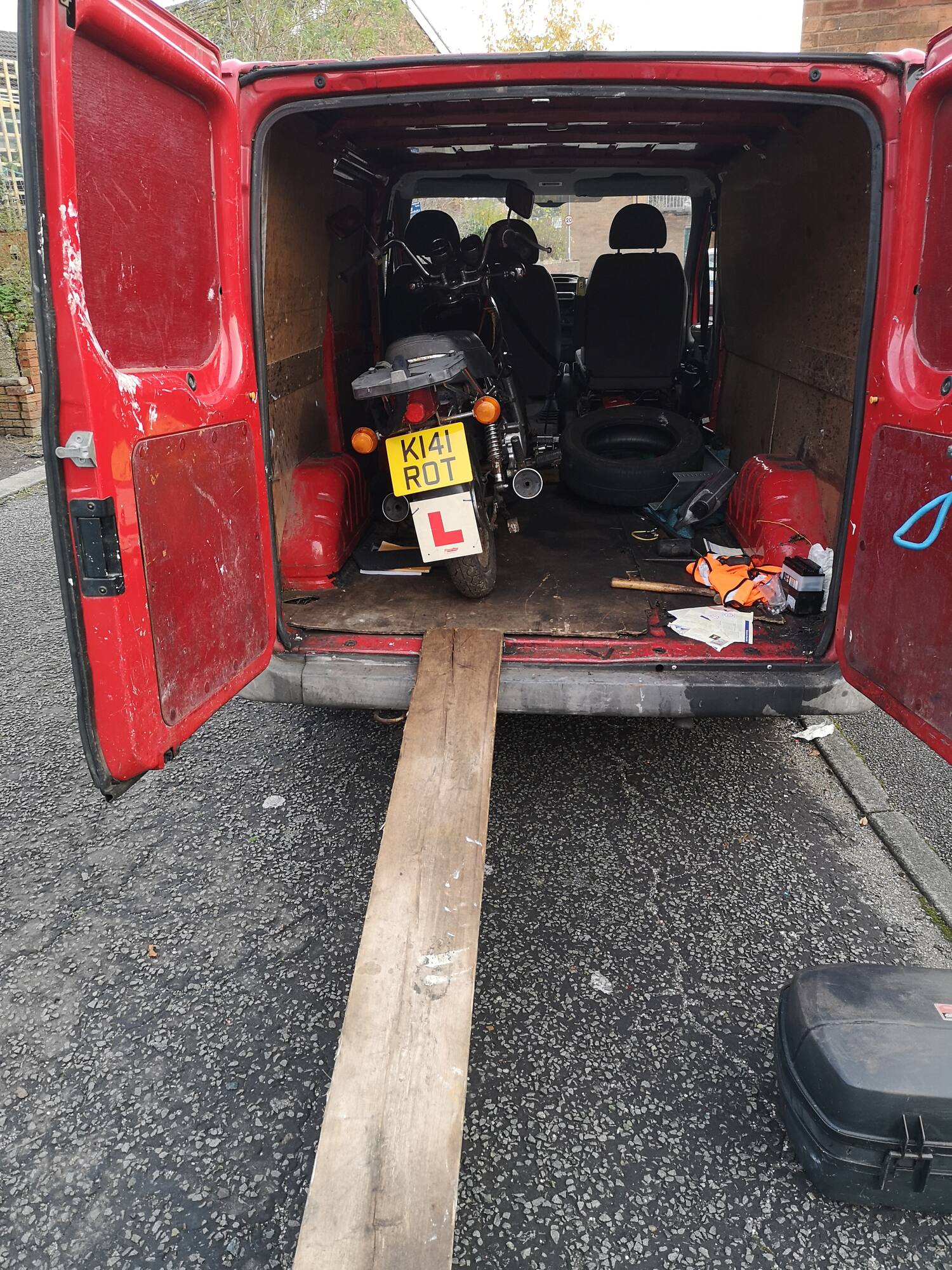

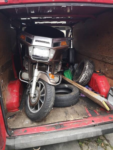

Excelsior news,, used the winch today and it did the job, along with help from my M8 too...
Bit of a job, but could have been much worse. The old ramps (scaff planks) were creaking, groaning and bowing) but in she went. Lord knows where it's going, took my mate home and left it in the van until I can find or make garage space. It doesn't run which complicates things quite a lot.

Thank you. Do I need to remove the carb to do so, or just literally the top and then rotate said top?
Are you Arni ? I’m impressed winch or not to get the battleship in the back of the van ,what’s up with it ?

Just said it's not running but was when he bought it. He reckons it's because the clutch is supposed to be pulled in, then first gear selected before it will start, doesn't sound right at all to me as surely that's adding  a potential hazard, if you slip off clutch lever or whatever. His theory is the clutch needs bleeding, but I'm not at all convinced and it certainly feels like it has bite. There's a starter clutch on these which can give in (according to internet research) but this feels like it's trying to fire up, so if/when I get chance will have a play with the basics.
As impressive as it might appear, the use of the winch, two scaffold planks and a mate got the job done. The winch alone (with one man) probably would have done it, but it was so much easier with two people rather than one. Possibly going to invest in some sort of skid (or have one made) for the front and/or rear wheels to make it easier in future loading heavy non-runners up. Also the winch wire is shit, the lads who fitted it for me said to get some synthetic rope instead, as it stores as well as winds/rewinds better than the standard shit steel wire.
