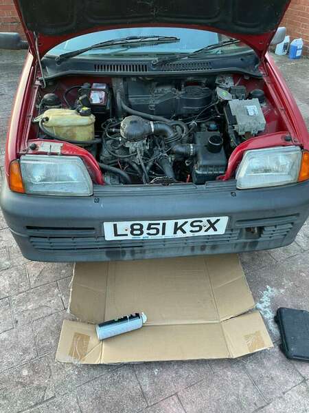

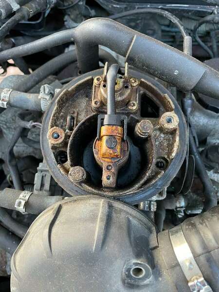

Had five minutes spare last night so had a quick poke around again.
Crusty white thing is crusty.

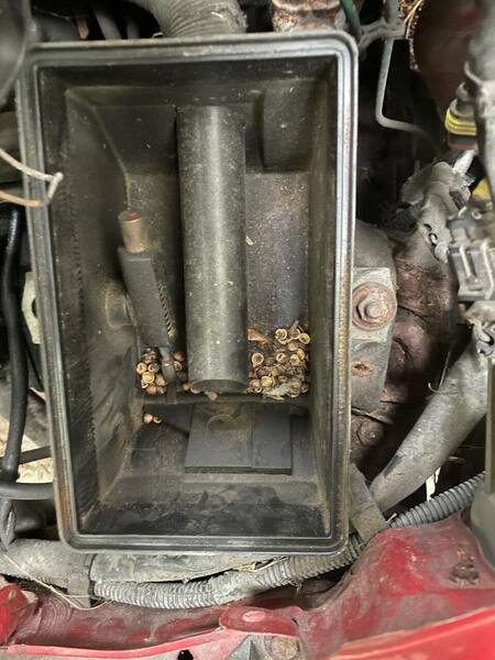

Emergency supplies squirreled away in the air box. Nothing chewed through though.
Random wires removed with the swift tug technique.
Some more blebbage to be noted.
Missing door stay

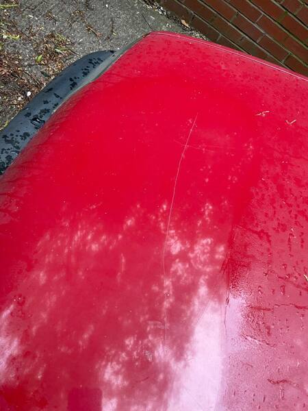

Paint generally a bit flat and a big bonnet scratch.
Gave the bumpers and rubber a once over to make it look slightly more presentable pending more work.

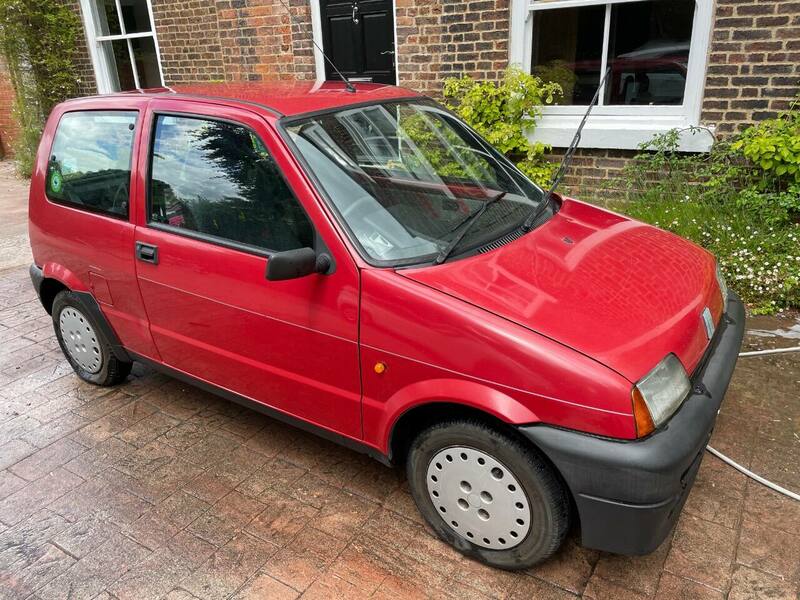

It was parked under willow trees and covered in catkins and crap so I’ve west about cleaning it up while I wait for some of the brake parts to arrive.
Flat fiat
washed
Don’t have a DA so used a £12 drill kit to see what could be salvaged before buying something more substantial.

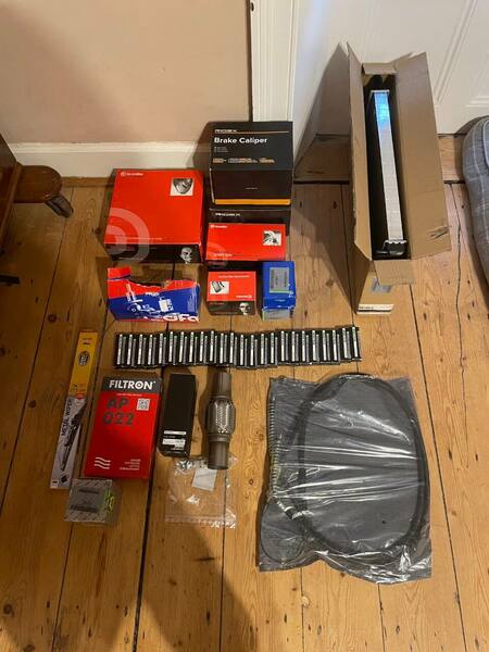

Arriving just in time for the hottest day of ever, two lovely boxes from Autodoc.
The little red thing is going to be getting some tickling done very soon indeed.
Also, does anybody else ever get confused about whether spark plugs come in fours or ones? I absolutely* wanted to order 24 of them just in case.
in order of stuff,
Calipers, discs, pads
Brake master cylinder, rear cylinders, shoes
handbrake cable, flexi
oil, fuel, air filters
New radiator and a wiper
Should keep me in swears for a while!

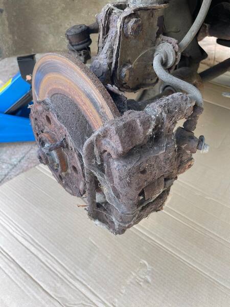

Penultimate day of my two weeks off and I actually carved out some time to start fitting parts to the Cinq.

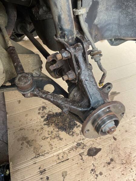

Front brakes were seized on so thought I’d tackle one side to see how it is and I have to say it was an absolute joy to work on, I expected years of farmyard to crust to have welded everything solid but it all came off with the breaker bar and a bit of pressure, no wd40 no plus gas. Brilliant!
Phase 1 - A fair bit of crust but wheel off.
Brakes were rock solid so was a case of dropping the bolts off the caliper and unbolted the disc retainers and took the whole assembly in one go.
I didn’t bother capping the hose when I took off the caliper as the fluid is years old and the brake lines need replacing too so it will need a full refill and bleed before it goes on the road anyway.
Gave the assembly a quick wire brush and it doesn’t look too bad to be fair.
Old brakes a bit worse for wear.

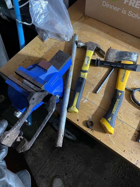

Only bit of faff was hammering a hex key into the carrier to get it off.
The vice in the garage proved handy and spare bit of pipe for leverage got it free.
Put it all back on the car and why don’t all people make brakes this simple to work on?

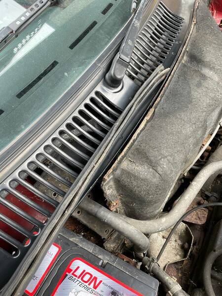

Noticed the battery tray was rotten as a pear and the battery terminal was wet too.
I think it’s the rubber seal that was loose and allowing water in. I took it off and went the length of the trim squishing it with pliers to get it tighter and reseated it and it’s a lot more secure now. Hopefully the tray will dry out and I’ll rust treat it and spray it over.
Also took the opportunity to take off the soundproofing and see where the mice had stashed crap to clear it out.

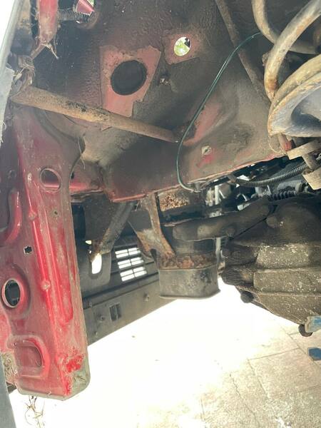

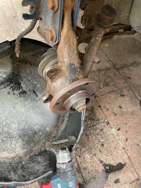

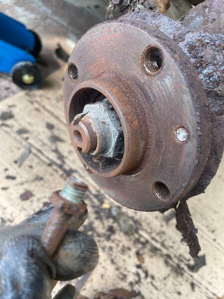

I had a feeling from the sheer effort needed to budge the wheel bolts that this side may not be as friendly as the other…sure enough, this side is a little* past best.

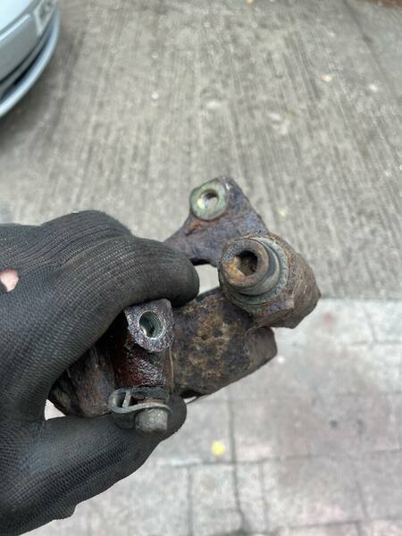

To be fair, the caliper bolts came out easy enough, the same is not the case for the disc locating pins.
Both of them sheared off with the tiniest bit of pressure :(
Regardless, I gave the disc a tap and freed off the caliper from the assembly. I’d say I removed the pads too but technically only one of them was a pad anymore…
Off the the garage with great apprehension to try and get the carrier free…used heat first as I expected a challenge but lo and behold, one attempted turn and the whole thing rounded. Trying to find a carrier from eBay or somewhere now.

Question now is do I lob on the discs without the locators? Or drill / rep them out or just get a new hub.
first option suits me as I’m not up for the hassle of drilling out but I know it makes me a bad man.
Thoughts?
I sem to recall a couple of cars that relied on the wheel bolts to retain the disc. Just cant remember them.

Also took the wire brush to the battery tray now it had dried out.
A few holes appeared and the main element of the tray exited fairly swiftly.
a bit of rust treatment later
And then further professional* masking off for some zinc spray to keep it at bay.
The rust holes will come in handy for using cable ties to secure the plastic battery insert so that I have a secure* battery come MOT.

No joy on eBay for a carrier so I spent a five on a new cold chisel and made a cut in the bolt to try and hammer it into rotation.
Sadly the operation was not a success and things escalated.
Left it cooling down after heat and soaking in wd40…tomorrow I’ll try again!
  • Confused 1
  • Ohdearme changed the title to I want to brake free - Ohdearme’s turn of the century emporium
Have at it you bastard!
kids in bed and round twelve two at the carrier.
More angle grinding to try and persuade movement didn’t work so I used a breaker bar and extreme vice clamping to then bray the shit out of the carrier to break the thread lock/rust until I got some movement and eventually the thing came free.

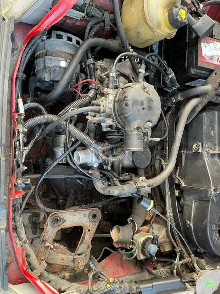

I’ve a new radiator to fit so pulled a few hoses to investigate.
Perhaps a new thermostat may be worthwhile.

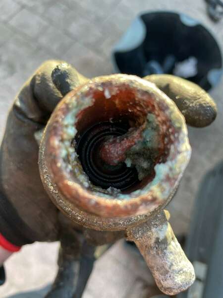

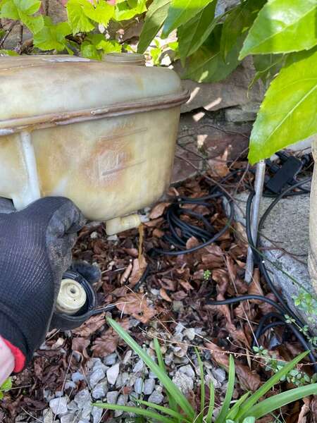

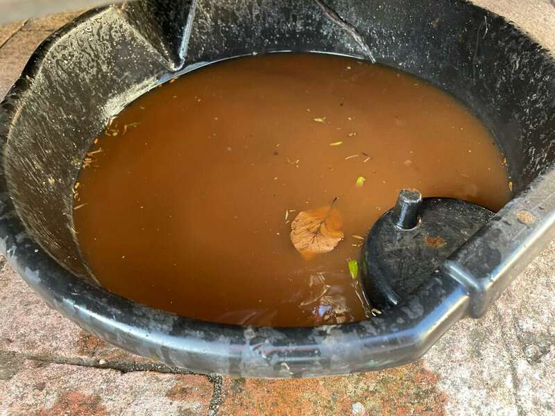

Expansion tank was very cruddy as expected. I’ve seen people use rice and much shaking to clear it out but is quite chambered so I didn’t fancy that.
I opted for a rinse with petrol that cleared a bunch of crap, followed by a rinse of brick mortar acid that dissolved a hell of a lot more of the crap out of it.
For now I’ve refitted and topped  up with some spare antifreeze I had in the garage to flush it round a bit and get the pipes cleaned.
bit better.

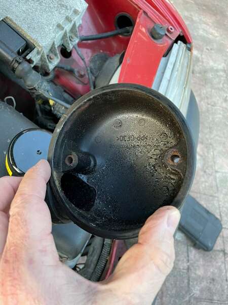

Used a can of brake cleaner I had handy to decrud various engine bits I had handy and see what else is hiding under the grime.
As you can see, it was a high success operation. If you squint you may notice there is a starter motor now visible and that’s about the only difference.😂
injector area a bit on the grimy side so that was squirted out and left to dry.
inpet cap was decarbonised and wiped round too. I should have taken more ‘after’ shots tbh.
It also appears some rodent has overwintered and had a penchant for sycamore seeds…

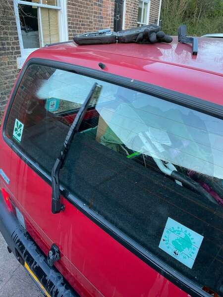

Also got a new rear wiper last week so put that on and tested it.
Sunch unbridled success lead me to try the front wipers and screenwash only to discover the front wipers are dead.

Cleared out the engine bay a bit to clear out the cooling and replace the thermostat.
Erm, nice?
With the stat off, it seemed appropriate to flush the block.
Run one…
Run twelvety
New one slapped on and everything built back up.

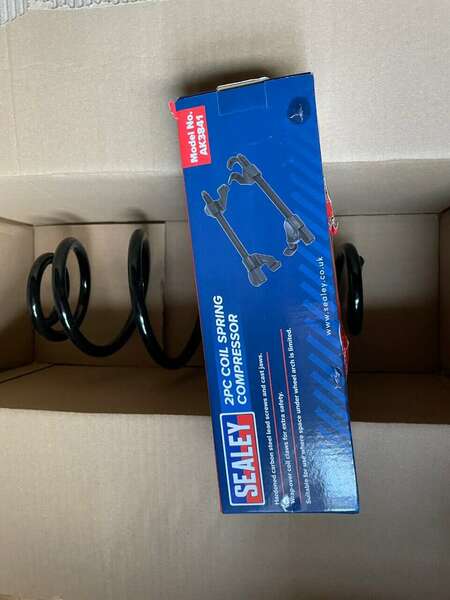

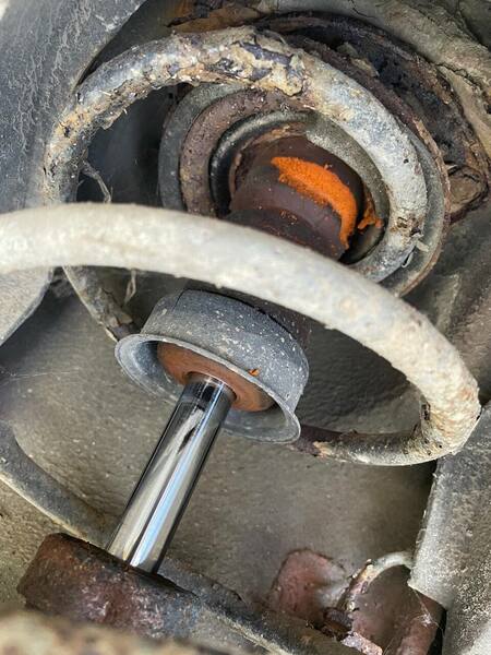

As it is finally dry on the driveway I though I'd investigate the errant metal tinkling sound over bumps coming  from the passenger rear side.
A quick fumble in the cup like a furtive teenager in a girlfriends bra and I revealed this puppy.
Seems a new spring needs to added to the list of recent woes...going to be a good boy and do both for the sake of £100 since I've no idea how long they've been on said vehicle.
T'internet assures me it's an hours work for a diy...provided the rear shock bolts don't shear...and yes, that's me tempting fate right there!
Of course, if I've got one bolt off the shocks, I may as well do those too and add another £150 to the bill.

As the garage declared the left shock bolt stuck that means I can’t do the spring the easy way by taking off the wheel, unbolting the shock and letting the spring drop out.
So for the sake of £15 I’ve got a couple of spring compressors to see if I can shrink the spring small enough to slot in.
if I can, I’ll cut the existing one out with the grinder and drop it in. If not, it’s an Amazon refund of the clamps.
I could also try and do it by dropping the top shock bolt if it doesn’t work but I’ll see how I get on.

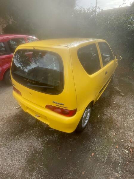

I briefly had a yellow seicento with a leak somewhere and thogguht it’d fixed it, but this was disproven by a major storm and a major footwell puddle.
Moving the vehicle I got a shed lid of water down my neck from the sunroof so it might actually be that leaking, not the windscreen I fixed* with gutter mastic.
anyway it got roffled on New Year’s Day as I was trying to sensible and cut the fleet…
…except…
Literally the day after it was trailered away by @Erebus I logged on to find I’d only gone and won @fairkens bastard Audi convertible 🤣.
It didn’t event warrant a collection Fred given it wasn’t even 30 minutes to pick it up…trip home was longer as the kids insisted on roof down and scenic route home, despite it being freezing but it made them happy.
