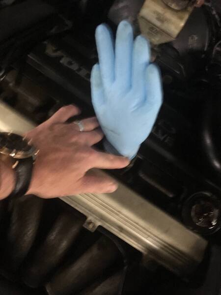

But then I had another thought as the oil was all over and I had gloves handy, thought I'd just check the PCV and see if there was a vacuum or not.
Inflated glove suggest there is no vacuum and the PCV is clogged up somewhere.

Seeing the Glove-o-Matic pressurisation facility, make sure your garage cleans or replaces all the pipework for the system. From memory this may involve removing a manifold or two as a bundel of it is hidden undernearth. It's not the quickest nor cheapest of jobs if you pay someone else to do it, but it will make all the difference and won't need doing again for a long time.
Ah, the glove test of truth.
Words cannot express the relief when mine checked out ok on the current £350 V70 shed, the vacuum was actually so vicious I almost lost the glove (That would have been entertaining) I'm pinning my hopes on regular 5k oil changes and good synthetic keeping things that way, but tbh experiencing pcv/breather woes seems to just be one of the fundamental laws of Ovlov ownership. Annoyingly on the older 'red block' engines sorting the breather system is a half hour job, I haven't had to go there yet on newer 'white block' ones but it looks like hours of manifold off fun. Progress eh?

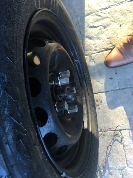

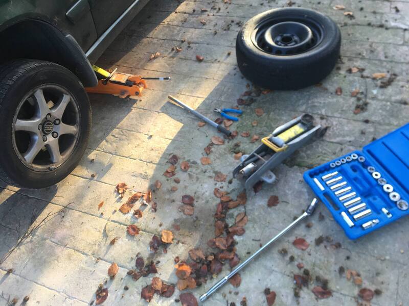

Got up this morning to a frosty windscreen and going round the passenger side to chuck briefcase in car, I spotted the spare wheel laid there on the drive where I’d forgotten to change it yesterday.
As much as I didn’t want to be changing the wheel in my suit and brogues, 3 degrees and chilly versus 17mm tread is pushing sense so I knuckled down to swap it.
Yep, that’s right kids, two trolley jacks as the first one decided to not lift (quick fix as the pin has dropped out but not when I’m late and my fingers are frozen).

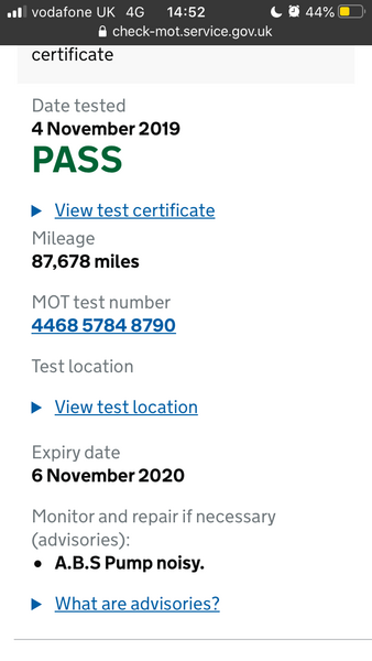

I find nothing gives confidence to a tester that he is MOTing a cherished motor than the words “I’ve parked it outside, but I’ve disconnected the battery as the car’s making funny noises”.
Got up this morning to run the Mazda round the corner, jumped in, turned key, nothing. Battery dead :(
Needing to get to the MOT station early, I whipped the battery off the Volvo and shoehorned it into the 323 bay (a tight fit) to be greeted with a pumping/mechanical pulse-y noise the second I connected the terminals.
No warning lights on the dash, I’ve cycled all the usual suspects like wiper motors and stuff, I think it might be the abs pump ?
Wife was oblivious to my exploits until I told her I’d had an issue this morning....”Oh, it was making a funny noise last week like that but went away so I didn’t mention it”
Lets see what it takes to get a ticket and then decide what to do with the little blighter.

Garage has a quick fiddle with the pump but it keeps coming on so he's got his auto electrician out tomorrow to do some tracing and hopefully just find a shagged relay or crusty connection.
Once that's figured out and costed up, they're going to pop the spare on and get it a ticket.
Then I'll get another pair of cross climates from Costco for the front and hand it back to Mrs ODM for a year.
Auto electrical man has said wiring is all fine so main suspect is a duff abs unit itself, ordered what I think is the right one via eBay roulette for £50.
