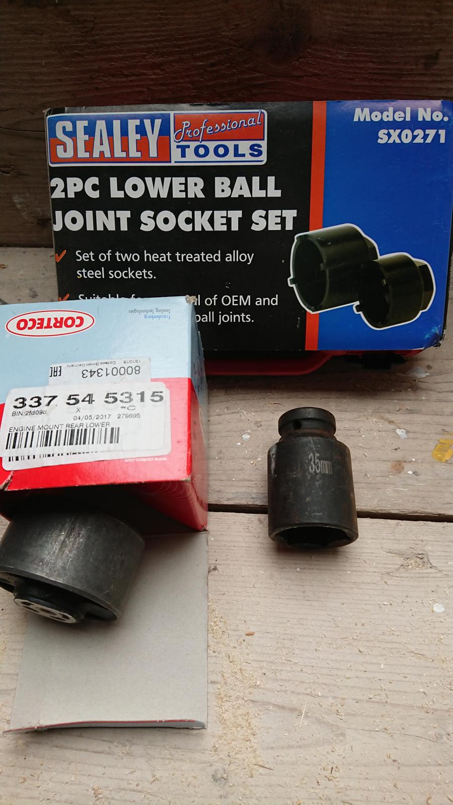

I’ve got a ball joint spanner kit for one of these somewhere.
Will have a look tomorrow.
Ps. They’re a right cunt to get out. Consider paying a man.
Expansion...
They screw into the base of the strut. Mine were seized solid.
You can tighten the tool onto the joint so it won’t slip, but you’ve then got to unwind it, and it’s twisting against the strut, which is wobbling around getting fucked, and you are upside down , working upwards on a low bit. Needs a ramp really.
I really struggled (had a pit , but no impact gun), which resulted in the struts rattling like buggery afterwards. As you’re doing the strut tops as well I’d research if it might be easier to remove the strut and do it on a bench somewhere.

Socket for drive shaft if you do need to drop the strut out.
Bonus random engine mount that may as well live in your shed not mine.
Ta da.

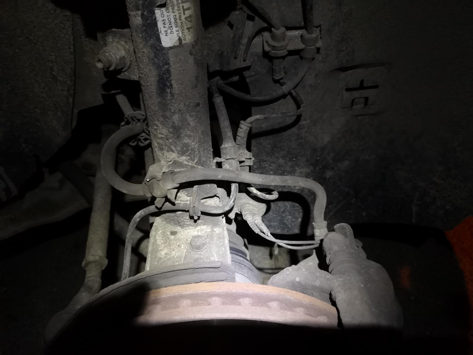

HOWEVER, after a peek behind the drivers wheel this morning, I noticed something I didn't like, so just now, when amy put the kids to bed, I went out
Wheel off, and look, a twisted brake pipe
No idea how the fuck it's done that, so I unclipped it and moved the twist to the straight bit behind the shock where it can sit safely
I went around all 4 corners, checking for anything blatent, loose abs rings etc and found nothing. Gave each sensor a good squirt of brake cleaner for good measure.

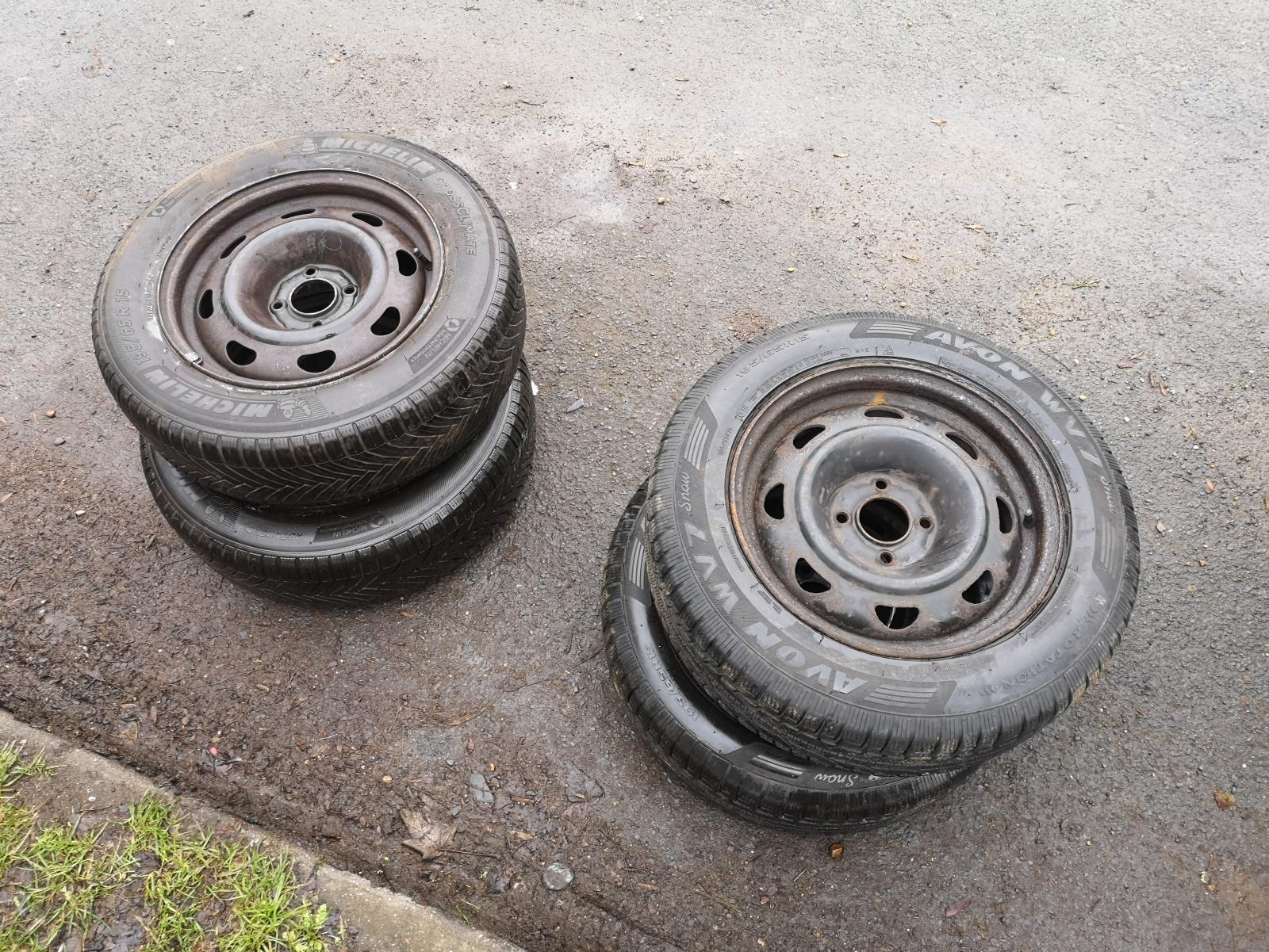

I've got the day off today as Amy has training at work this afternoon, and handily, I have a boot full of wheels thanks to Mr Moog and Mr NJLeeds!
Wasn't too sure of the racing slicks look, until I unwrapped them and found the actual wheels!
They have tread, I feel spoilt
15 minutes later I had them all swapped round, then put the best one that was on the car in the boot as the spare it had was very perished, with a deep crack running the whole circumference of the tyre!

Hopefully you will enjoy the wheels.  Which went on the front?
Looking at your pics I assume you dont need any wheel trims? Got 4 sitting here
I put the winters on the front. Of course now it won't get below 15 degrees for the rest of the year!
Its trims are ruined tbh, and I did think about not refitting them as it looks a bit mean without, save them for if Lord Sterling or another of the wheel trim fondlers need them!
I got up to 70* on the bypass too and their balanced fine, so put the 4 old wheels on facebook for free to save me a trip to the tip and paperwork, or asm and paperwork and hopefully their being collected on saturday
