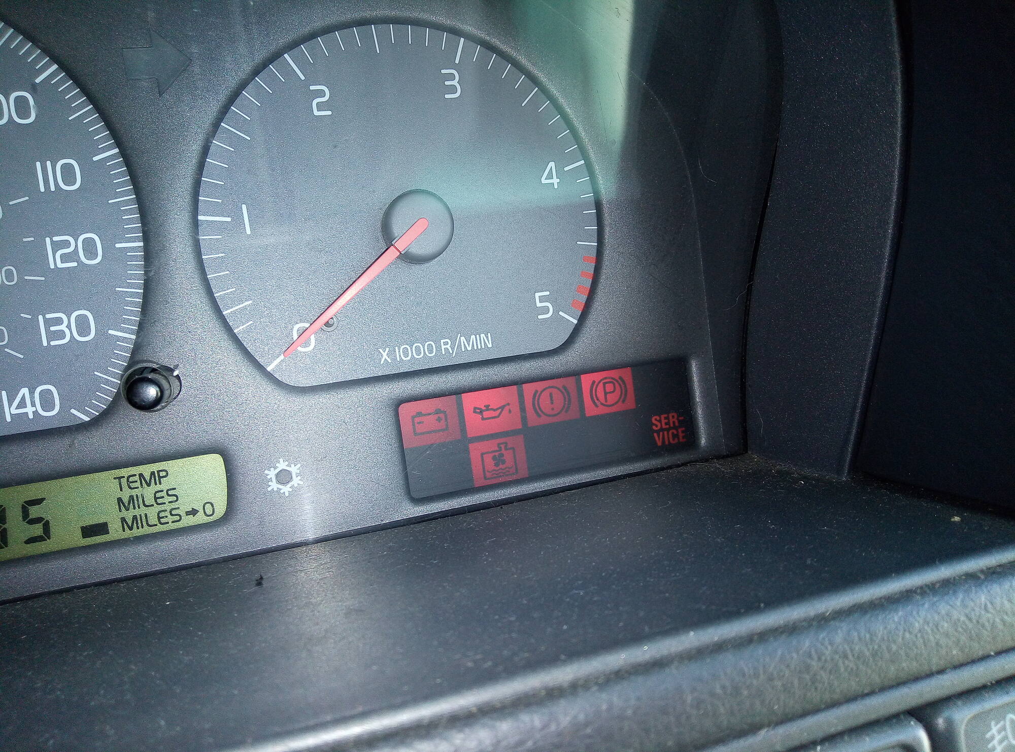

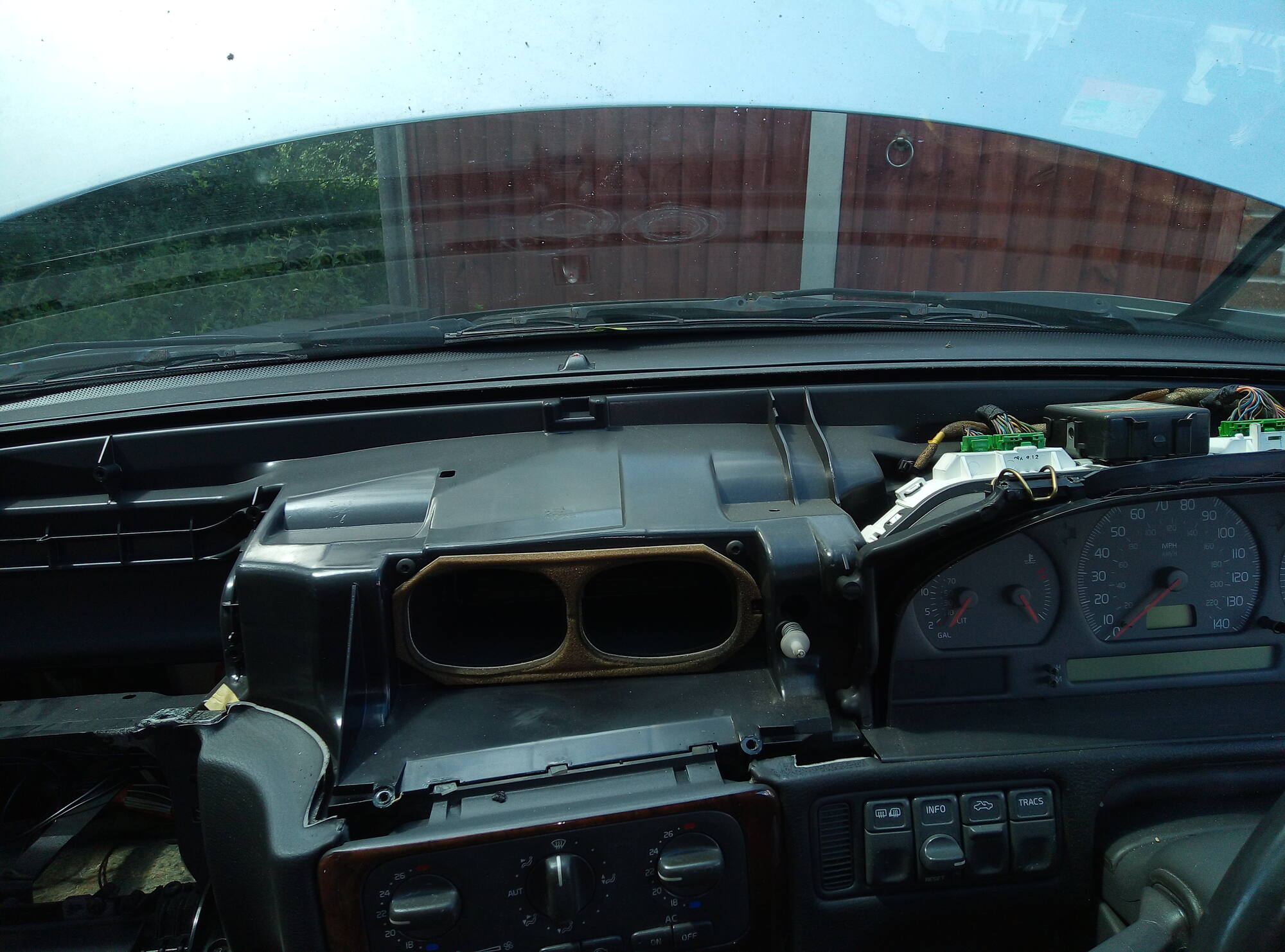

IMG_20200726_130519.thumb.jpg.aad4ab89b84e0ede8cefe4cda8bb2db7.jpgIMG_20200726_132854.thumb.jpg.fd31db2baac00d1d16cb86d6e761bdfe.jpg
That was nice and easy. No lambda light anymore. I appreciate this is masking a problem not solving it and it may still fail on emissions but we will see. Online info seems to suggest its most likely an electrical gremlin. Time will tell if they are correct.
