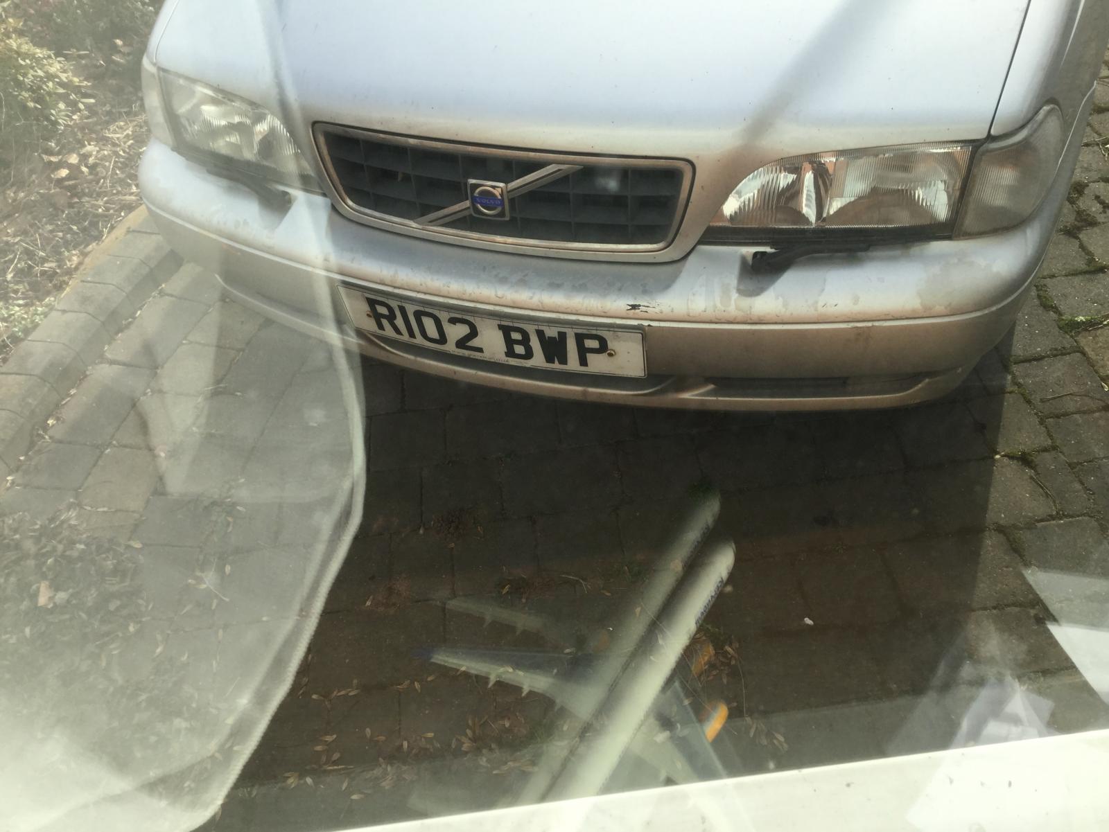

Finally found a bumper, picking it up Wednesday with any luck. Paint is one thing I am shit at, how much would a very average back street sprayer charge to spray a bumper to around the same colour as a car? It’s silver which I know isn’t the easiest to match.
Circa £100 a panel IME.
That isn’t horrendous, would be nice to have the front looking a bit smarter, it’s the only bit that’s really scruffy.

I am heading off for a replacement in a few minutes, also hoping to pick up a few other bits of use.
It might be the light or the window but that looks decent to me. Dirty maybe but doesn't even look too much of a different shade. Good luck with the collectineering man. It's lucky you happen to have a cool massive estate to pick the new one up in.
It’s peeling terribly and the undercoat is coming through in many places, a picture can tell a thousand lies (as I found out) and that one does, including the plane about to fly into it :-) New one is nearly as rough but a quick spray when the 1000 other jobs are done, or finding someone who do it for sensible money and it will make look a bit cleaner.

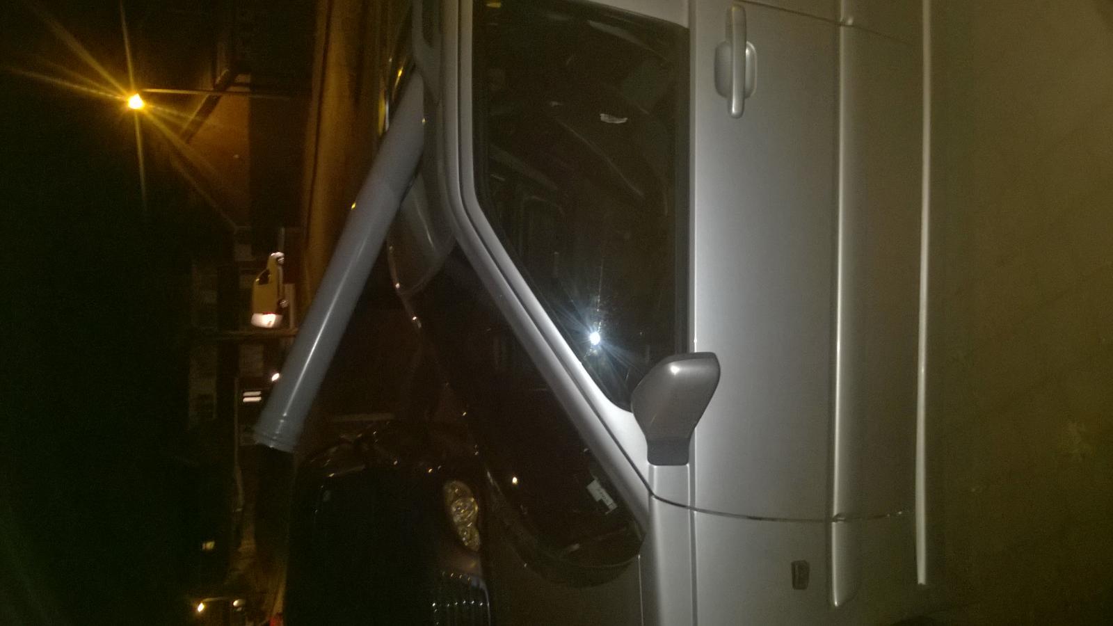

Soooooooo I needed to collect a 3m length of waste pipe. Now 3m lengths do fit inside a v70 but who hasn’t dreamed of being a tank commander! So open up the sunroof, insert said pipe, drive home getting weird looks all the way.

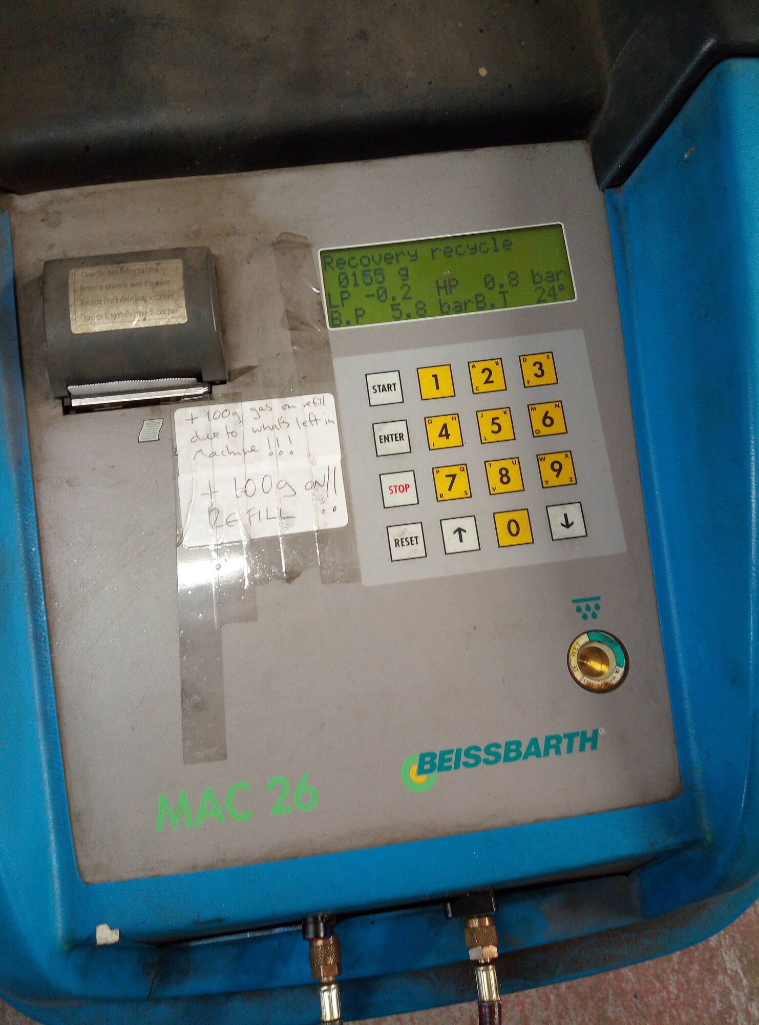

Off to Tommotech’s this evening to look at the air con which has gone a bit warm recently, and to pick up a set of new (to the car anyway) wheels. Typically it’s peeing it down at the mo. Luckily TT has a very nice workshop.
IMG_20190828_184630.thumb.jpg.0e504b8d208814d86f3ca07a614ddad7.jpgIMG_20190828_191648.thumb.jpg.a9b55fcbeaff2a3237eb5f22c25f047f.jpg

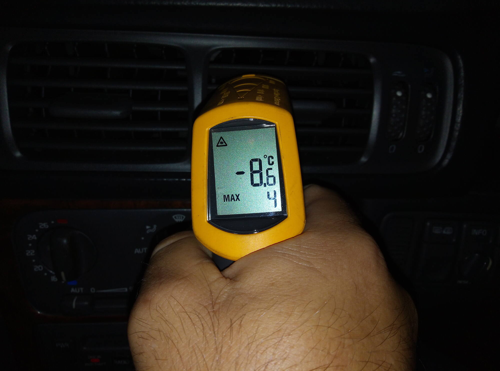

Tommotech’s superb kit paid off (again), as someone who has never dabbled with AC before it was interesting to see how it all worked. Pleased to say that a decent amount came out (350g by the end) and it passed the vacuum test with flying colours. As TTs thermometer shows it is proper frosty now.
