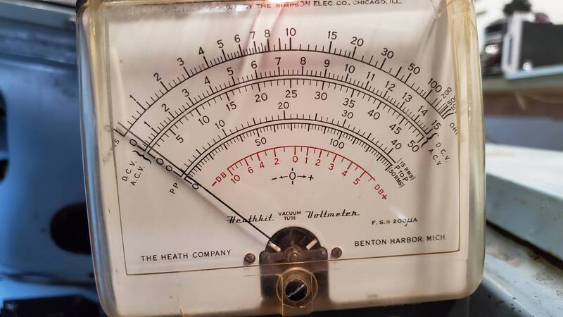

PhilA Posted October 18, 2019 Author Posted October 18, 2019 This afternoon I set about looking at the ignition system. I checked none of the spark wires were high resistance or open circuit. They all came back good. For giggles, with everything plugged in right I decided to see if adjusting the timing would help. That'll be a yes then New distributor cap time Phil Skizzer, scdan4, Joey spud and 3 others 6
