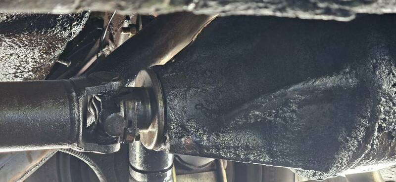

PhilA Posted October 15, 2023 Author Posted October 15, 2023 Today while an eclipse occurred, I took my driveline apart. I replaced the diff pinion oil seal. Now, dirty but dry. It has a pending date with the pressure washer. Tickman, RayMK, Saabnut and 5 others 8

PhilA Posted October 15, 2023 Author Posted October 15, 2023 Cleaned up underneath a bit. Need to wipe that all down and put some paint on. Coprolalia, mercedade, Dyslexic Viking and 1 other 4
PhilA Posted October 16, 2023 Author Posted October 16, 2023 There, that's a little better. Will be able to see better if it's leaking now. GrumpiusMaximus, RayMK, Tickman and 3 others 6

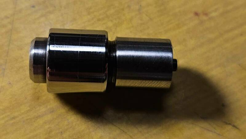

PhilA Posted December 4, 2023 Author Posted December 4, 2023 For reasons beyond my control, I ended up in town today and braved Christmas traffic. That was potentially a good thing because the gearbox did something weird it's never done before, which shed light on the fault of the 1-3.......4 shift thing it does when it gets hot. The drive home was pleasant. The car was running perfectly. Quiet, smooth, luxury. That gave me chance to think so when I got home I broke out the gearbox service manual, then went take apart the spare valve block. Turns out the 1-2 throttle valve appears to be a bit of a kludge and as such has a bit of bad engineering occuring. A sharp 90 degree edge was machined on the edge of the idle drain plug, which should be sitting in a bore with a port, but instead sits between two sections of the casting with holes drilled in. As the spring that pushes against heats up it seems to compress in an arc rather than straight down, applying a small radial force to the plug, pushing it off center because it's worn (we're talking maybe a thousandth of an inch) and causes it to jam solid halfway down it's travel, which blocks the 1-2 shuttle valve from moving fully. So, I machined a chamfer to overcome their faux pas. Applying a side load to that now isn't a problem, it self centers and moves properly. If circumstances allow I'll fit it tomorrow. Phil mk2_craig, Coprolalia, groovylee and 18 others 21

PhilA Posted December 4, 2023 Author Posted December 4, 2023 Swapped valve blocks. Back on the original with the revised piston. So far, it works. But I'll have to see how it behaves once it's hot in traffic. Dyslexic Viking, mk2_craig, RayMK and 3 others 6
PhilA Posted December 4, 2023 Author Posted December 4, 2023 It's a car, it gets driven wherever. Took it for a drive and got it warm. Result, under very light throttle it still hangs up, but under moderate (average away from the lights) acceleration it changes perfectly. I think that chamfer needs to be reprofiled to be a gentler curve rather than a 45°, polished. It should then slip in easily with the miniscule forces it would appear are present at light throttle. Phil LightBulbFun, mercedade, Zelandeth and 6 others 9
