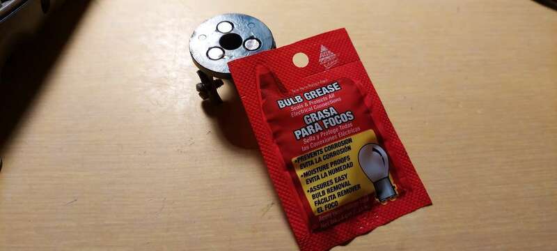

PhilA Posted October 28, 2022 Author Posted October 28, 2022 Plenty of driving lately. Gearbox had resumed being an ass so I'm waiting on a replacement valve block. However, I've been chasing an intermittent misfire for a while. Know it's ignition related because the tach would jump about. Twisting the ignition key yesterday I noticed the lights would flicker. Pulled the switch apart. All burned and dirty inside. Cleaned that all up, polished. Added some dielectric grease and reassembled it all. Now, no matter where the switch is on its arc, the volt meter stays stable. Hopefully that'll help. Phil mk2_craig, Fumbler, LightBulbFun and 5 others 8

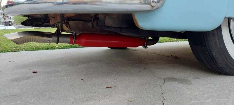

PhilA Posted November 7, 2022 Author Posted November 7, 2022 Been doing a bunch of miles in the Chieftain recently, quite a lot of which are at highway speeds. At 52, everything's quiet but 55 the exhaust has a very loud drone. Nobody wants to travel at 52 so I went out and bought another muffler. Same as the front, AutoZone's $27 glasspack. Significant difference now. Around town it has a nice bass note but on the highway the loudest thing now is the gearbox. For the size of it, you'd expect zero difference but I'm surprised at how much of a change it's made. Phil JMotor, Dan_ZTT, RayMK and 8 others 11
hairnet Posted November 7, 2022 Posted November 7, 2022 so the next experiment therell be a skyline missing a 4" drainpipe definate rumble then PhilA 1

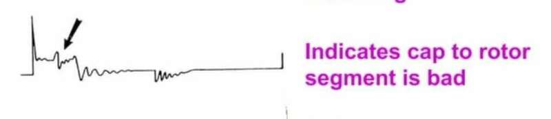

PhilA Posted November 14, 2022 Author Posted November 14, 2022 The car started running like a turd today, bucking and cutting out, popping and snapping. Tonight, out came the scope. Started looking at traces from the CB side of the coil. That one above is mostly ok, a nice discharge curve but shows a little high resistance on the plug/wire. This one however isn't clean and is indicating a problem: Yup, like I thought, distributor cap is failing. New cap time. GrumpiusMaximus, AnnoyingPentium, Asimo and 4 others 7

PhilA Posted November 17, 2022 Author Posted November 17, 2022 New cap, rotor and plugs. Much better. So smooth now all you can hear is the creaks, rattles and squeaks. bigstraight6, BlankFrank, Jenson Velcro and 9 others 12
