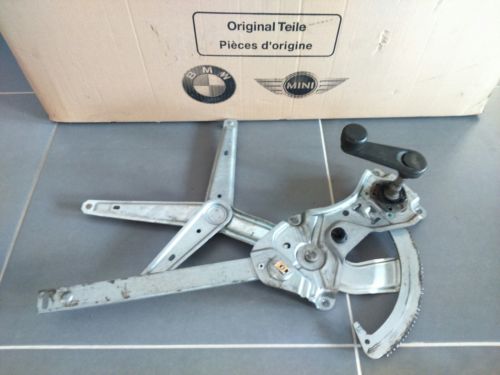

Pre 1993 cars had the relay built into the drivers door motor - later ones used a body control module. I expect the big relay has failed, as they used to. I may* have one in the E36 stash. In the meantime I seem to recall you could remove the relay (six Torx) and put 12v and earth to the two exposed terminals on the motor.

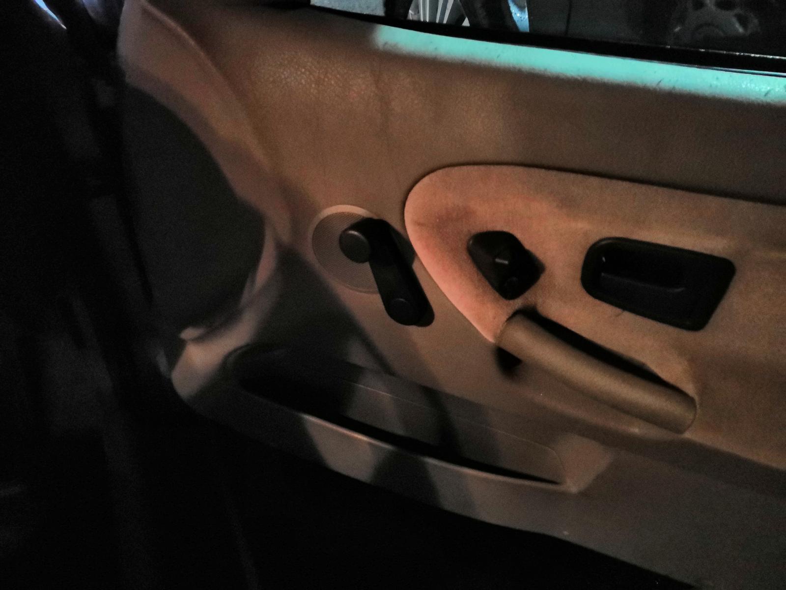

Thanks for this fella. I did just that. The relay looks mint inside, zero tracking on pcb etc. but yet still it doesn'y fecking work. Tried applying 12v & neg' to motor terminals and still nowt! Pissed at this, I removed the motor housing and resorted to turrning the motor by hand so we could get the window reset in its track and properly closed. After a bit of hunting around on evilbay - mum! dad's been on ebay again! - I've found and bought the hens tooth that is an, OSF manual window regulator and winder handle. #SuperLigera BMW-BRUV! That'll show it who's boss! :shock:

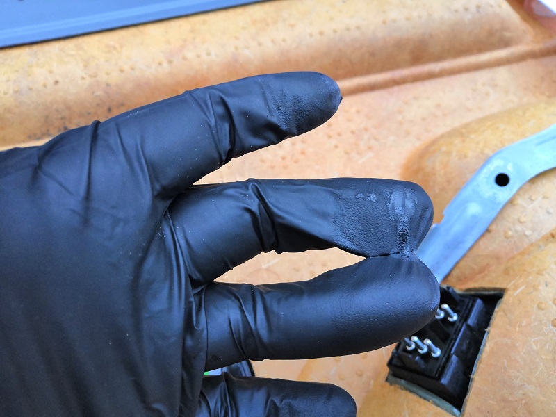

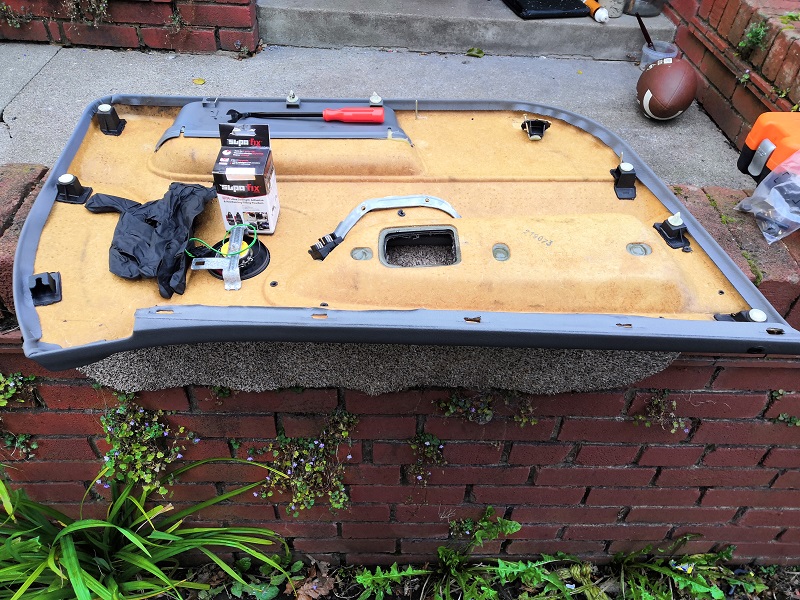

Also set about removing 2" wood screws used by someone unknown to replace broken door trim clips, wood screws now removed and saved for future use & replaced with proper clips and while I was there, filled in the big dirty screw holes left by using yon Supafix stuff. Mega super glue which comes with filling powders. Impressive stuff but gloves are essential and although I used the grey filling powder, it looks a bit more brown Autoshite beige in this case.

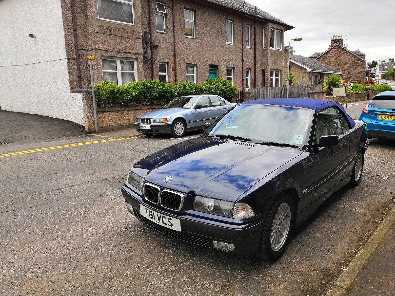

This shiny 325i also parked up across the road the other day. Thing of lovelyness. #Swoon.... Although really badly parked :shock: they walked to the kerb from there, I guess...

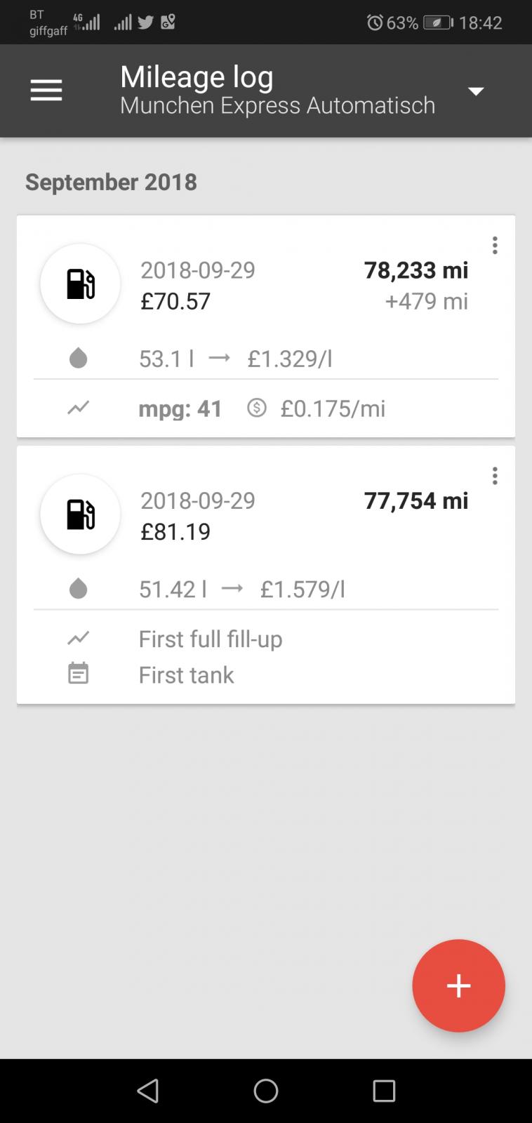

41mpg.none too shabby. Manual winder is replacement for kaput drivers side leccy yin. Cheers all.
