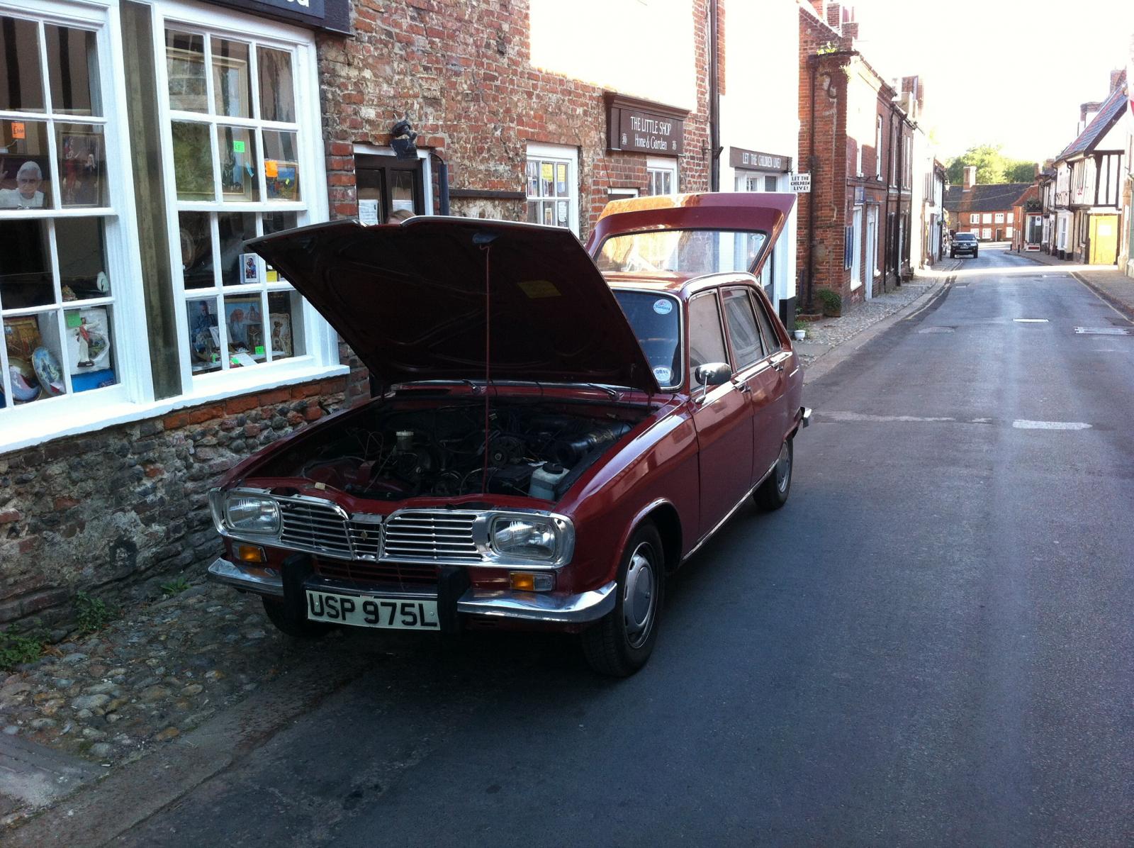

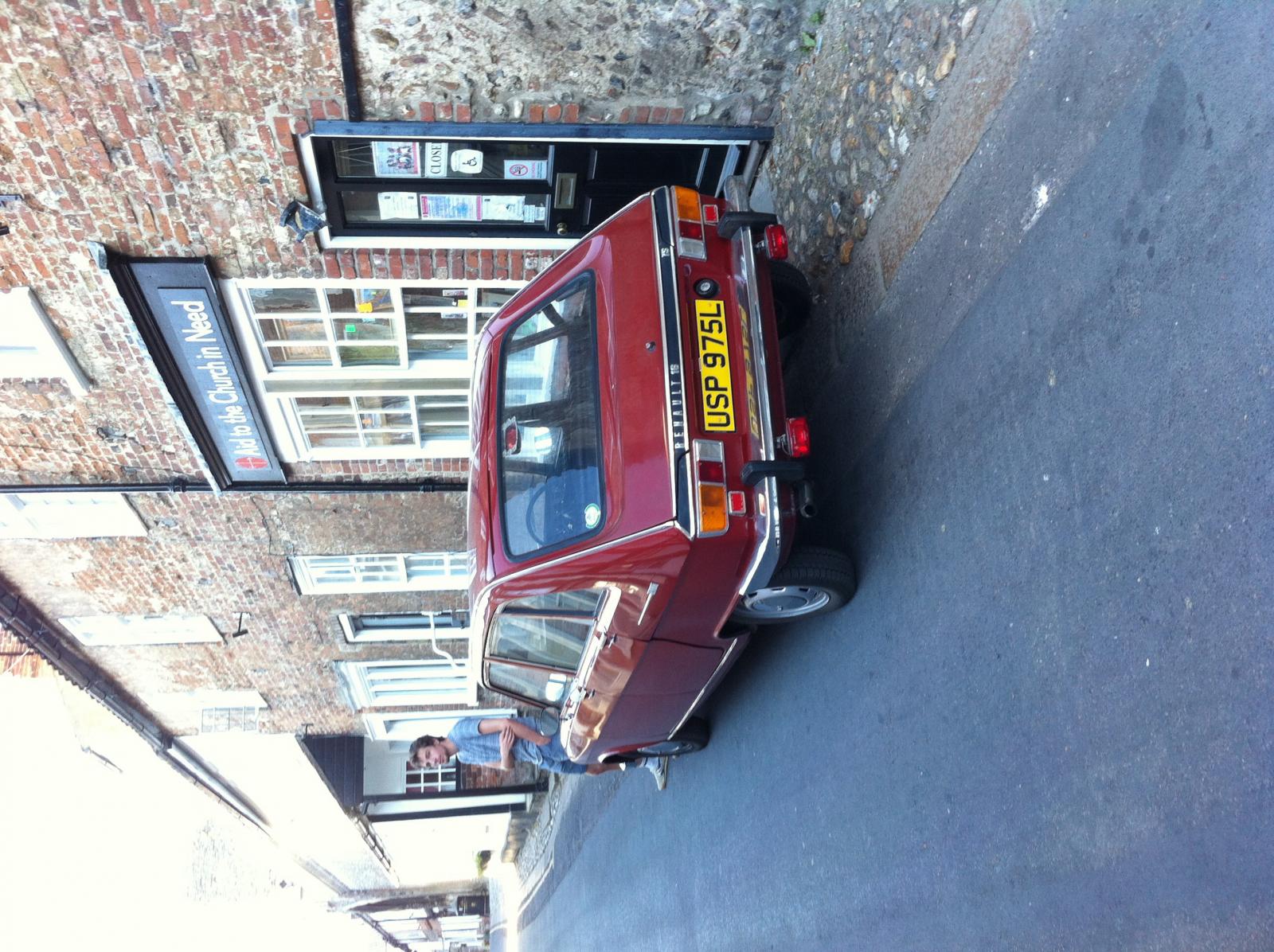

My mate Ed, his brother and I are broken down in the HOT PIECE OF STUFF that is Ed's R16. The car was making a knocking noise under acceleration which has got steadily worse. Metallic noise, possibly driveshaft but he's got no tools!
AA eta an hour, just wondered if there was anyone local who could come and help?
We're in Little Walsingham High street. My phone no is ohseveneightthreesix270211. Thanks!

If it’s any consolation, that picture must be an absolute shoo-in for next year’s calendar.

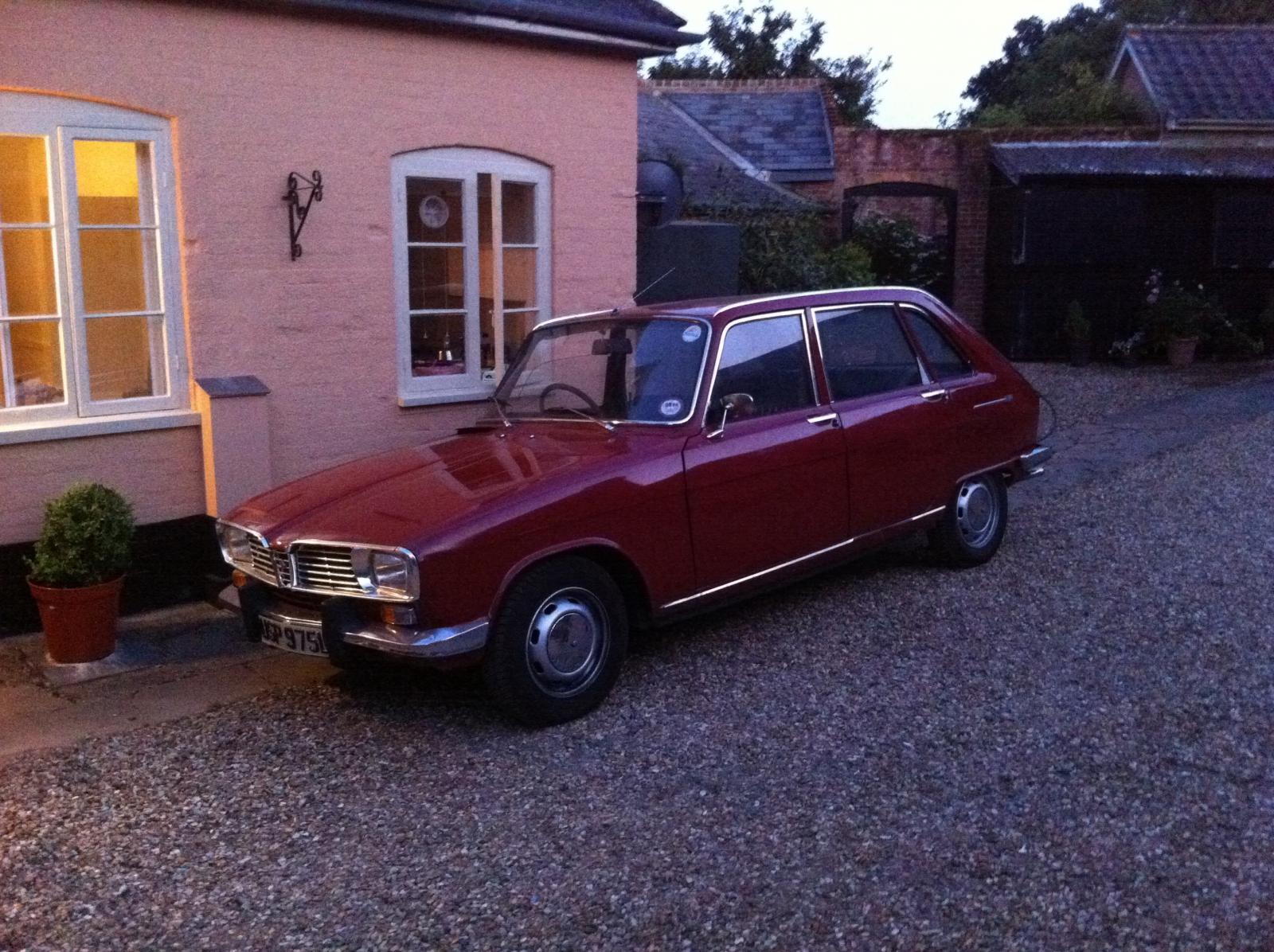

The recovery guy reckoned it was the nearside CV joint, the gaiter was twisted and when he took it off there was very little grease inside. He repacked it with grease and it seemed spot on (but stressed it was only a temporary fix, due to the grease only being normal and not CV grease, plus potential wear to the joint already). I've just driven it about 50 miles to my house in Suffolk, upon which I've checked the gaiter and it doesn't appear to have lost any more, so Ed and his brother have just left on their way back to Oxfordshire, armed with a tin of grease, some cable toes and rubber gloves!
Never experienced a CV joint clicking on anything other than full lock, this was properly clanging and going in a straight line too. It seems spot on now, what a lovely car to drive too.
In all fairness, this is only the second long journey it's done since 1994. It's done bloody well to be honest (but has only done 39k from new)
