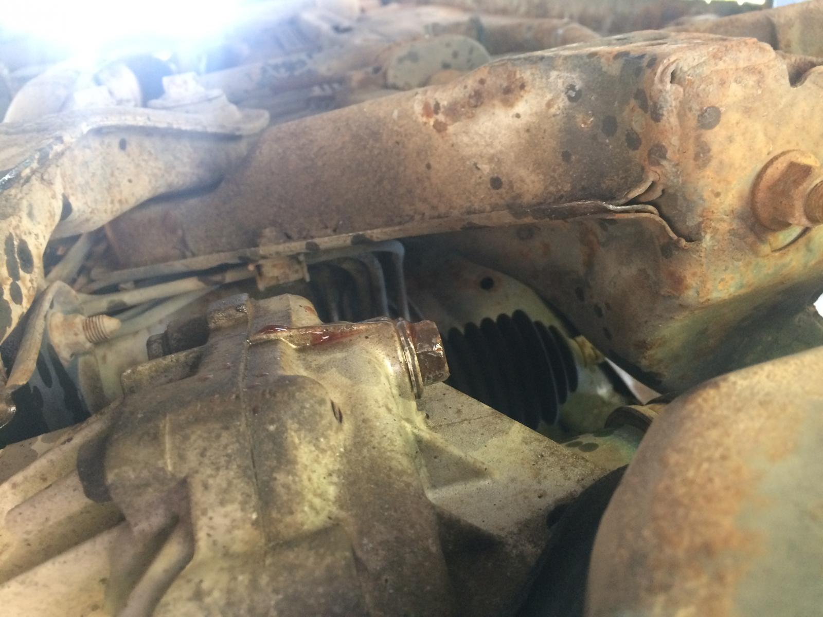

Gearbox Fluid Drained....

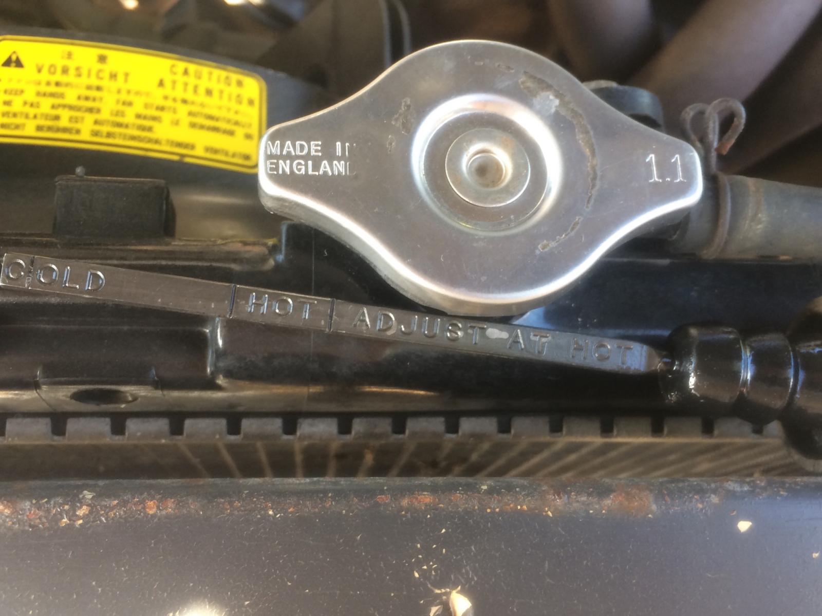

Gearbox oil was drained out in under 10 mins - it turns out there is a dipstick on the gearbox hidden right out of sight that I missed up until now. Checked the level and massively overfilled....it was halfway up the ‘adjust at hot’ section of the dipstick and am guessing like reading your engine oil on your dipstick it wants to be halfway up the ‘hot’ section of the dipstick when hot...? Can anyone confirm just so I know I am doing it right...?? Sounds like a dumb question I know but just want to make sure I am not missing something blatantly obvious!

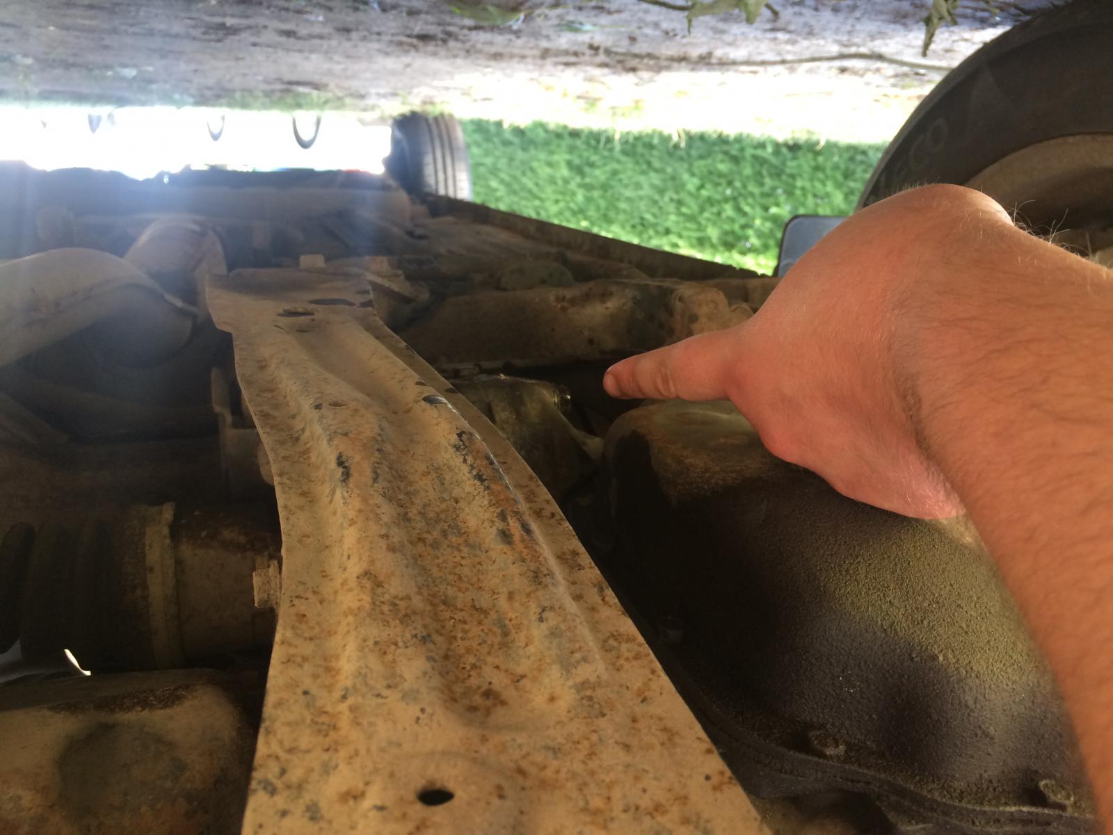

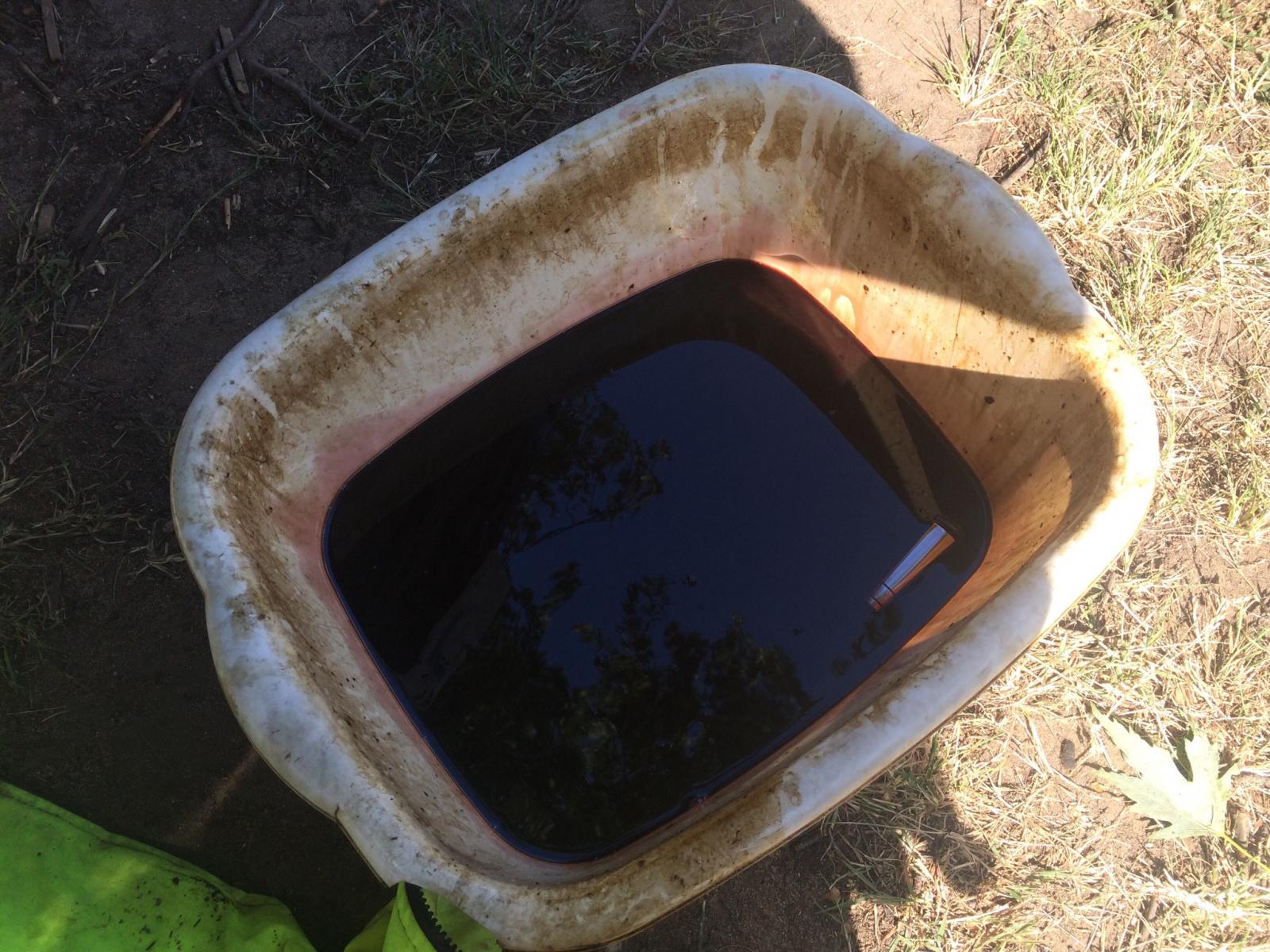

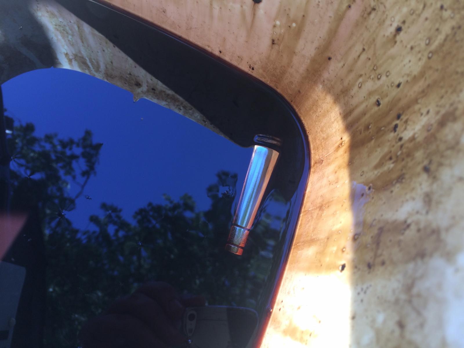

Cracked the drain plug off....out it came all over my hand and I only went and dropped the socket attached to the drain plug in the bowl didn’t I....!!!!
Upon looking at the fluid on my hand I sighed and thought I didn’t need to do this and have just cost myself x amount in new fluid as on my hand it still looked quite red...but how looks can be deceiving....
Anyway, she is empty right now and first thing in the morning I am down to Euros to pickup some more atf fluid (traffic too heavy to go now and what should be a 10 min journey will take me over an hour)
I will just refill through the dipstick anyhow....
Oh and at nearly 120k miles is it safe to say we can all pretty much agree that this has never been done before?...
Ahh rats my couple of my pictures are upside down!
Job done - managed to find some atf I already had (had some bottles of genuine Merc ATF in the garage) so that was made done....cut a piece of garden hose off and poured the fluid down that and into the dipstick tube.... Sorted!
Took for a drive and 100 times better! No slight revving up between gears, smoother gear changes and much more responsive kickdown
Very pleased :) Another job done

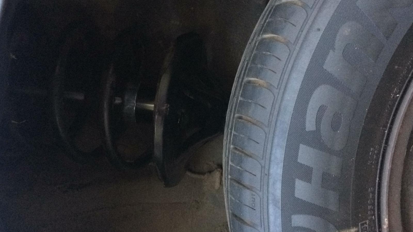

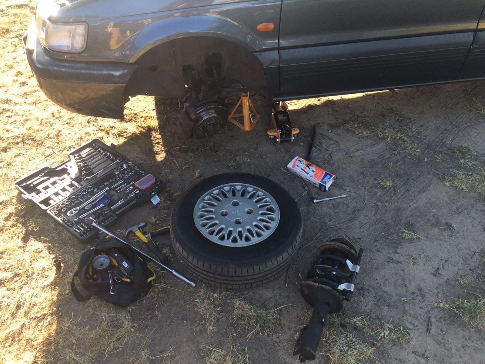

So after having waited over two weeks for a replacement shock absorber for the front passenger side to arrive from Germany (yes it appears that most parts for these now seem to be holed up in a suppliers warehouse in Germany!) bizarre how when I ordered replacement pads and discs they came two days after ordering and when ordering this strutt as I say, took over two weeks.......yes same supplier!
Oh well, cracked on and jacked the car up ready to get right to it. Axle stand under the passenger side chassis rail, unbolt the wheel, crack all the required bolts loose - three under the bonnet in the triangular shape that hold the top mount in place, the 19mm nut that bolts the top mount to the top of the strut (started this off a little in situ before removing the strut as I don’t have a vice) and then the two bolts that attach the strut to the hub......annnnnyway I am drearing on....

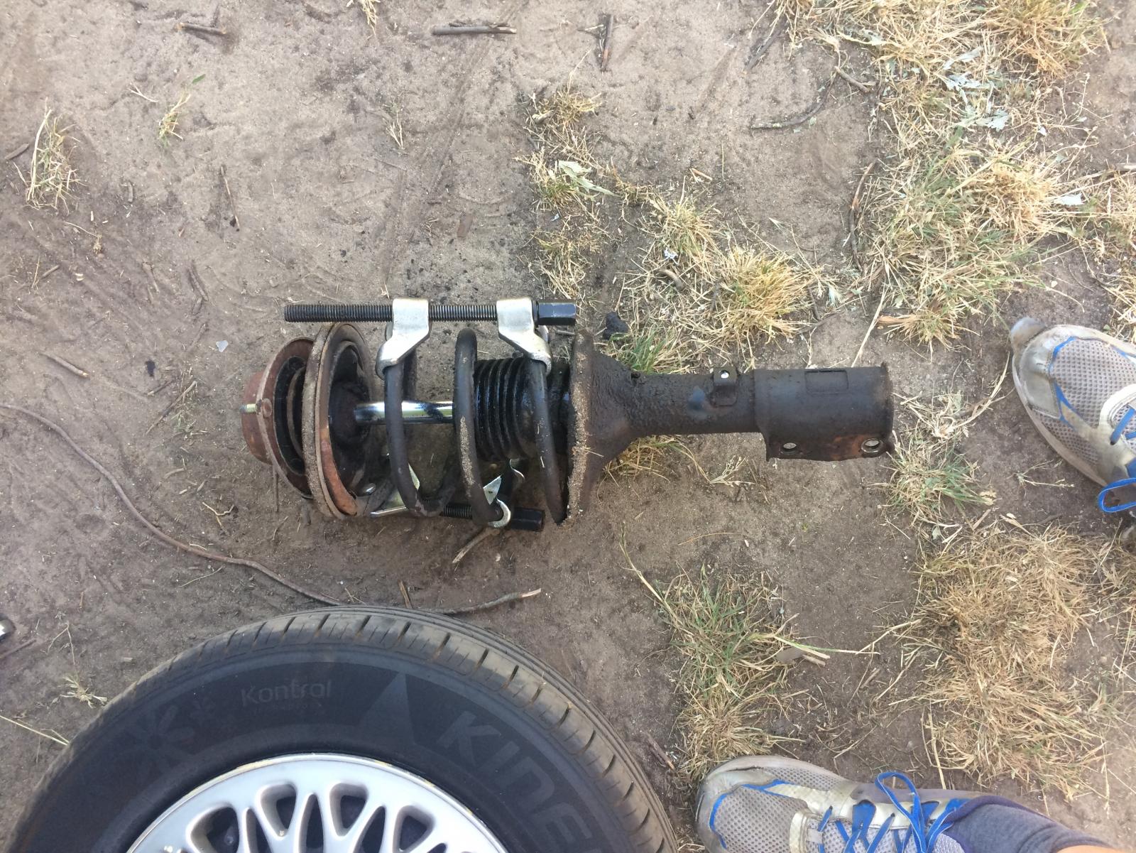

Got the spring compressors going, had to compress the spring and do the spring compressors all the way up to the max!... only way I could bolt the top mount back up to it all before fitting the strut back in place
Anyway, I am well impressed with myself! Took a while but we got there in the end. The old strut has quite literally spewed its oil everywhere and offered no resistance when depressed.
