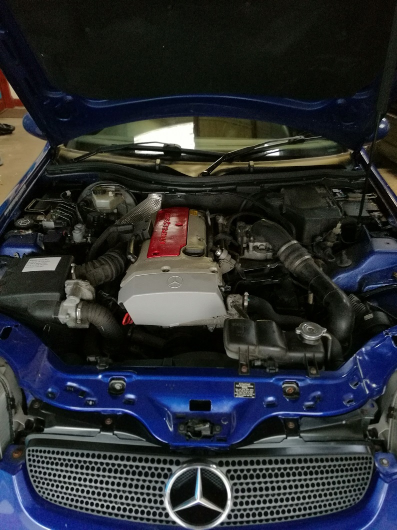

SLK (R170) 230 Kompressor Haarschnitt
Hello. You may remember me from Tokyo Express thread??? Legnum has gone, John. Sold to a very decent chap from the South of England. Meagre funds realised from that sale lead to me purchasing something I'd always prev dismissed as a girls car. 1999 SLK 230. On first viewing the motor was pretty straight, the roof worked, front wings had been replaced it was crucially, pretty grot free. Seller was asking £1750 (Feb 2017). I went in at firm £1400 and then said nothing........ I needed a supercharger in my life and the wife would look sweet driving it, if nothing else.... He agreed and we shook on it.
Deal done, we parted with him holding cash and me heading for the nearest pez station. Issues at that time was front brake sticking. Central locking not really working correctly, AC not working at all.

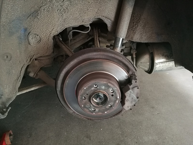

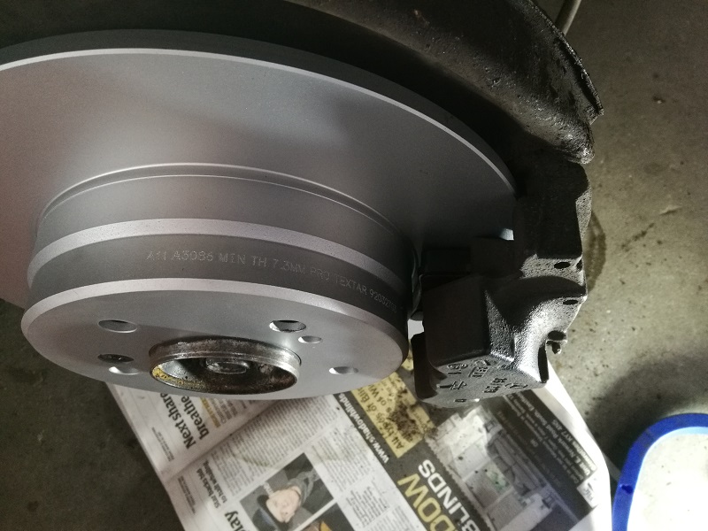

Since then it's had. All round discs N pads. Full service including changing the blower oil, brake fluid and slushbox fluid N filter. I then went onto replace all four shocks as replacements were just under £200 for the four and it really improved the handling/drive. CL issue was the vacuum pump which sits in the boot, the boot can get wet if the drains are not kept clear, so the pump gets soaked and becomes fubar. Replacement pump was £150.
In September last year, the wife and I headed off to Europe and covered just over 5000 miles in 5 weeks. The car was amazingly reliable and yes damn it, fun to drive, best mpg was 35 and worst was 30. Amazeballs. We even clocked up a GPS indicated 135mph on the autobahn and there was more to come if only that 7 Series had moved over. Bastid....
That's about it other than if yer needing yer hairdone, give me a shout, natch.

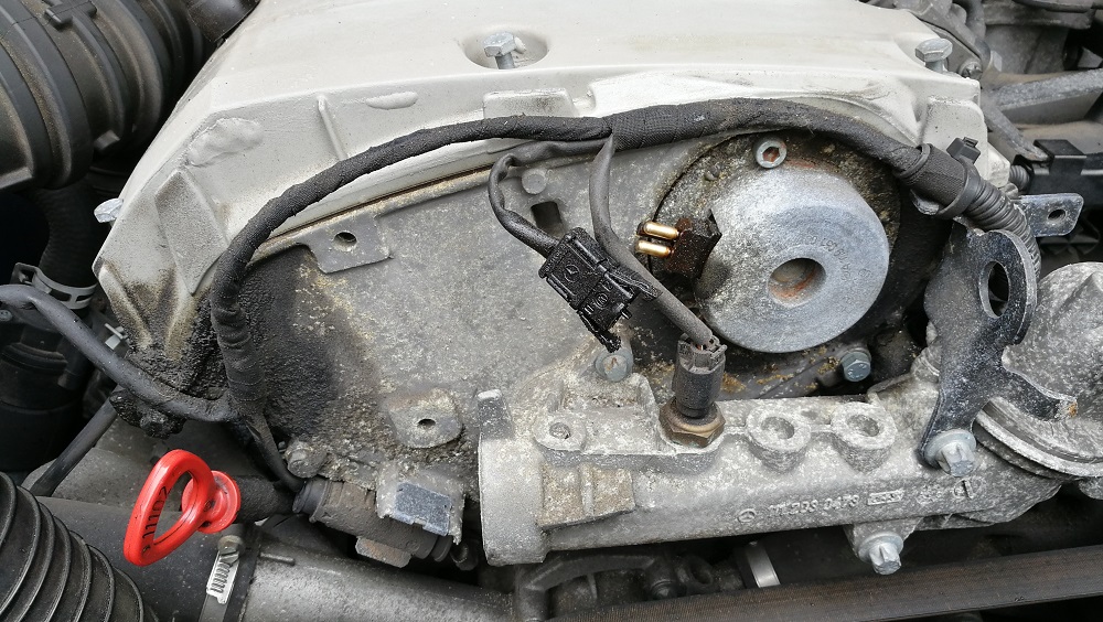

Speaking of dodgy leaks frying the ECU, that 230K unit has a problem with an oil leak from the cam sensor tracking down the wiring to the ECU and the causing problems. There's a quick and inexpensive fix from Mercedes that's well worth the money. Full details here:
http://forums.mercedesclub.org.uk/index.php?threads/slk-cam-sensor.49807/
Thanks for this. I must 'ave that cover off and check it oot!

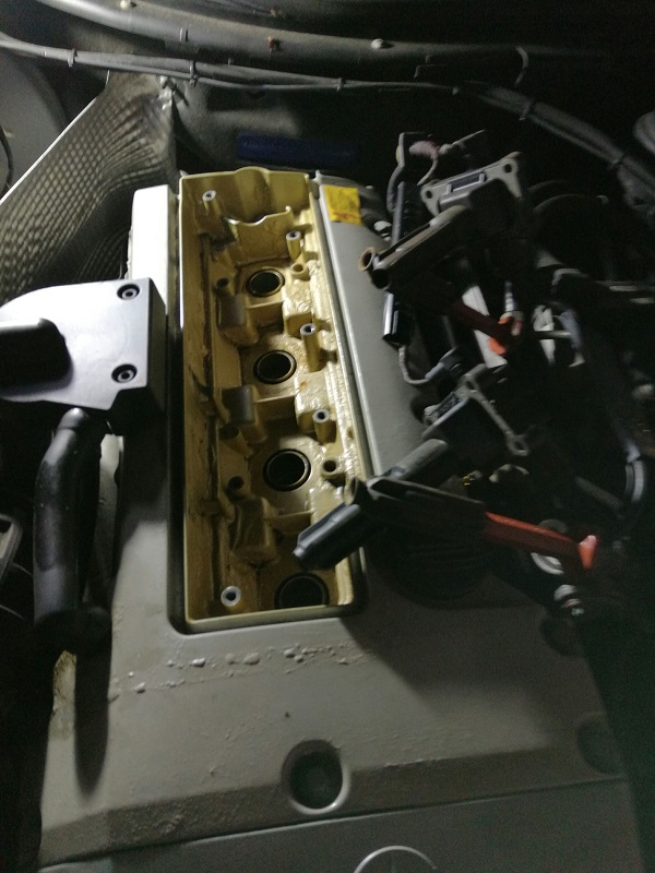

Removed said cover and found the sensor connector and loom wet with engine oil, as shown. As for as I can see it has only travelled about 6" up the loom so it's been caught in time? 100k
Ignore the loose cam cover bolts. Loosened those thinking they held the front cover on? but it just pulls off. :anon:

Just been on the blower to MB Grangemouth, who I've sourced parts from before and are pretty good to deal with. Parts man knew fit I was on aboot right away, common fault and seemed pleased when I confirmed that the oil had only spread a short way up the loom. Seems to be an issue on all engines beginning with 111 as this one is.
Starter line 271 150 2733 O £27
Also ordered a new cam sensor/magnet (preventative maintenance, what!)
with (modest discount given), comes to £97. :gen080:
