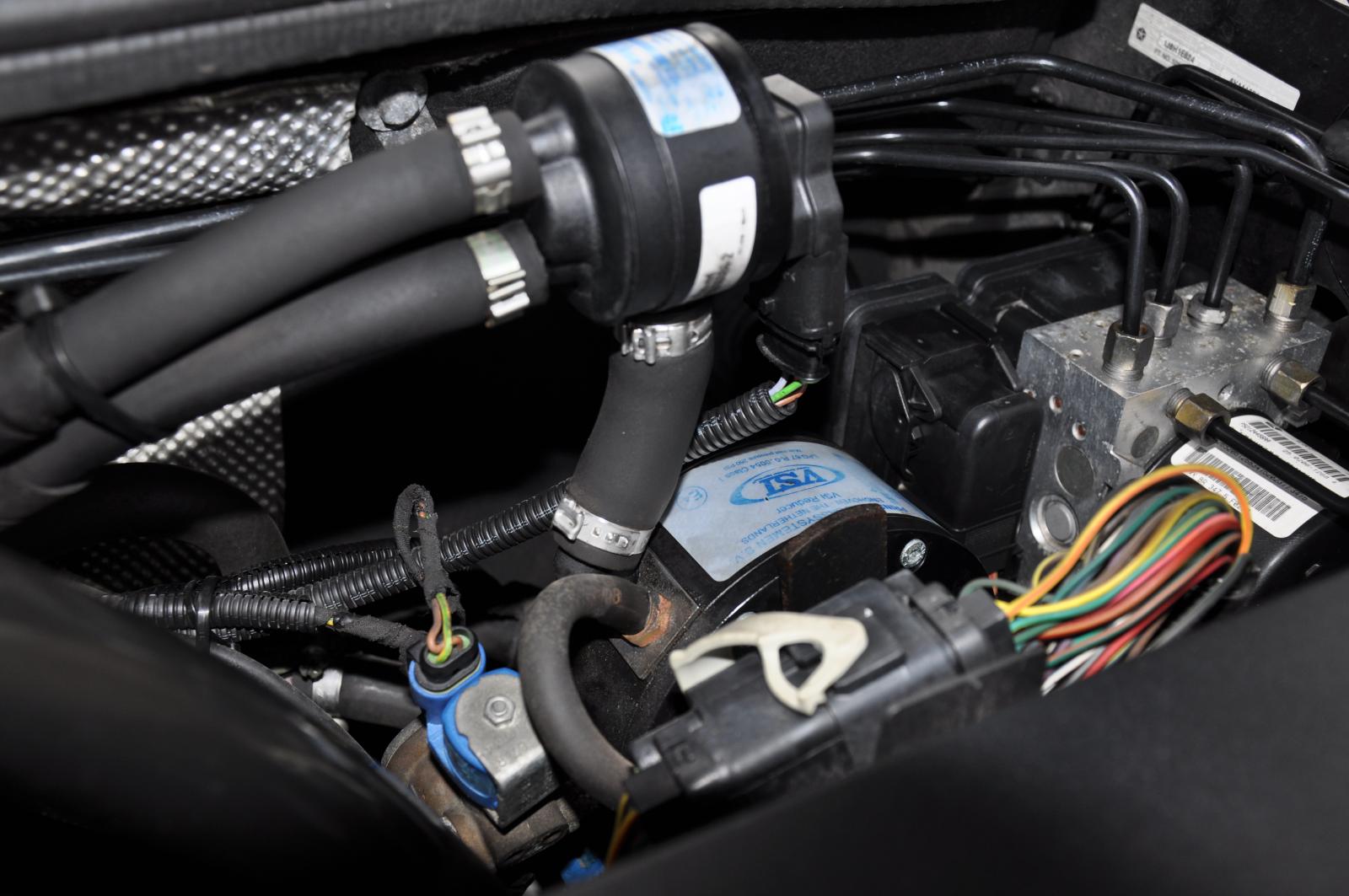

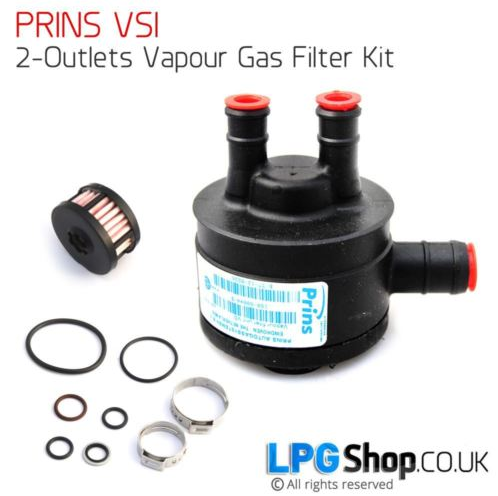

Whilst I can't see anything wrong with the gas system, i'd like to keep it that way so I want to do some LPG servicing, i.e. change the filter/s before taking it to an LPG person with the software to check the parameters.
As far as I can see, there is a Prins filter (twin outlet) mounted just above the reducer but the replacement kit seems to come with 2 filters. Can anybody explain what the 2nd filter is for?
AND then..... I'm unclear as to how gas is delivered. Is there some kind electrovalve at the tank that only switches on when gas is selected or are the lines pressurised upto the reducer?

I've not spoken to him yet though but for £25 it just seems sensible to change it. Do you know what the 2 filters are for?

The little round filter will go in the bowl of the gas shut off solenoid in the engine bay, it will be in the main gas feed line from the tank just before the vapouriser (reducer in modern terms)
Shut off the gas manually at the tank and run the engine on gas until it stops ,to empty the lines, then you can remove the bowl with minimum leakage, expect some gas to come out 1 litres of liquid makes about 10000l of vapour so be prepared for a bit of hissing.

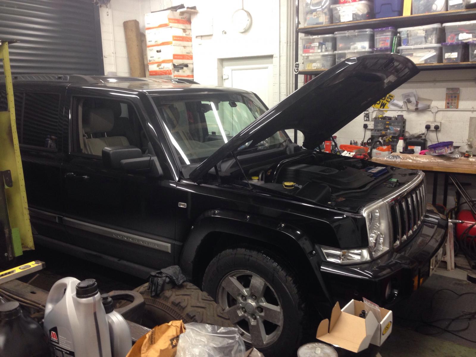

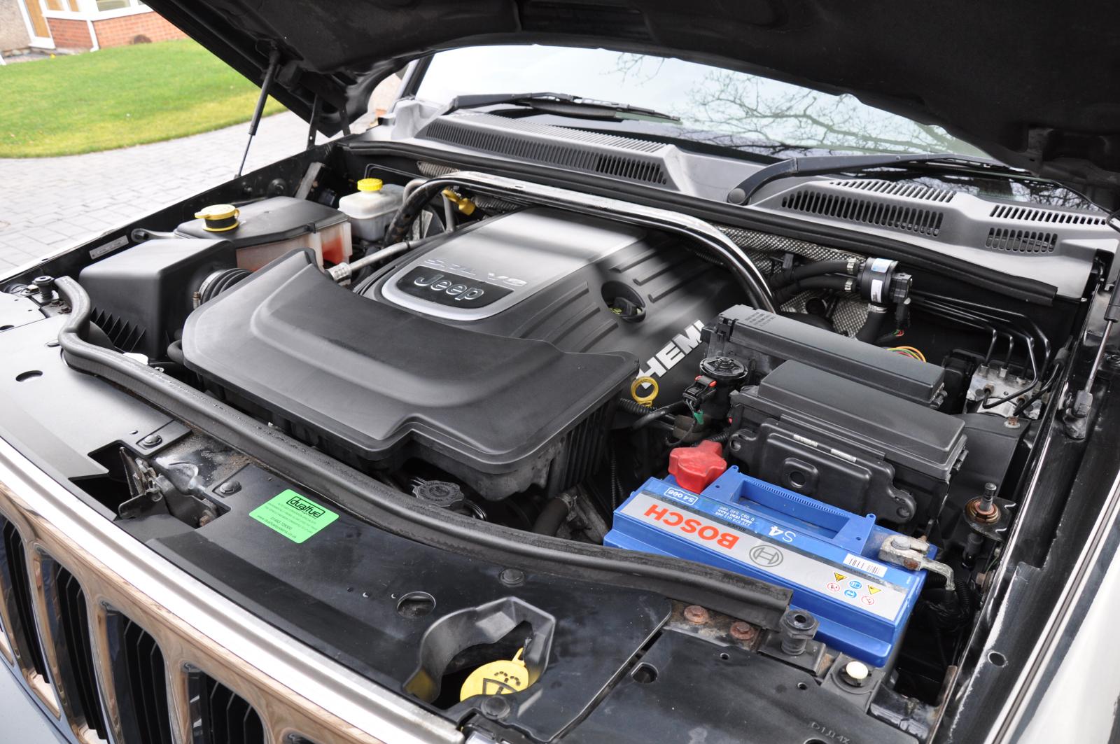

Have been spending the first few days of 'early retirement' with the heater on full blast in the garage.

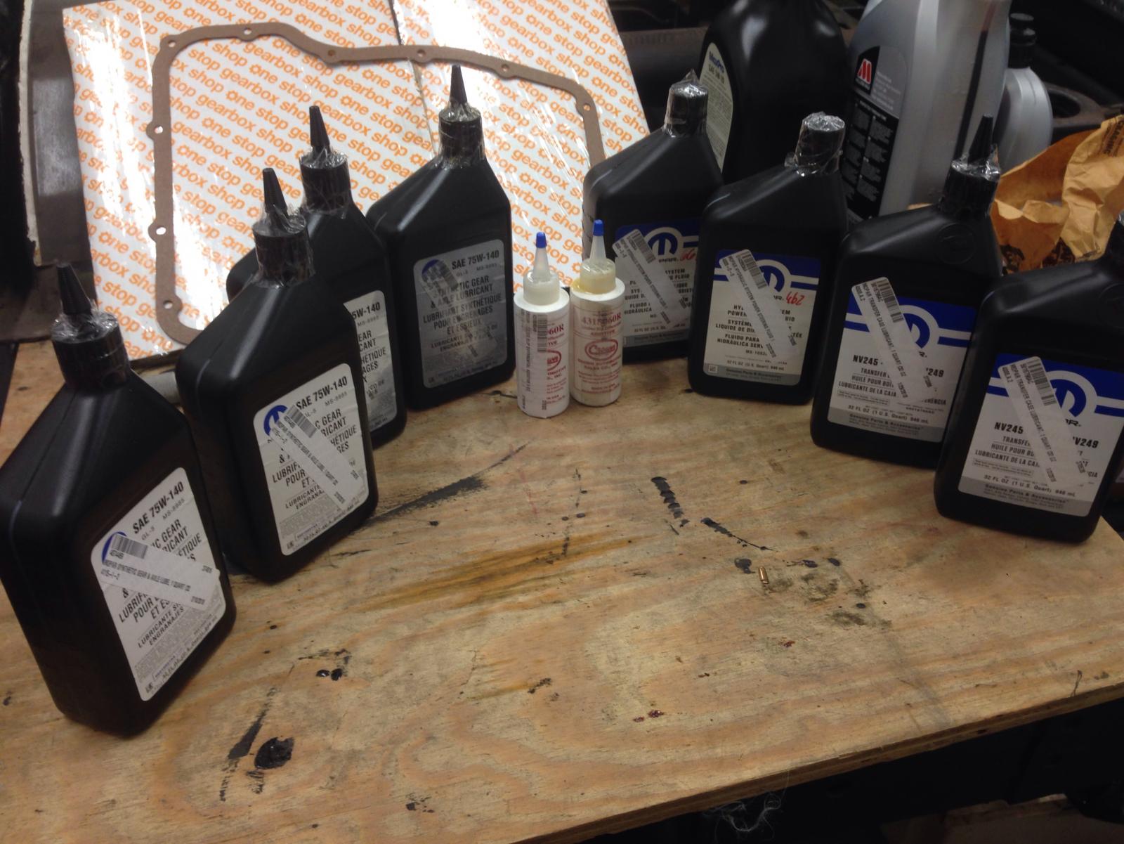

Working through a big ass service on the COMMANDER. Engine and full transmission, gearbox, transfer case, axles (inc LSD additive) etc etc.

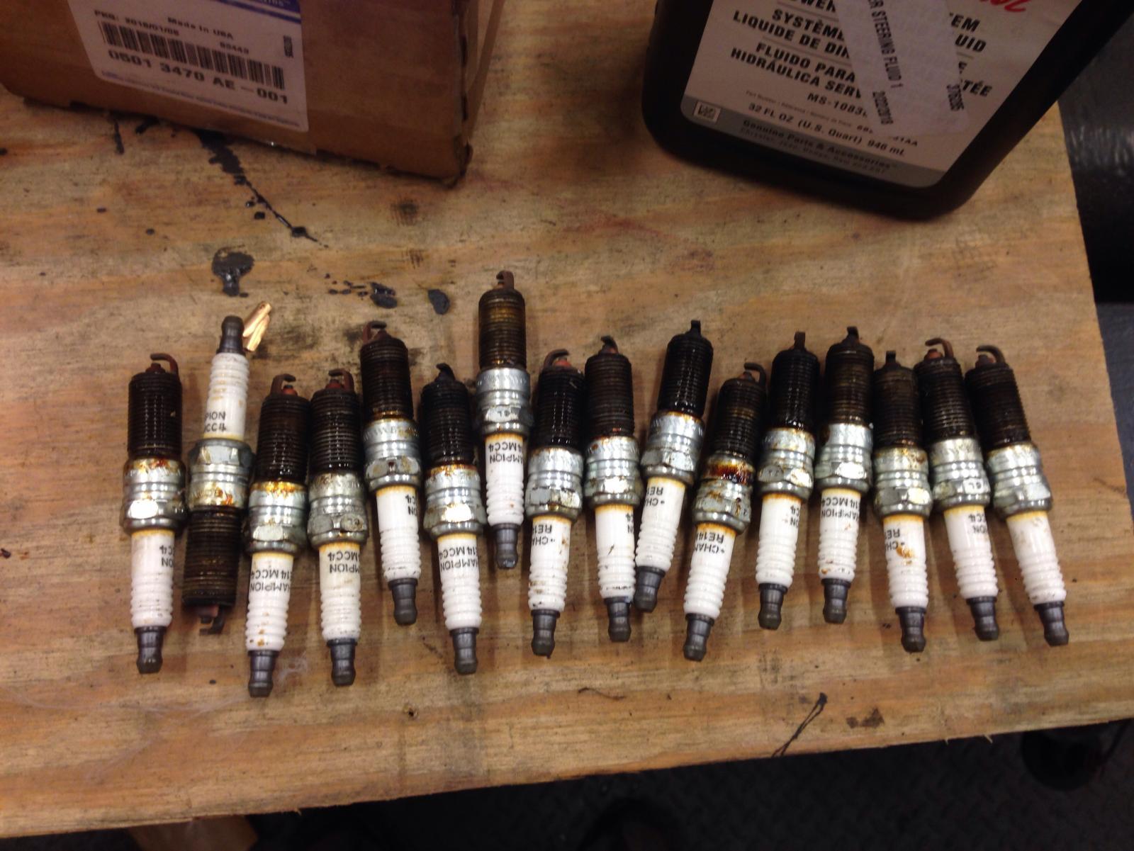

16 spark plugs!!! Jesus, I needed divine intervention to get through that lot. The rearmost plugs are absolutely buried under the scuttle, air con pipes and huge bundles of unmovable wiring harness.
I've hopefully fixed a coolant leak from the LPG vapouriser and changed the LPG filters.
Large quantities of genuine Mopar fluids direct from Morris4x4 in the USA were pretty good value and took about 2 weeks to arrive here which seemed reasonable but so much for the "american car parts are easy to get, overnight delivery no problem".
Still got a load to do but slowly working my way through it. Something that has amazed me was the power steering fluid. Its apparently liquid gold and is accordingly priced, i've found no alternative other than Mopar genuine fluid but the stuff that came out was absolutely disgusting, virtually black. The stuff that went in was clear, almost like water.
I still love this thing. Its a beast.
