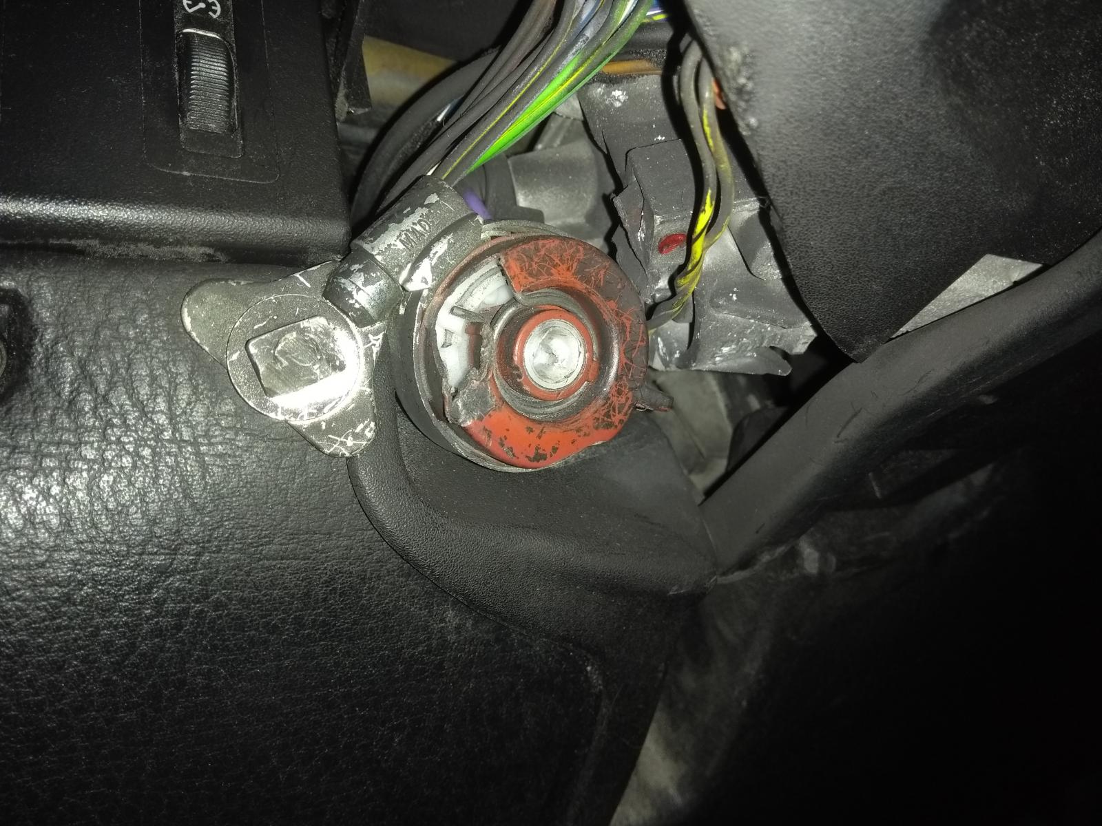

Ah well. got a couple more photos of the situation in there.
Normal key goes here. It turns a bit, but not any further than you would normally expect it to.
Then the all-metal key goes in this monstrosity on the other side of the steering column to switch the ignition on and off, and start the car.
Said monstrosity is only a few mm deep, and I assume is meant to be part of the original barrel. Possible to re-attach? Hmm.
In RBJ's photo from above:
Which end would the ignition switch 'disc' go in? Closest or furthest away?
It's supposed to be on the rear of the barrel.
The ignition barrel doesn't seem to want to go to where 'ignition' would be - it only seems to go as far as 'run'
Perhaps somebody already put a screw in, ala RBJ's suggestion, but they put it in too far?
Who knows...? I can't be arsed taking the steering cowling apart until the weekend either.

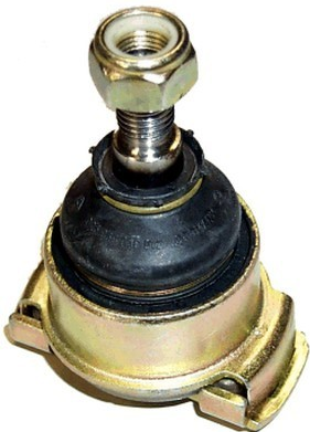

What are the front outer balljoints like to replace on these?
Just ordered a pair of them from GSF. 56% off, so £16 for the pair of them. They were advisories in the MOT, and the steering does feel a bit floaty sometimes, accompanied by a little clunk from the front end (which you can feel through the steering wheel) now and then.
E36 outer balljoints are shit. The usual approach for me is to stick E30 track control arms on ( complete with inner/outer balljoints and new rear bushes)
E36 ones are held in a funny way, and have not been fun to change in my experience.
Hmm. Not what I wanted to hear!
I'll have a bash at them anyway though.
EDIT: Looking at pictures, it seems the balljoint needs bashed out with a BFO hammer, and the new one bashed in again with a BFO hammer. Hmmmmmmm. I know my parents' neighbours (in both directions along the road from the farm) have hydraulic presses, the sort of thing you'd normally use for pressing in wheel bearings. I'm sure something could be arranged.
So to put it into pictures.
I've ordered these:
However, the whole track control arm looks like this:
So the balljoints must press into the ends there. Fun*
Tbh I'd return the balljoints and order 2x E30 Lemforder arms plus new lollipops with the bushes already pressed in.
Yes. Forget replacing ball joints without the special tool.
Feck.
I'll try to return the GSF order then.
However, if I use one of the discount codes I get from GSF I can get both of the whole E36 arms for less than the usual retail price of one. May do that.

Buy the E30 arms, not the E36. The E36 balljoints are held in with thon daft clip, rather than pressed in.
They can be noisy even when new (I think there may have been an MOT note about them?)
