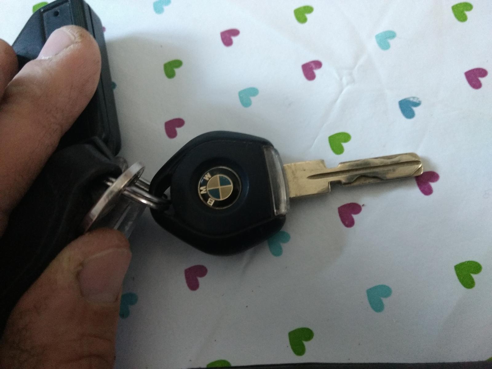

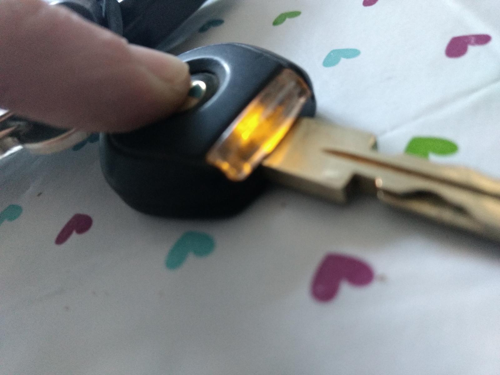

I can give you this for now:
I'll get a better photo later.
There is a sort of button on the other side of the key, looks like it would have once had a BMW badge on it, but it's worn smooth to just silver. The button presses down but doesn't do anything though.
You can also make out in that picture the plain metal key, which seems to be a blank (it's BMW branded though), which is used to turn the separate ignition switch on and off.
The little fob is for the alarm / immobiliser. It's got a little red light on the dash that you have to press the fob against until it goes out.
This car has ews.
The button you speak of would operate a light in the key ( if there was any juice left in the battery)
The second key is an old valet key from a 318iS I had - I only used it as it fitted in the ignition section ( right shape)
Its not for the 320 and won't unlock anything.

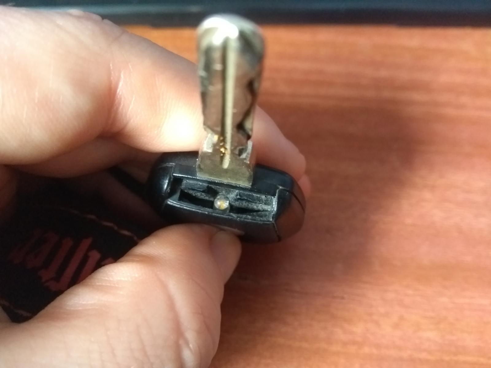

More key-related info!
Top:
The button does indeed do something!
Bottom. Looks like a battery cover to me.
Comes apart fairly easily too, and went back together.
That is EWS and 1/95 is the first month of production. The arrow points towards the EWS chip. It's secured by some double sided tape type stuff.

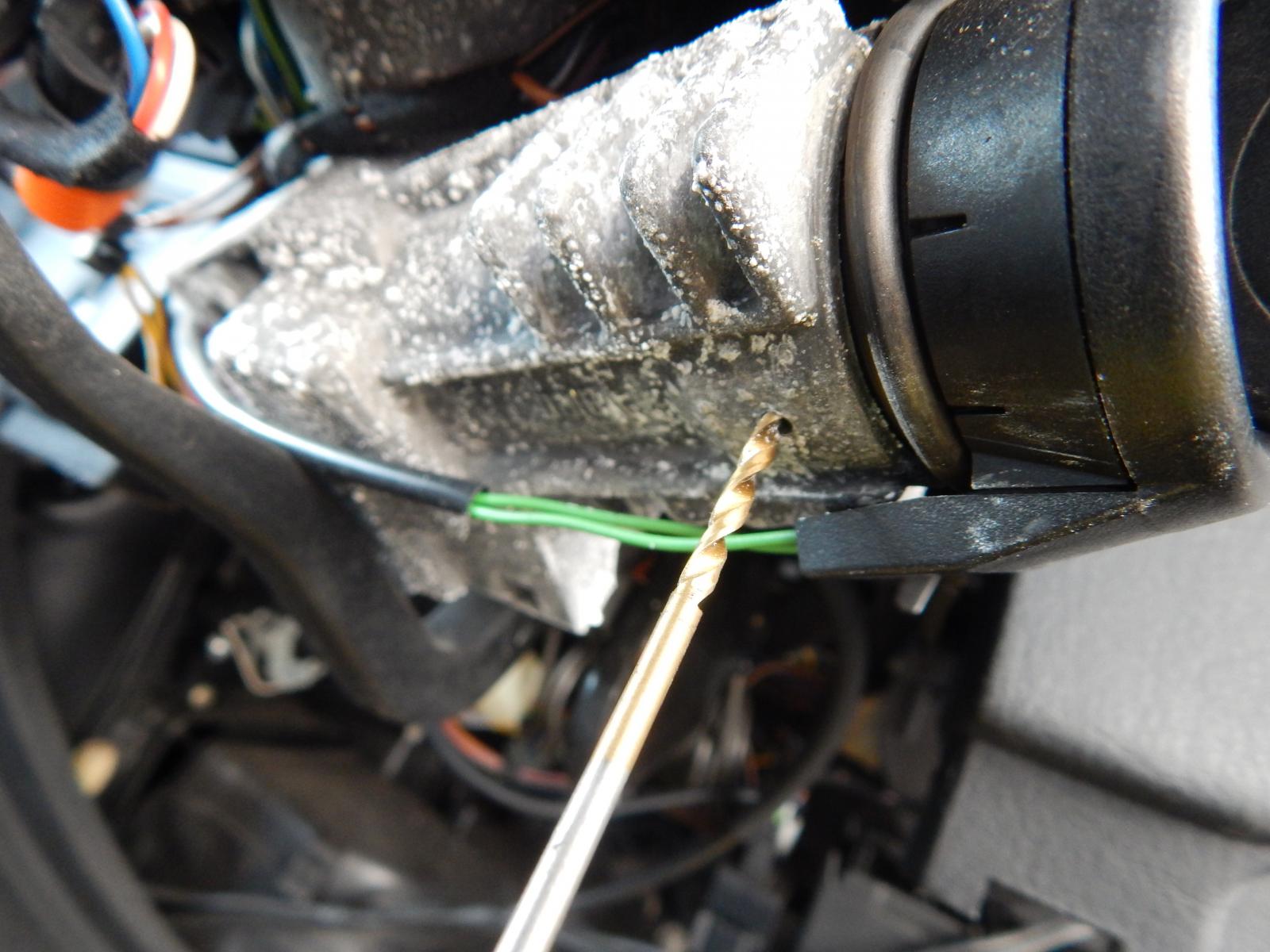

If the barrel just spins it can be fixed in 30 mins with a selt tapper. The plastic anti theft base is designed to break off if forced and after time they just wear out. If the barrel when the key fits is still there and the key still fits - and it just spins - it can be fixed.
Drill and screw here.
Wind the screw in until the barrel starts to jam up, back it off a tad and the key/barrel should work properly
