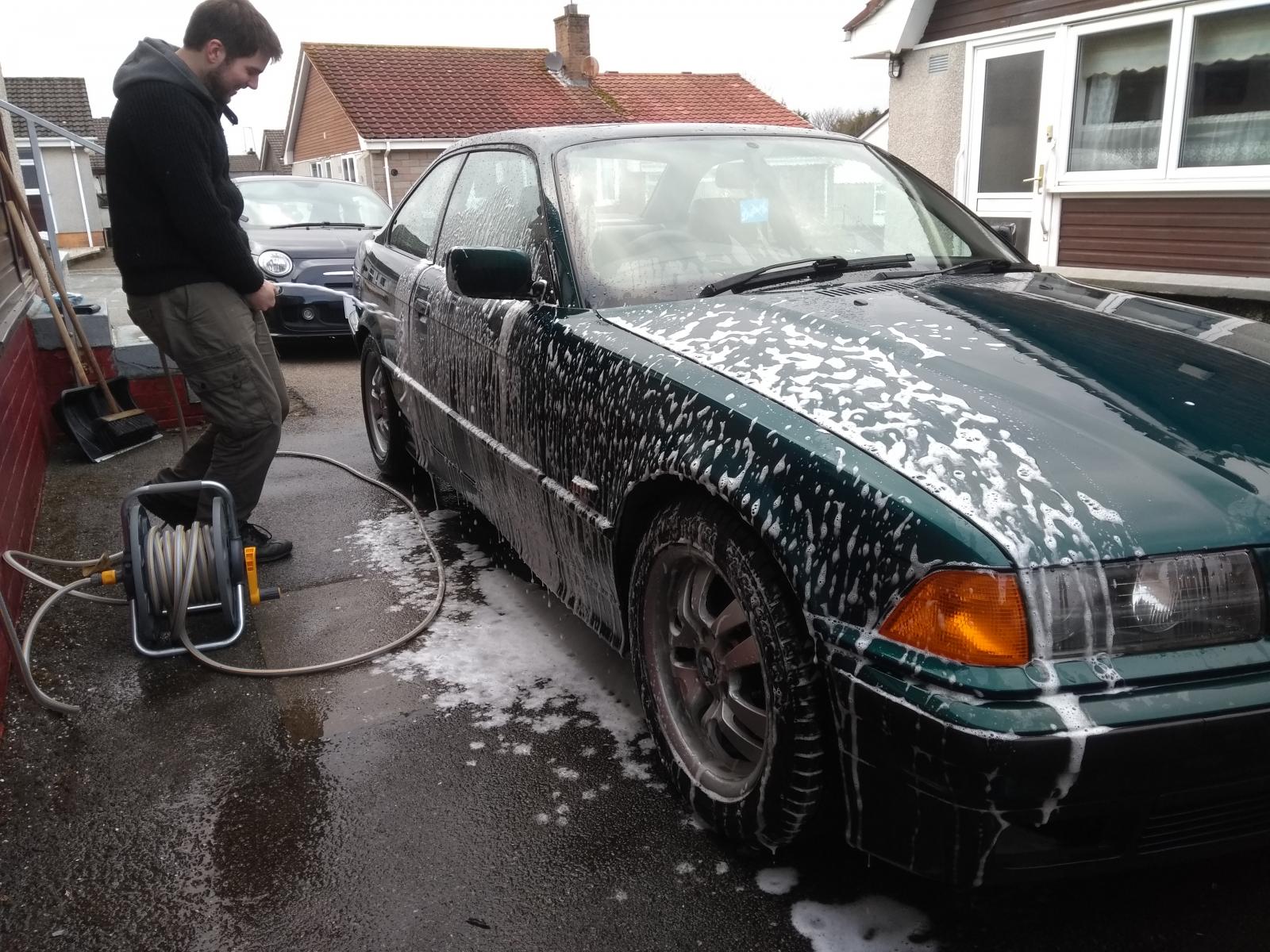

That brake dust!
Also, immature snowfoam photo you say?
Bah, you edited the post while I was posting this!

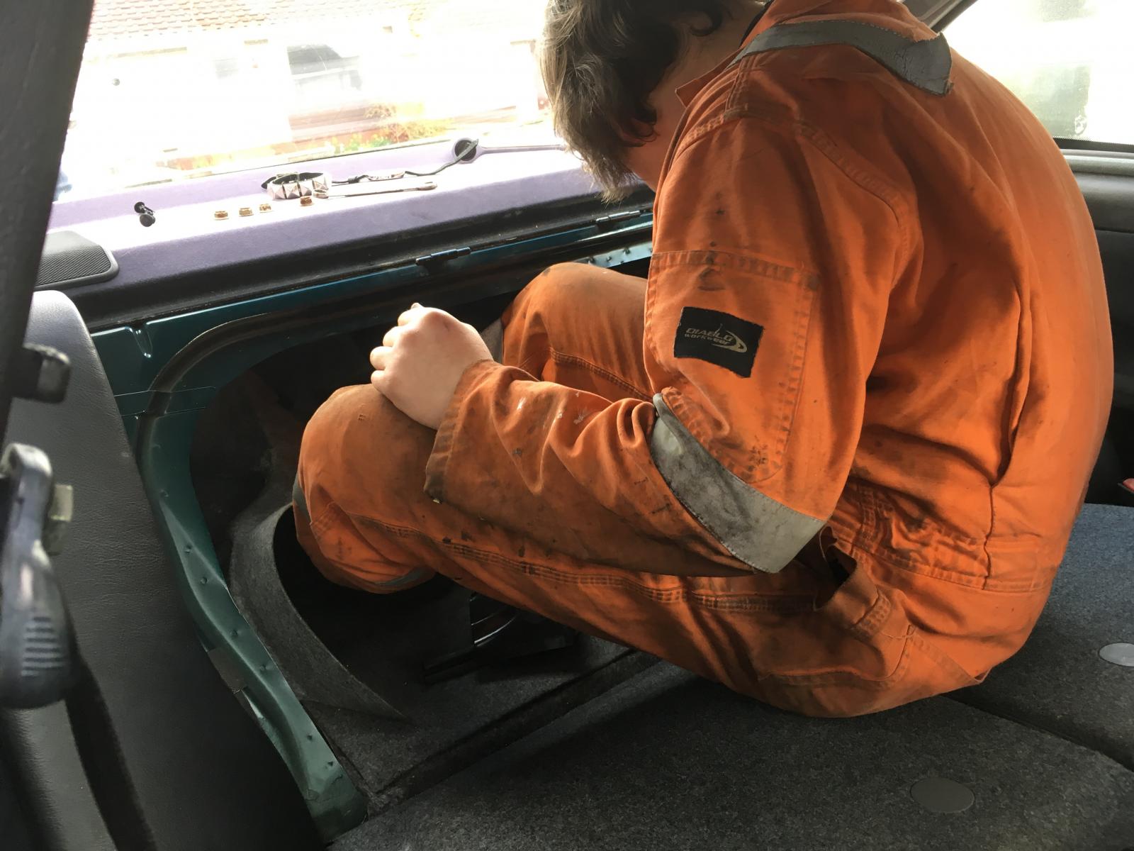

Changing the rear shocks on this was relatively straightforward! It now has new rear shocks and top mounts.
The front ARB links are now properly attached too, and I even put a motor in the driver's side window! The driver's side window still doesn't do the automatic drop a few mm then back up again when you open/close the door, but you can still open/close the door with it all the way up. Seems better than it was with the regulator cable-tied in place. It's not the quietest of electric windows either... hey, at least it works!
With the suspension sorted it actually feels really nice to drive now.
Have a photo of me looking victorious after removing one of the shocks:
Mr Coffees has more photos. I was too busy, y'know, doing stuff to take photos.

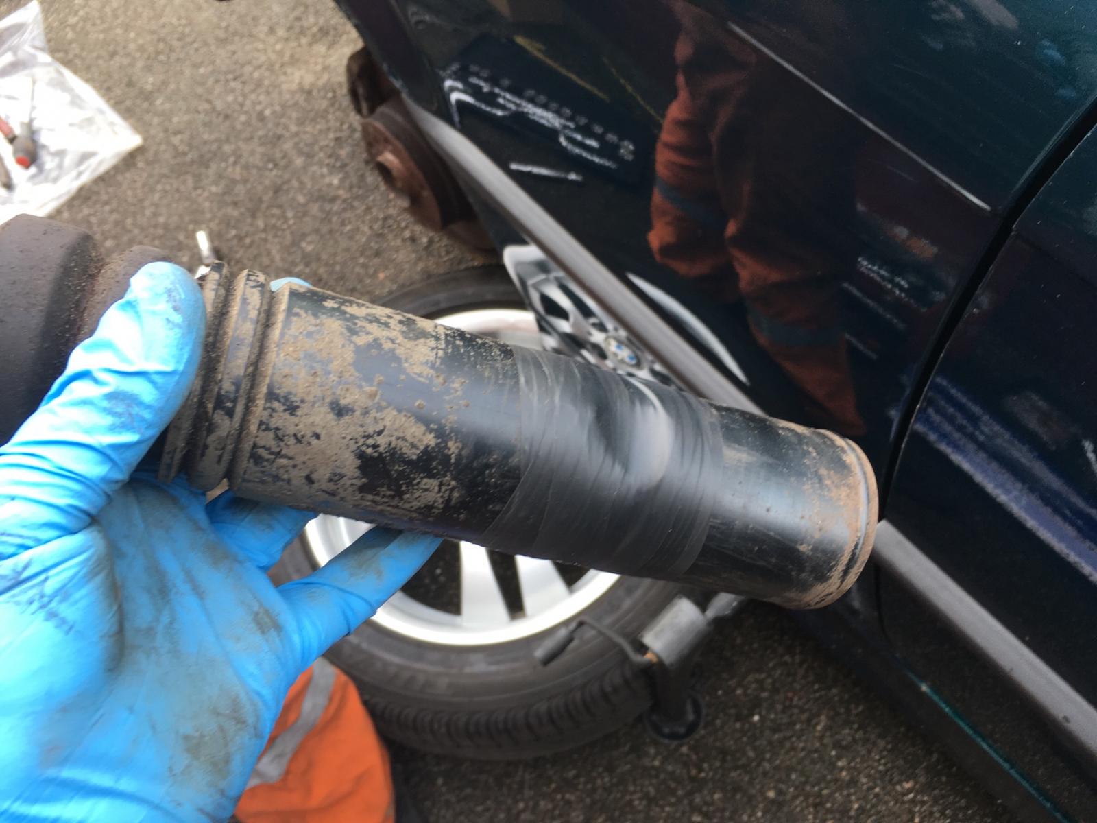

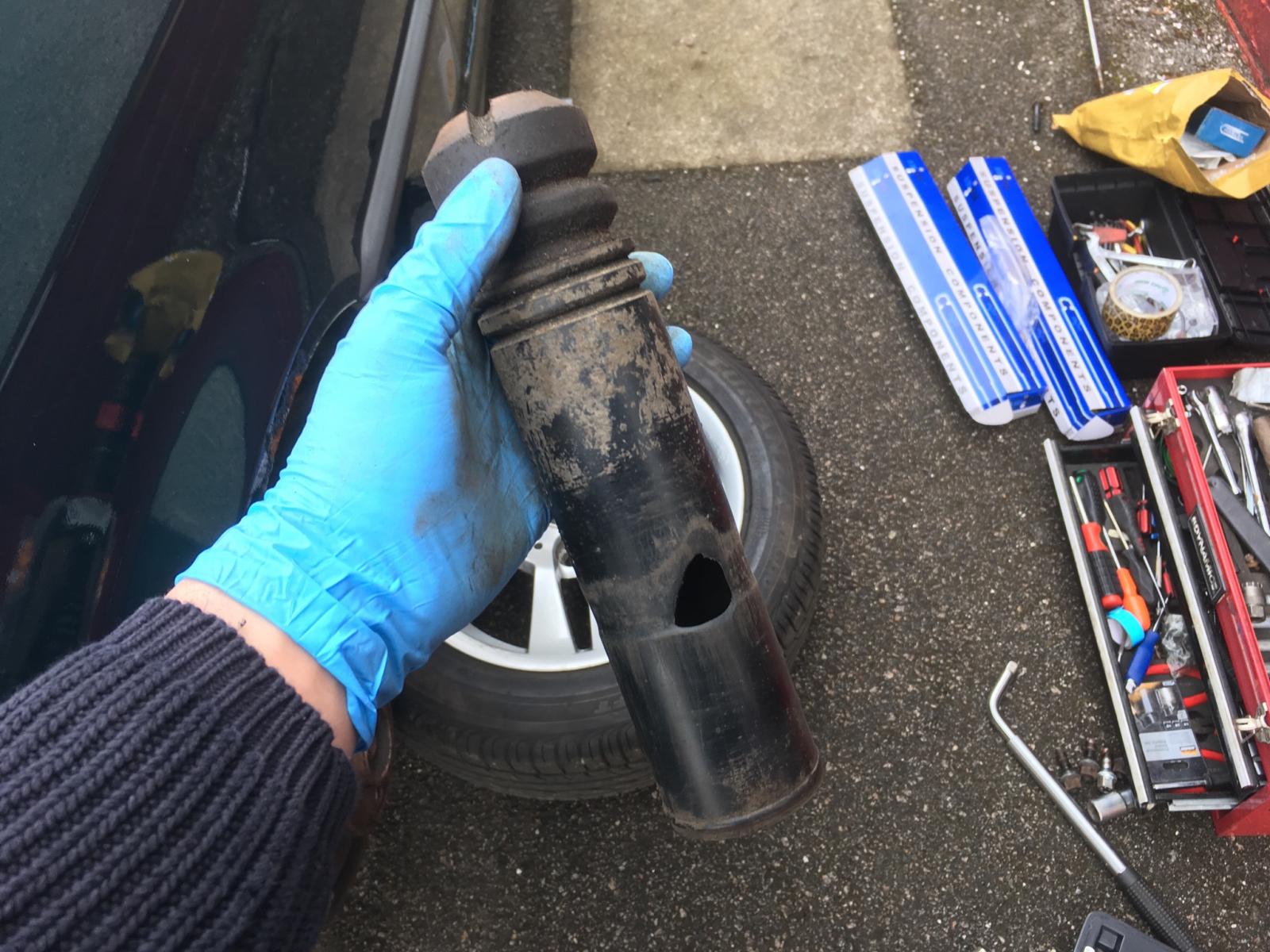

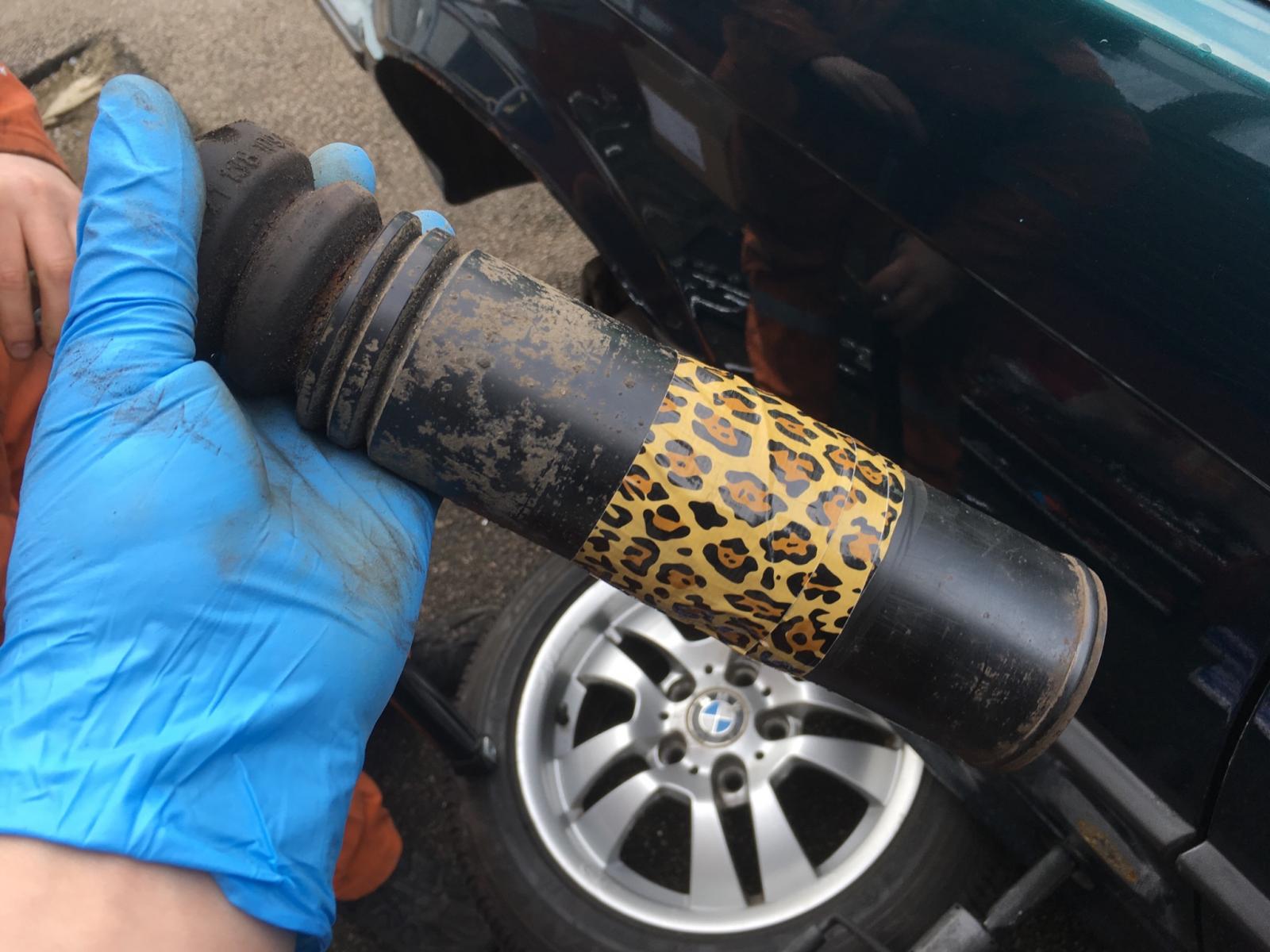

The O/S/R shocker sleeve had been rubbing on something, leaving a small hole, So i decided to set about fixing it...
Correct* use of electrical tape
And for the lulz...
Sorted. :)

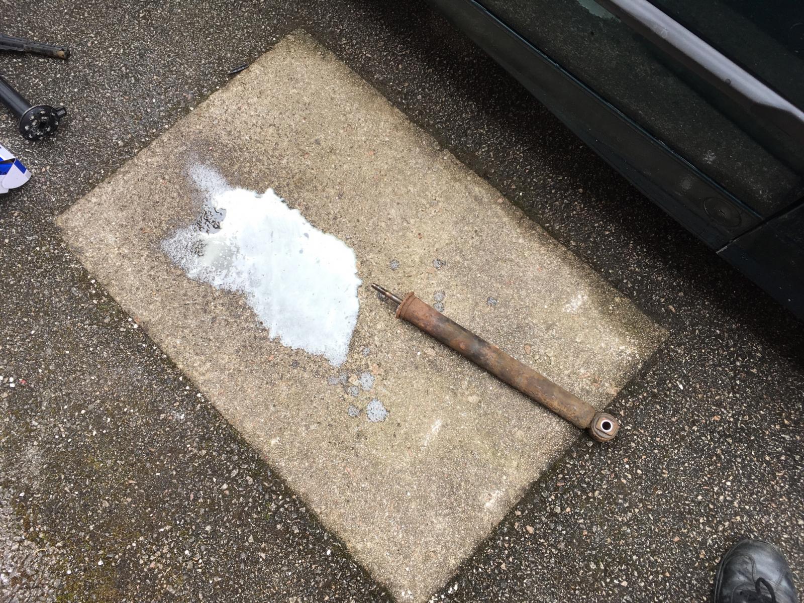

I decided to fully compress the old shocker...
Which resulted in this happening.
Its worth noting that while the shockers were fine enough and not leaking, the top of the shafts were very corroded. I chipped away the built up rust, which was a fair amount. About 1/2 of the shaft was left. So was a good call changing them.

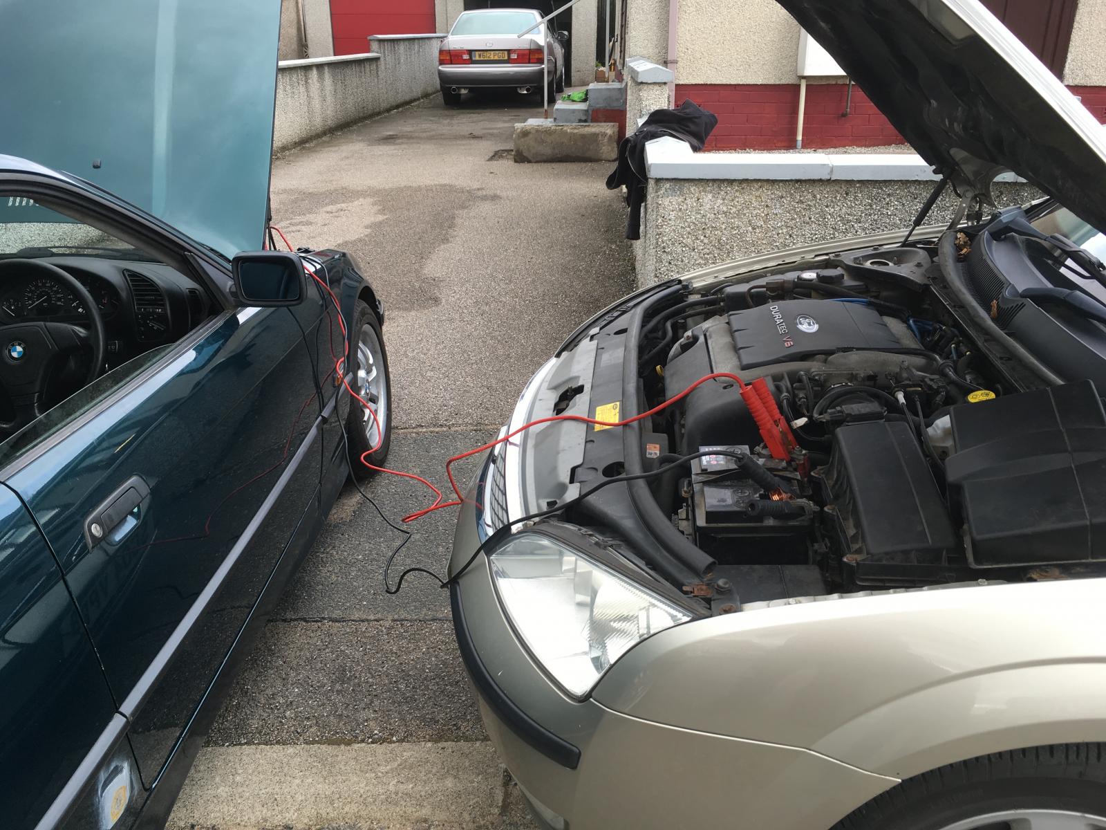

The battery had died, again, so could't get the boot unlocked and had no access to jump start it. Much like the weekend before...lessens were not learned.

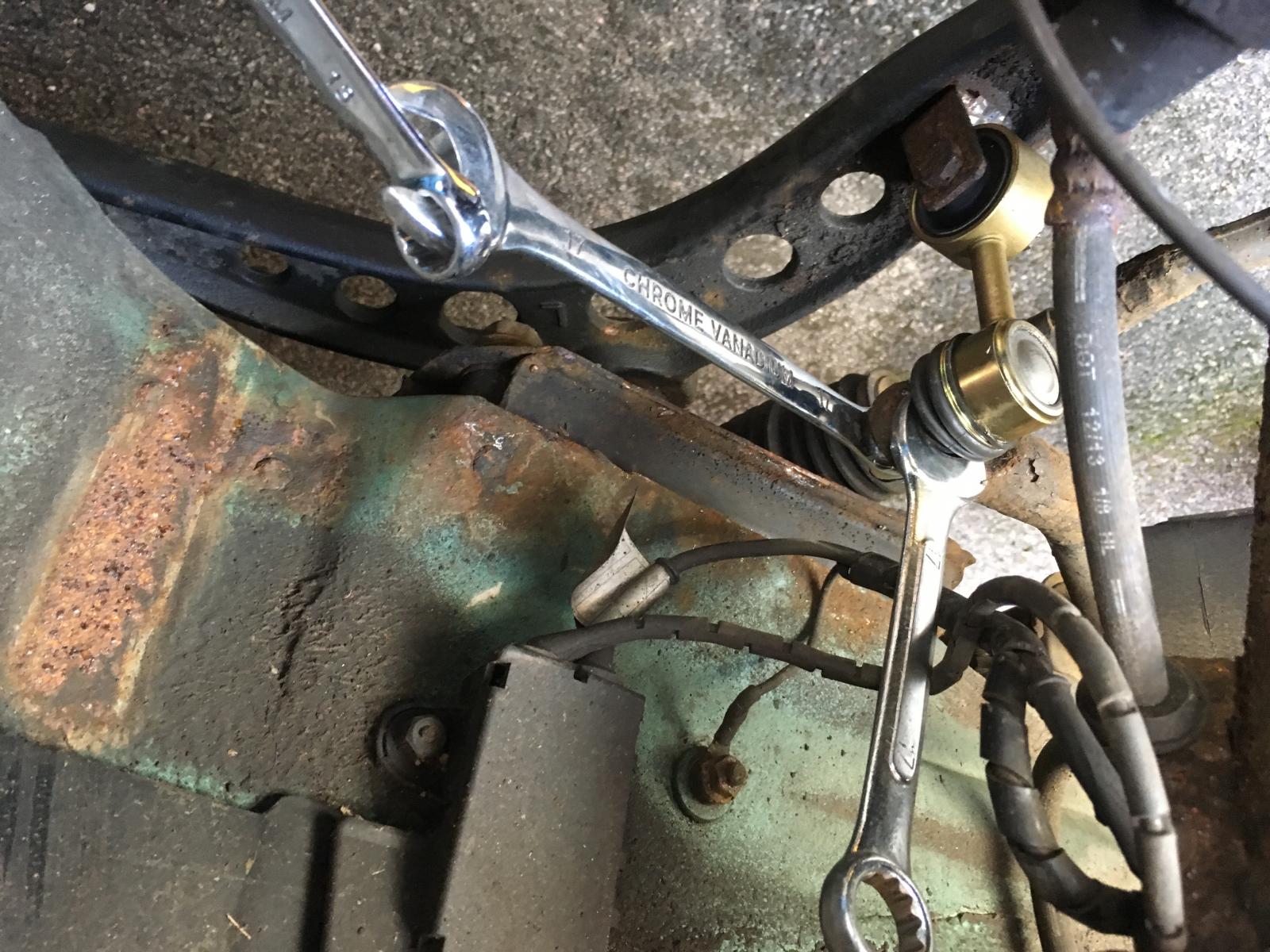

While he finished as started stripping the drivers door down to fit the new motor, I'd sobered up enough to actually be bothered helping, so I seen about fitting the bracket to the N/S/F lower wishbone, to finally re-attach the wishbone to the new drop link.
*Why it's upside down is beyond me?
Going back to saying the battery had died again, we had to do the same procedure as the weekend before to jump start it, that is as follows:
1) Roll the BMW down my driveway
2) Block half the street with the BMW
3) Drive SN's Mondeo up to it and then attach jump leads to battery point on front of car
4) Jump start the bugger
Thankfully it started no bother's, unlike last time. So quickly drove it up the driveway again and let it idol while tidying things up.
