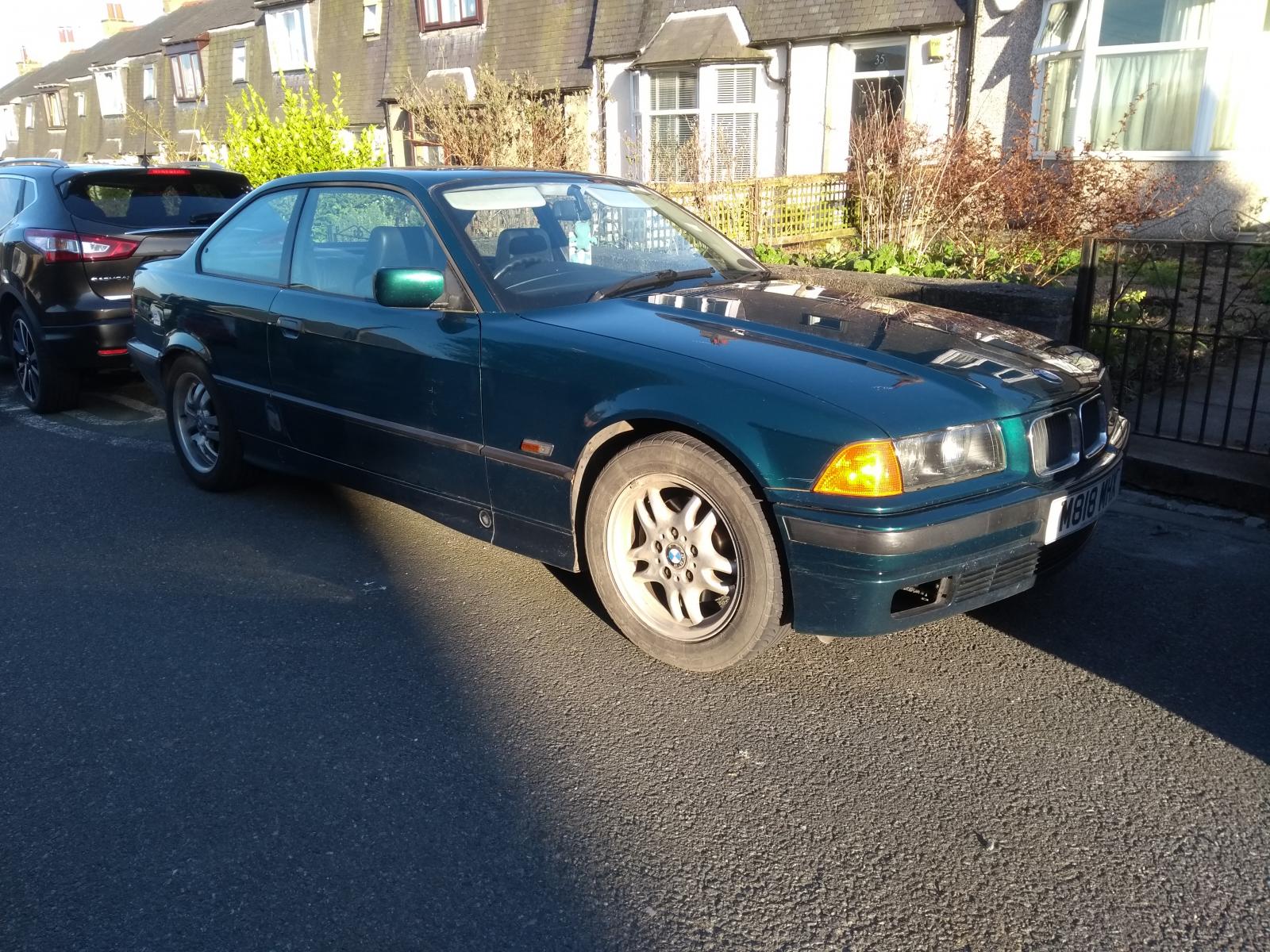

1995 BMW 320i
It gained a sticker yesterday. Seems fitting for a shabby E36.

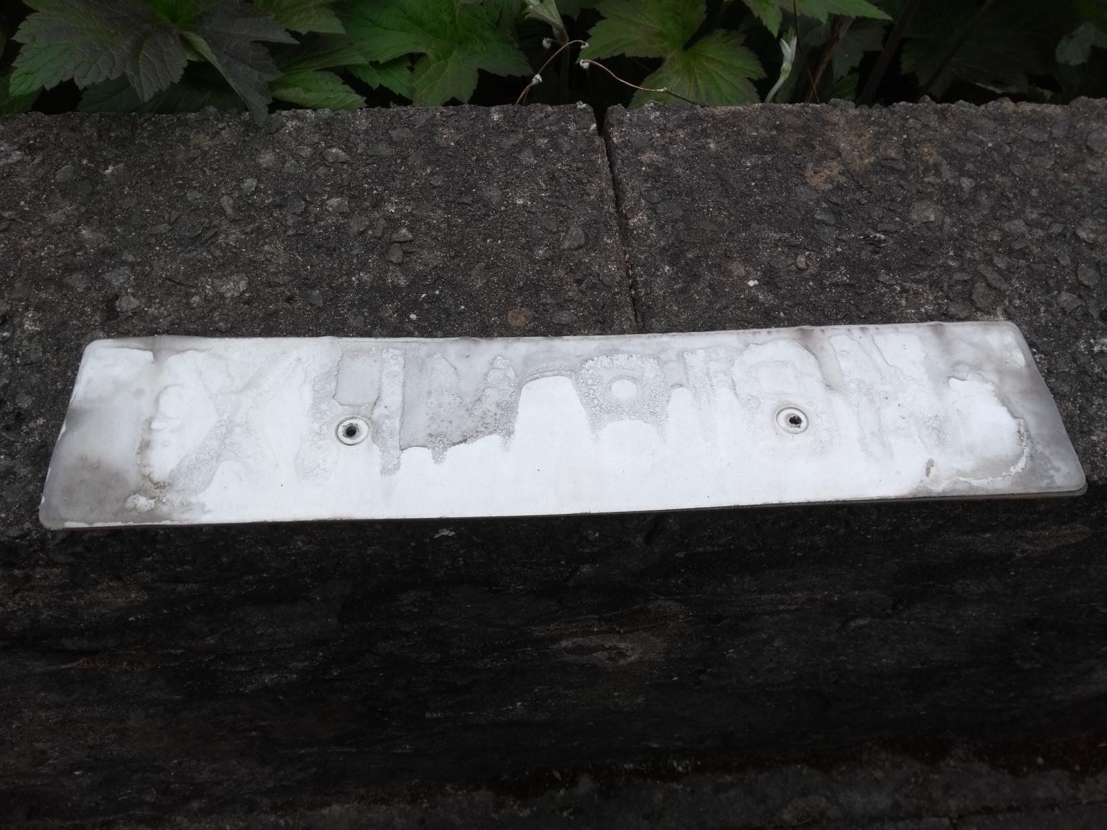

I found a barcode behind the rear number plate. I left it, because it would seem rude to disturb it.
No wonder the rear plate was an advisory on the MOT. It was somewhat past its best.
The white screw on the front number plate doesn't actually intrude on the X, it's just the angle I took the photo from.
Opinions please, should the black screw on the edge of the 8 on the rear plate be yellow instead?

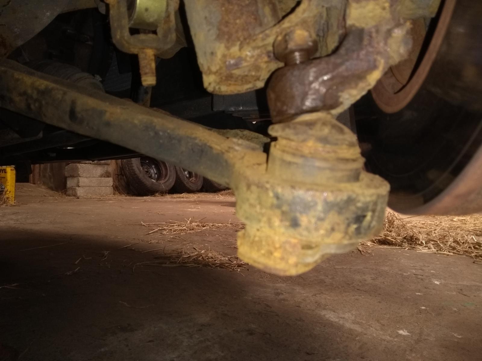

Oh yes, this happened while taking it off.
That is the outer balljoint. I'd loosened the nut at the top, but the taper was still holding tight. Levering the control arm down resulted in the - pressed in! - balljoint separating from the control arm and still staying put in the bottom of the hub. This was the point of no return in regards to putting the car back together, so judicious heat was applied in order to free everything off.

Knock fuck out of the bit that the bottom ball joint taper pin fits into. Hit it as hard and often as you like.
For *really* obstinate bastards, see above, but this time with two hammers - swinging at the same time and hitting as close to opposite each other as you can.
Never failed to break those tapers with no more than hammers.
Guest VicN
That's the way to do it.
Although you can just hold one big hammer against the side and wack the other side with another hammer.
Mine was properly stubborn!
We were putting pressure downwards with a pry bar and twatting it with a hammer and it still wouldn't move. It took heat in the end to get it shifted.

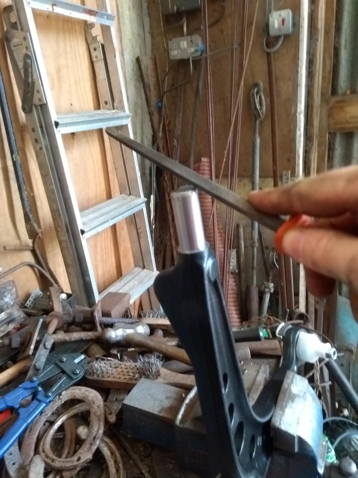

Me and my dad managed to remove the passenger side lower arm, and fit the new one complete with lollipop bush. This time I had bought a balljoint splitter which made things easier.
Access to the inner balljoint on the passenger side was achieved through creative use of extension bars and a flexible driver.
Attaching the lollipop bush required a slight taper to be filed onto the new lower arms. Well, it made things easier anyway.

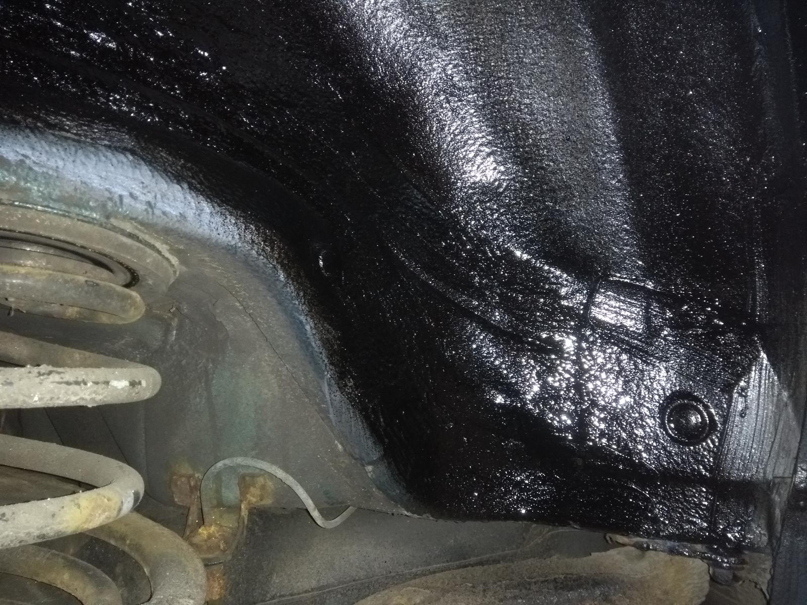

Once it was all buttoned up at the frond end, I got the back end up on axle stands for a coat of rust converter...
...then underseal.
