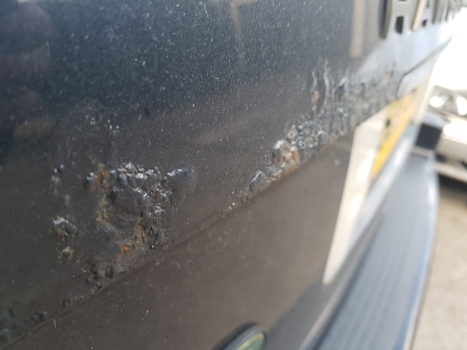

Mine's gone to Kent with something like 208k on the clocks, still driving very nicely and wearing its miles well, other than a crusty lower edge on the upper tailgate. From what the buyer said it was getting wrapped black, with window tints and larger wheels. Shame, as I looked for ages for a clean, unchavved one! Mine was converted to gas at a year old when the second owner bought it to do lots and lots of miles, so it certainly wasn't done on the cheap.post-577-0-25924500-1509182610_thumb.jpgpost-577-0-01354000-1509182639_thumb.jpgpost-577-0-94319700-1509182662_thumb.jpgpost-577-0-92013300-1509182687_thumb.jpg
