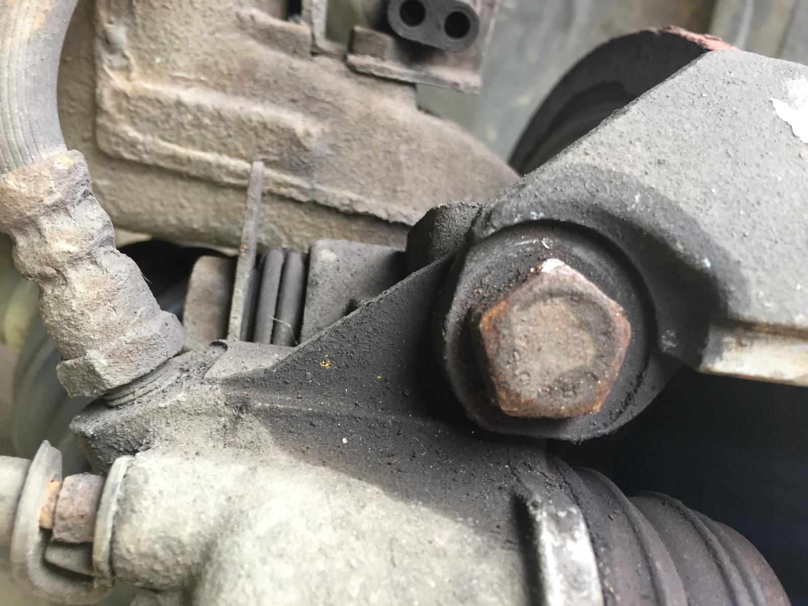

I'm just doing pads and discs on the mighty ZX. The calliper mounting bolts are a weird 5 faced item. Any suggestions for tooling or tool purchase
You need a 'Shiva Socket' m8
TS
You don't need to undo those....take the whole unit off.........one bolt head is visible just to the right of the flexi end in your pic
It's a pentagon head to stop you undoing it by mistake; dismantling a caliper you just meant to remove.

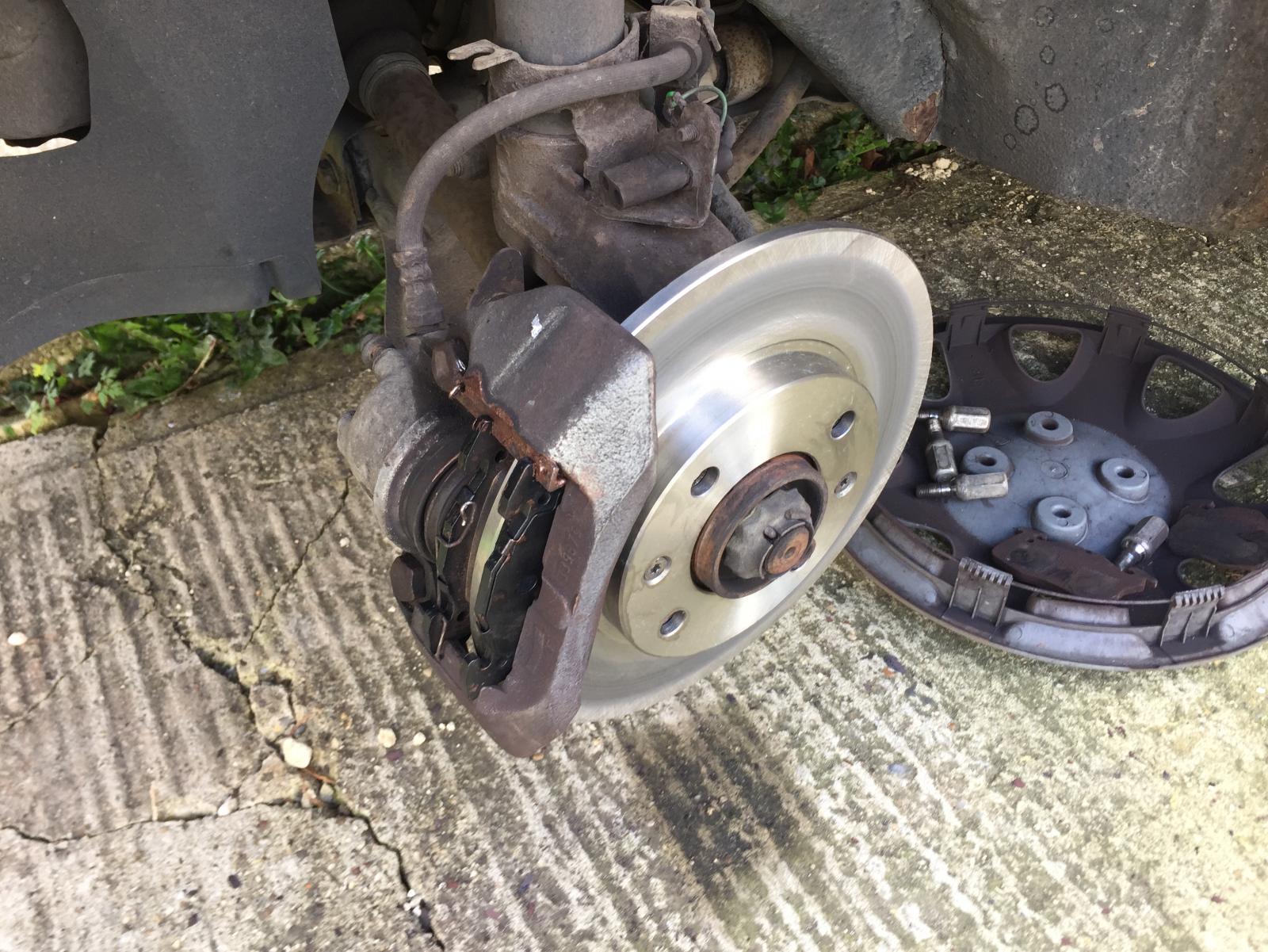

It had been a long day. Missed the main caliper bolts and thought. Oooh easy I'll just pop those 2 off and have the disc away.
