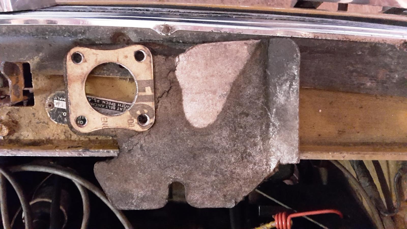

Yup. same deal on the Princess. They're absorbent so any fuel or oil leaks are soaked into them and that can then smoke.  Replaced mine with some aluminium sheet.  If there's no heatshield you'll find you get vapourlock on the three days of really hot weather we have each year so it's worth replacing them if you can to avoid that.
Here's a couple of pics of original heat shield.
Thanks, yes that's them. So definitely not home made then!

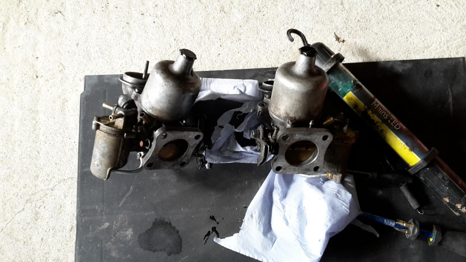

Latest Update. Carbs off again. I've attached a pic of the dirty heatshields. They were covered in oily grime. I've ordered some aly ones, but they're not coming until next week.

As others on here have said replace the broken heat shield with ally plate. Friend usedan old number plate. ;)
