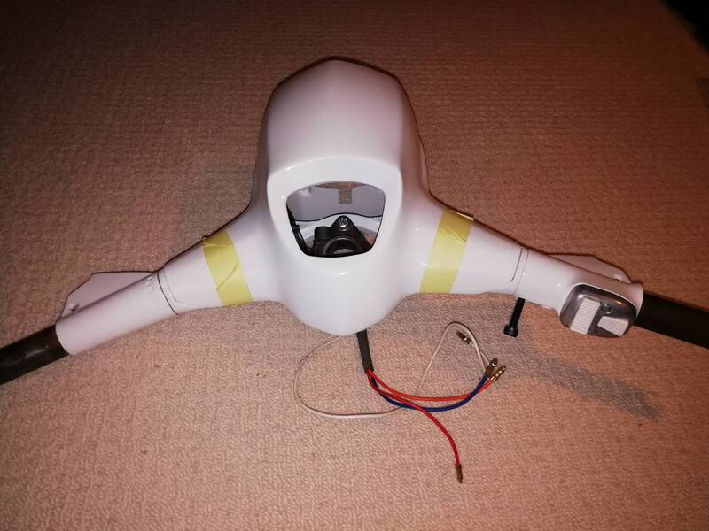

Careful removal of paint from key areas allowed the steering lock gubbins to be fitted, closely followed by the dip switch, throttle + gear controls and finally the headstock clamp.
No paint damage yet................

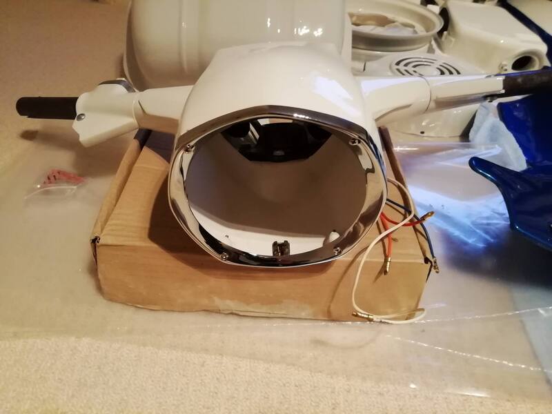

The threads in the handlebars, horn case and tail light housing were all cleaned up with suitably sized taps so that the screws ran in nicely.

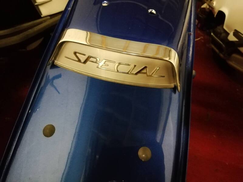

Just before teatime, the rear frame badge went on after a bit of a polish.

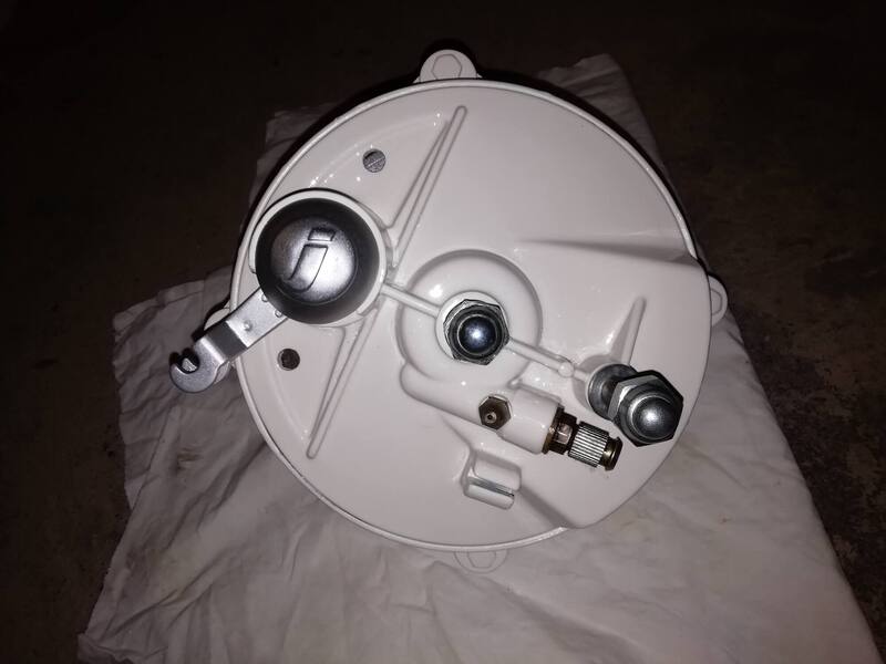

Front hub was built up yesterday - really pleased that I didn't mark the paint!

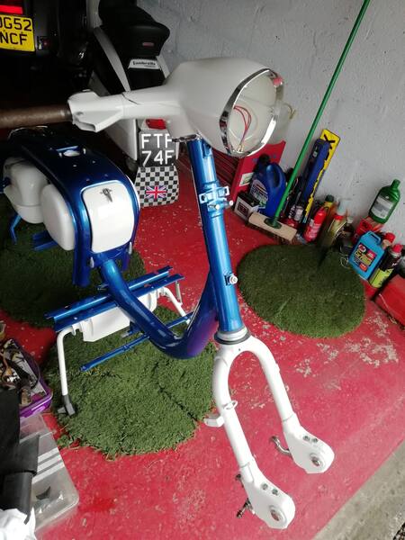

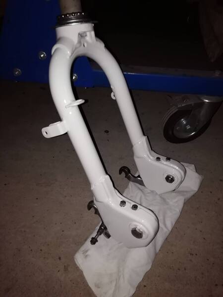

Forks now built up and ready to go. As is normal, it was a bit of a faff, but got there in the end without doing any damage.

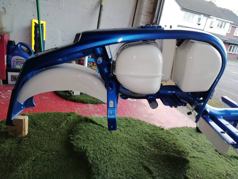

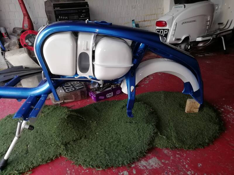

A little more time was found for this today - petrol tank, tap and air box all found their way back on to the frame.
When fully tightened, the straps were still slightly slack. This was remedied later on with larger rubber buffers.
Forks and handlebars now in position, I need to order in some more parts before I can get much further.

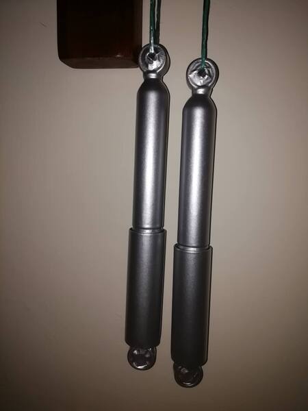

Dampers were then sprayed up after being bare metalled yesterday.
Got a few odds and sods to paint still, but will hopefully be getting the engine in some time next week. :)

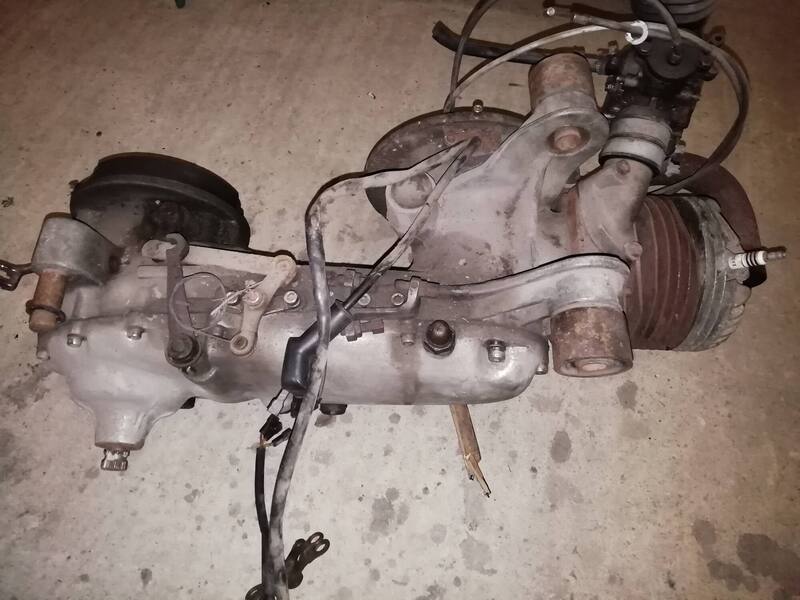

Made a start cleaning up the engine too. I'd originally planned a complete strip and rebuild, but theres nothing wrong with it, so a clean and spruce up will be fine for now. (gonna replace the carburettor though, the one on it is problematic)
Whilst stripping parts off to ease the cleaning process, I noticed that the gear shift tie rod was worn, giving a sloppy gear change. The elongated hole was welded up and re drilled, which should reduce the travel of the handlebar considerably during shifts.
Totally regret scrapping the frame that this engine came to me in - would have been an easy fix for me nowadays!
