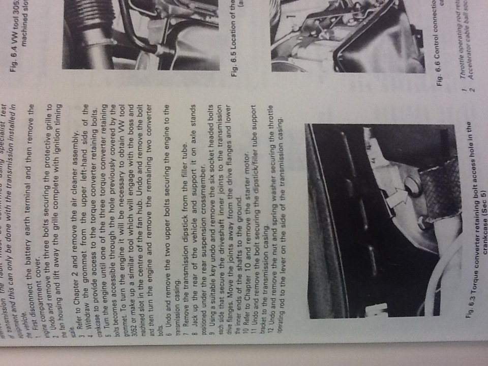

Just had a look at the Haynes for the aircooled version ''79 - 82 and it refers to a grommet in the crankcase.post-17481-0-67041200-1493327468_thumb.jpeg
I'll probably be doing most of the job on my own with trolley jacks and swearing and deep muscle damage, so the ratchet strap plan is a good one. I presume you split the engine/box just a few mm then slide the strap in before completely separating them?

Of course with the flat 4 the starter is on the gearbox side hence the access hole in the crankcase.
