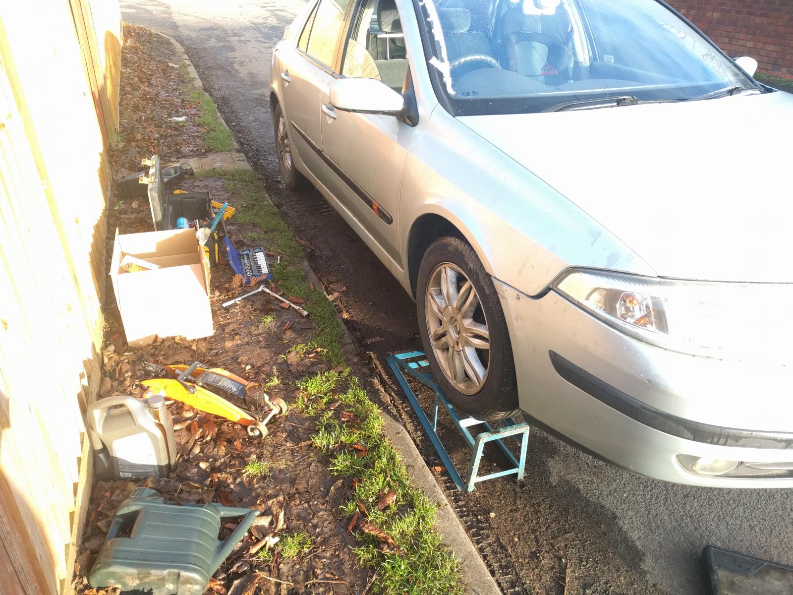

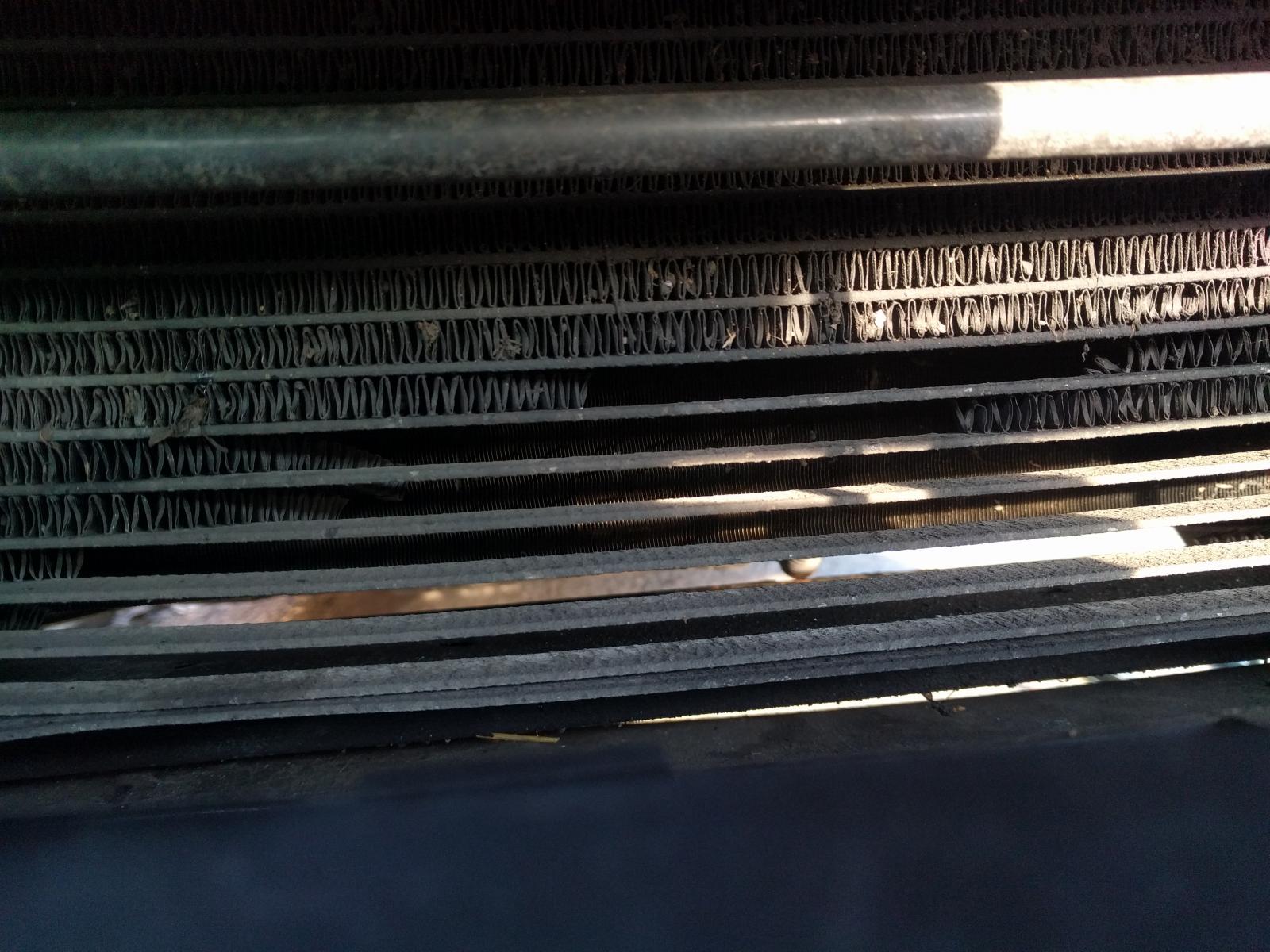

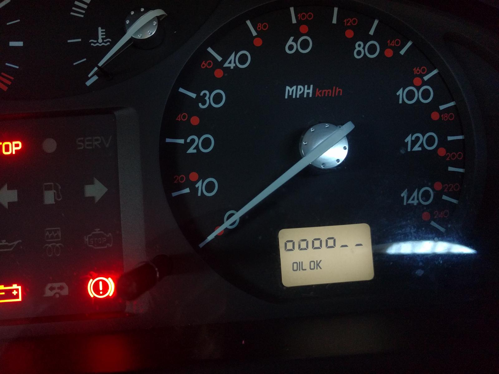

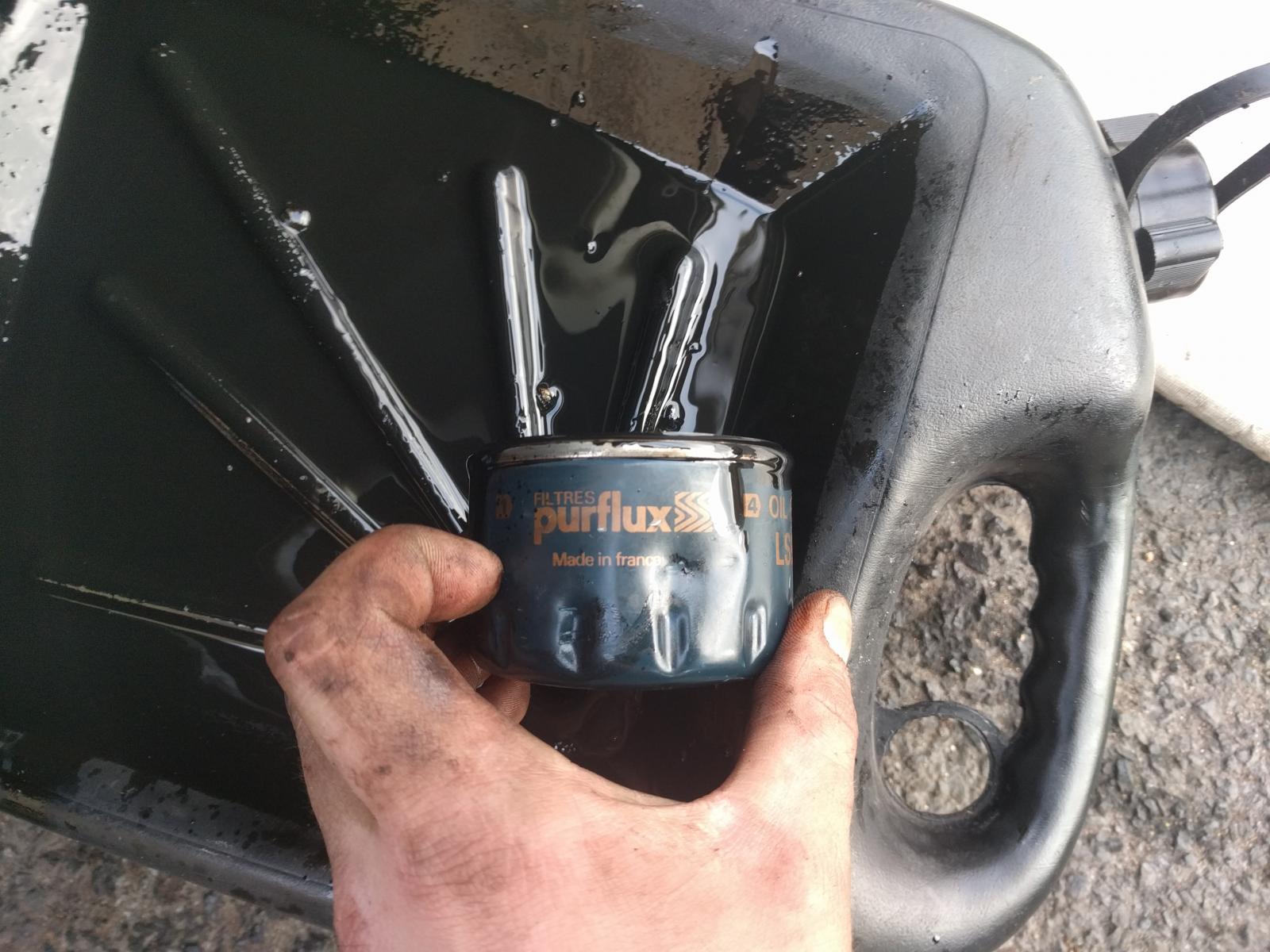

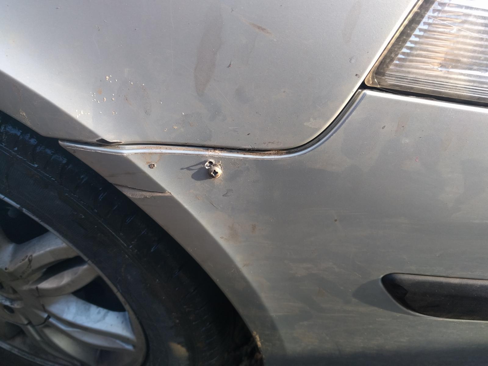

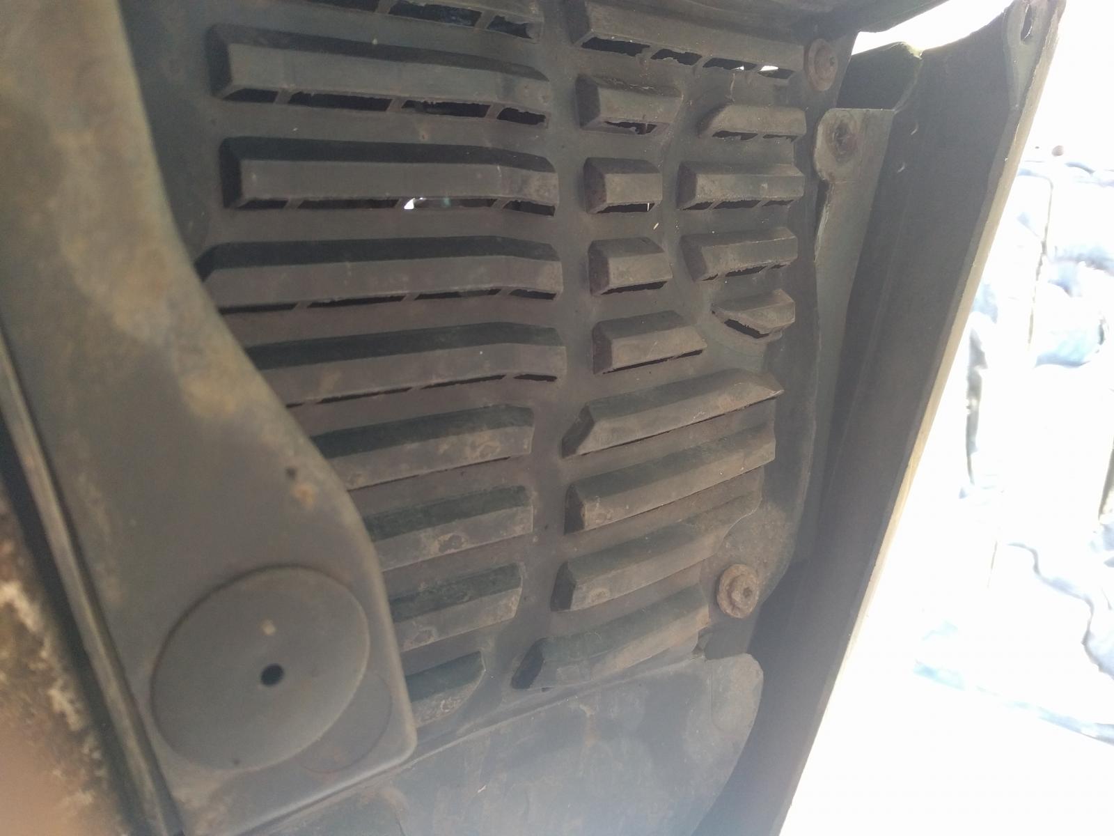

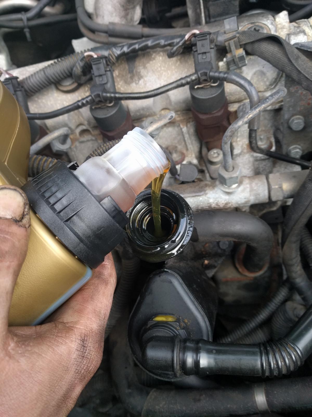

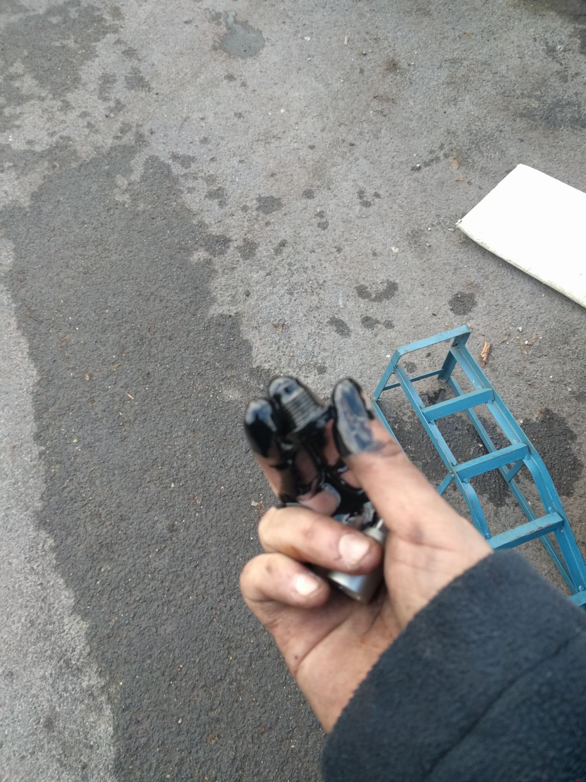

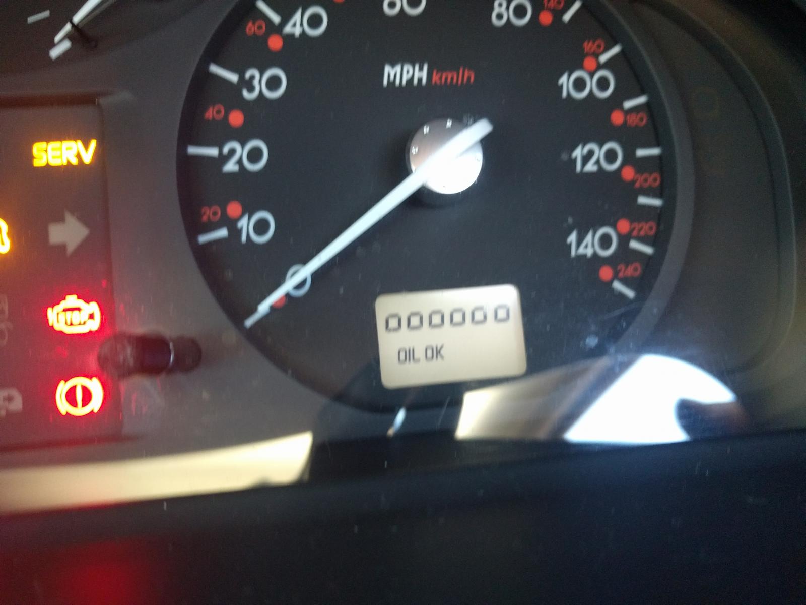

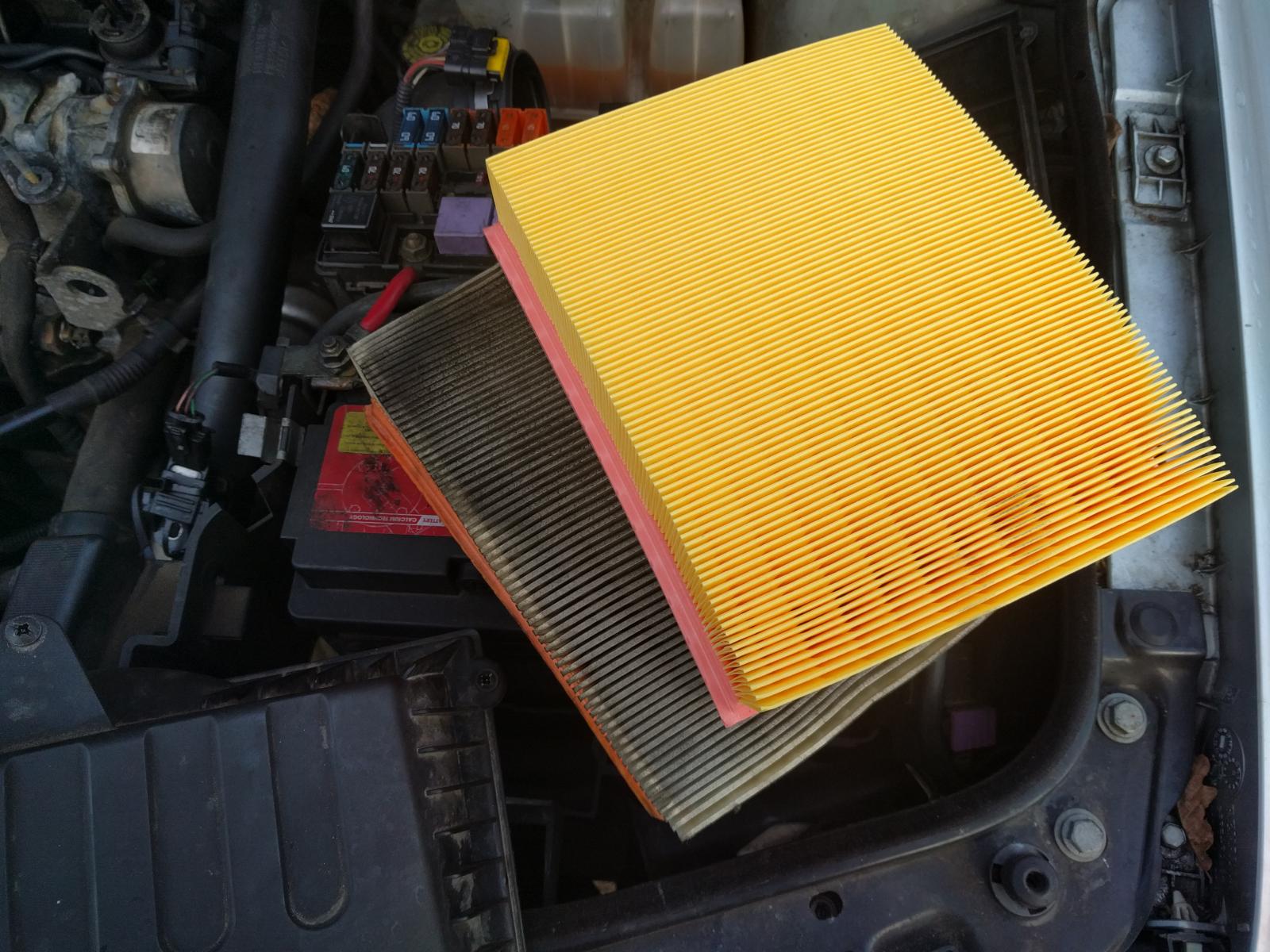

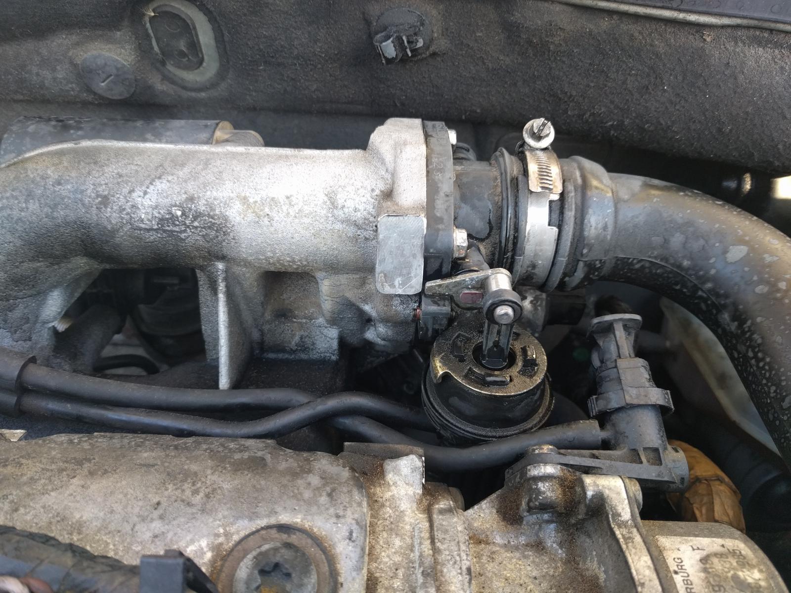

beko1987 Posted January 6, 2018 Author Posted January 6, 2018 Moar potterings today! I assumed the undertray removal position I then found the sump plug key I was given, and with an almighty shove it cracked off, and draining could commence. It was like treacle Old filter needed a helping hand with the chain wrench And after 20 minutes, I called it drained, and put the sump plug back in. What followed was 15 minutes of very carefully dribbling 4l of oil into this hole. Too much and it would back up and spill out, or the flow would move and piss over the side However, we duly had this on the dash, so I idled it for 5 minutes, then got on with another task Filters! The air filter looked a bit peaky when I checked the other day, so I ordered a new one Whilst underneath, I noticed that the bumper on the drivers side wasn't really attached at all And that these odd concertina things were littering where the car stood Ah, that'll be the air con radiator shedding then... Air con is still cold, so filed that under ignore for now Anyway, the underneath of the bumper was re-attached fairly easily This fixed the shut lines of the bumper to wing, so I repositioned my screws to hold this This bit is still oily, I gave it a blast of brake cleaner so it goes away After all this, the dash looked like this There's still oil left in the bottle too, but after someone scared me about runaway engines earlier in this thread, that'll do! The car is saying it has 6k until the service is due, I'm going to leave that counting down and do another change then, I've done 1500 miles so far roughly so that should be in a month or so Also noted the MPG of 48.7, incase it changes next week. I put £30 of fuel in earlier and reset the computers, will see what happens next week. I then filled out the little history book in the same manner the previous owner did And went to the tip, where the lumpy idle is still there, and the engine is quite loud on tickover. Meh The Moog and egg 2
Wingz123 Posted January 7, 2018 Posted January 7, 2018 Good work! Those lagunas have small oil filters Lumpy idle on these dci engines in my experience has been iffy injector. Had this on a 1.9 dci scenic and a 1.5 dci modus. When you drive it not noticable at all only when idling beko1987 1
beko1987 Posted January 7, 2018 Author Posted January 7, 2018 Good work! Those lagunas have small oil filters Lumpy idle on these dci engines in my experience has been iffy injector. Had this on a 1.9 dci scenic and a 1.5 dci modus. When you drive it not noticable at all only when idlingThat's 100% the symptoms! Might run some cleaner through the fuel and see what it does, it's had it before looking in the book. I presume it won't kill it quickly if I leave it a bit?
Wingz123 Posted January 7, 2018 Posted January 7, 2018 No I continued on for 15k miles without any trouble and it got no worse. I think I got injection fault on the dashboard a few times but being a laguna am sure error messages present themselves and make no difference to the way the car drives. Can you pick up a set of injectors cheap from asm? Though they don’t really do cheap in my experience! Lol
SiC Posted January 7, 2018 Posted January 7, 2018 If the economy is good and the performance is acceptable I'd leave well alone! Especially as injectors can get stuck, sieze in and other shinangans. I think the injectors on these would need coding in too. beko1987 1

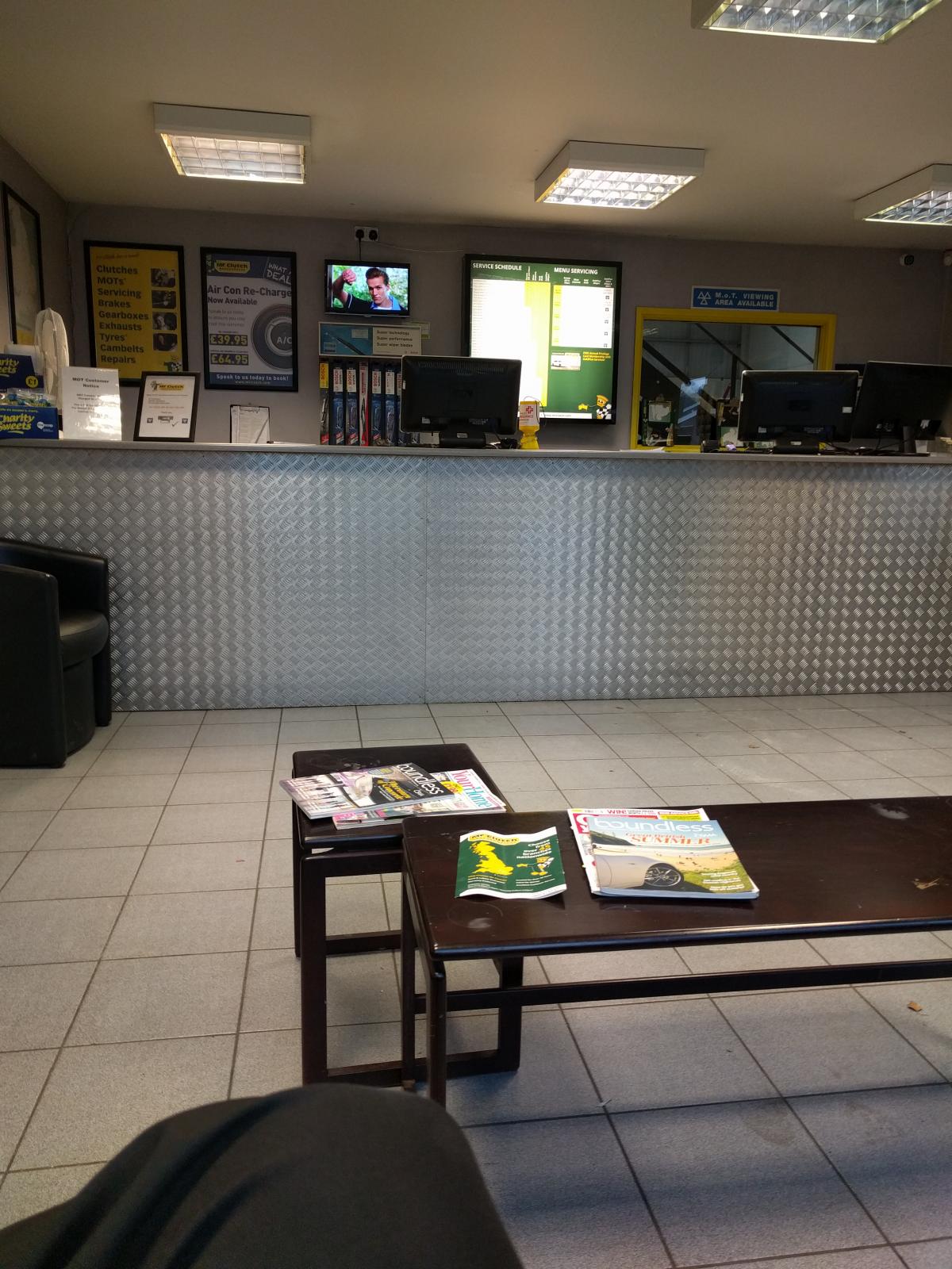

beko1987 Posted January 8, 2018 Author Posted January 8, 2018 It passed! Datsuncog, CGSB, clayts450 and 7 others 10
bub2006 Posted January 8, 2018 Posted January 8, 2018 Fucking yes. Out of all my cars I've only moted 2. Mmmmm. beko1987 and egg 2
oldcars Posted January 8, 2018 Posted January 8, 2018 It passed!Good pass as well, only one advisory Result. beko1987 1
beko1987 Posted January 8, 2018 Author Posted January 8, 2018 Yep, happy with that (back at work now). Inner tie rods, which I did on the old car. Difference this time is I have the tool to do them up (it came after I did the old ones) so I don't have to use molegrips and waterpump pliers this time. Since I've got the tracking done it might all undo now as well, so I should be able to thread count and get it roughly OK. I'll also buy a kit that comes with new gaitors too this time, that was a mistake last. A job for warmer weather though. He said the corroded brake pipe is fine, it's just at the surface rust/bubbly paint stage, which is fine! Ruffgeezer car sales a++++ would buy a cheap car from again! egg, 320touring and oldcars 3

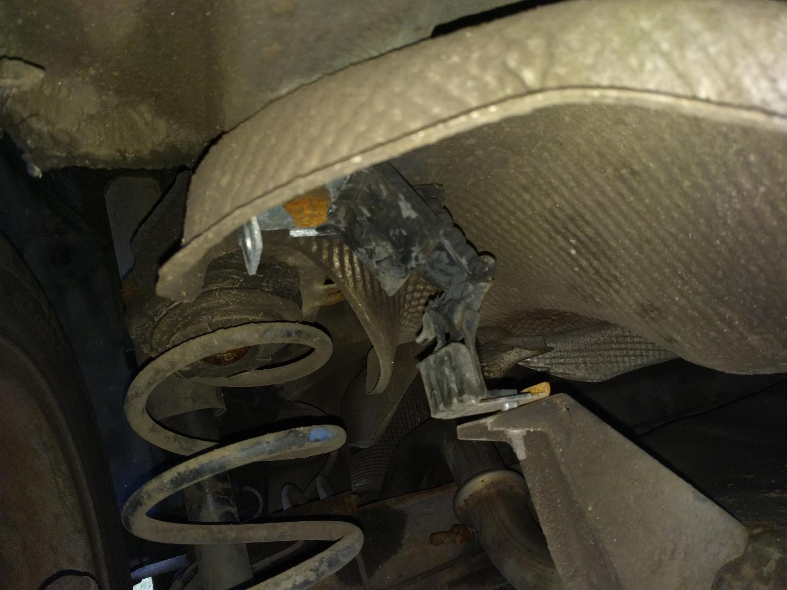

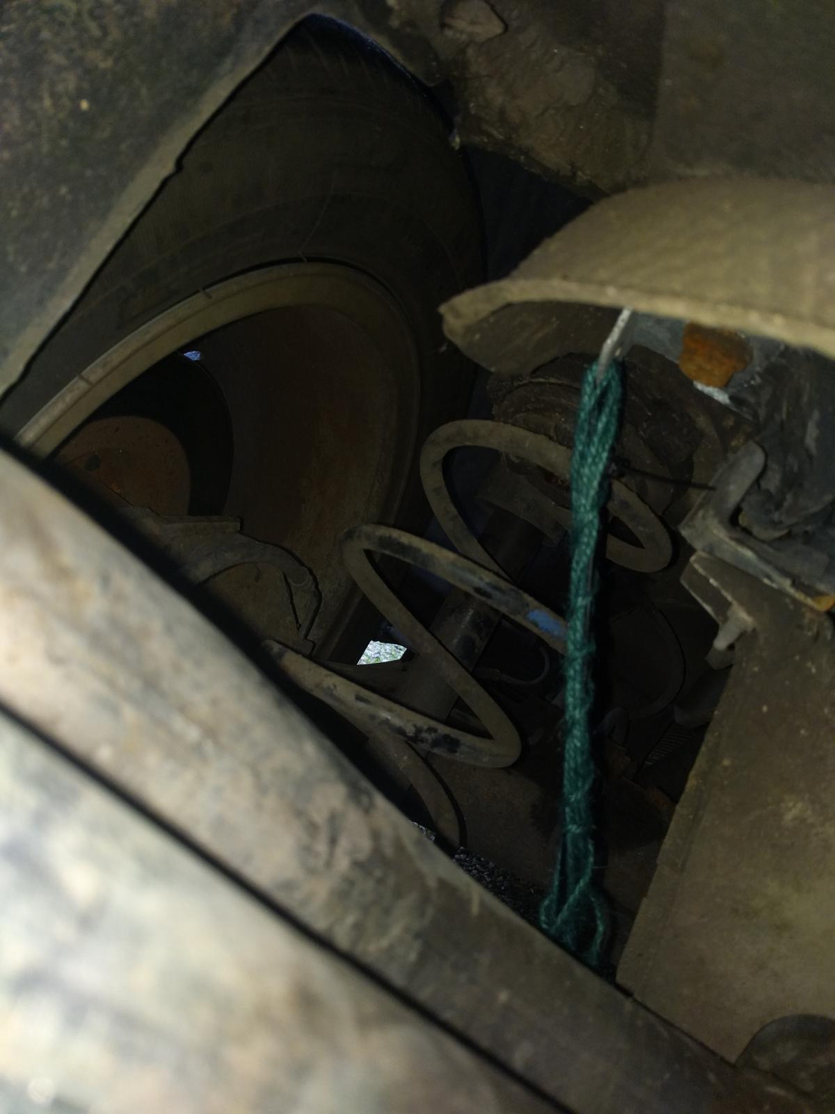

beko1987 Posted January 22, 2018 Author Posted January 22, 2018 Driving to work this morning, when cornering slowly, I heard a new noise, which is always fun on a Renault. 25 miles later at work, I had a look... Ah. That will be what the odd noise was somewhere near Swindon last night, which I ignored once I was sure I wasn't about to career off the carriageway... Was knocking gently on the axle... So I effected a repair to stop the whole lot crashing down at speed That's a big cable tie, then lots of garden twine to reinforce it a bit so the metal didn't snap the tie quickly. It pulled up quite a way and... The back end is much quieter! Still knocks a bit, but nowhere near as bad! One day I'll get round to buying new exhaust mounts... Datsuncog and oldcars 2
Guest Hooli Posted January 23, 2018 Posted January 23, 2018 I seem to recall they are about £12 a side at GSF. beko1987 1
