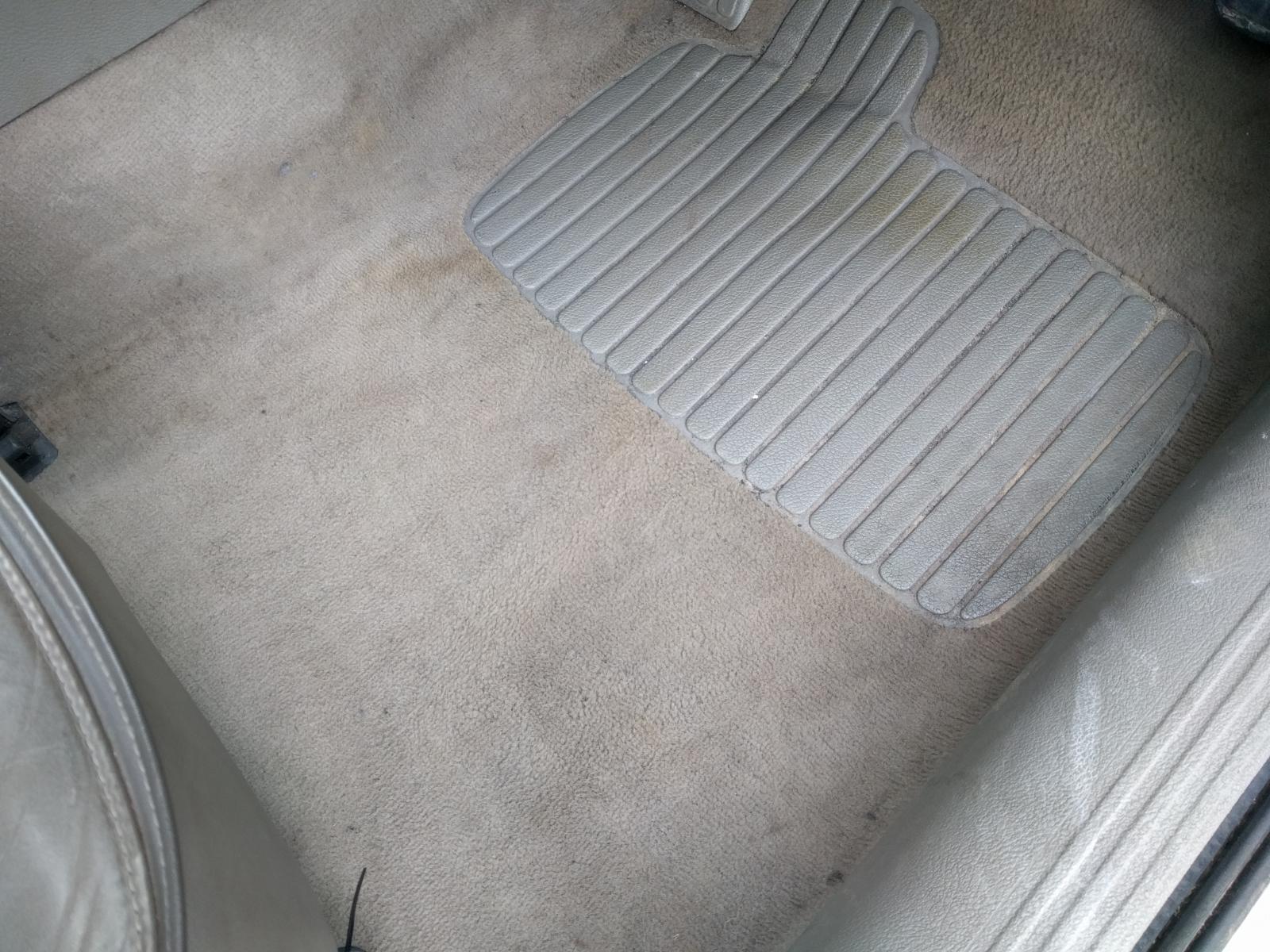

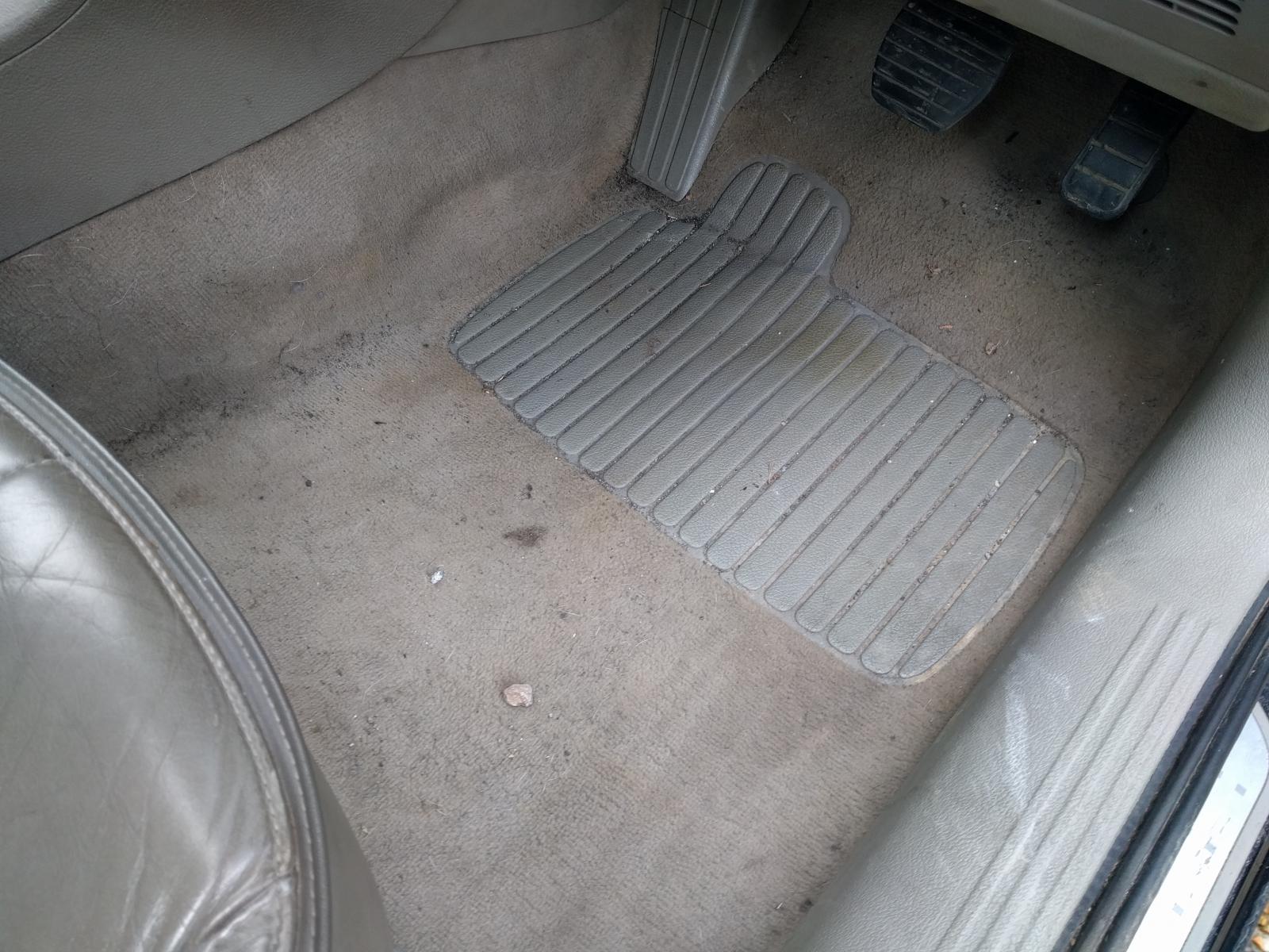

beko1987 Posted March 22, 2017 Author Posted March 22, 2017 I bought the vax over today, less powerful than the miele but it won't run as hot And after 30 minutes I had this small square a bit cleaner I need to empty the shed and find the big guns I think. The boot carpet is matted flat, and holding all the grit and sand. So I moved onto the drivers footwell Which came up much better with a quick going over It also used up 3/4 its header tank in water going home last night and back again this morning. Might keep water in the boot until I replace the thermostat and see if it's leaking from there or not...
