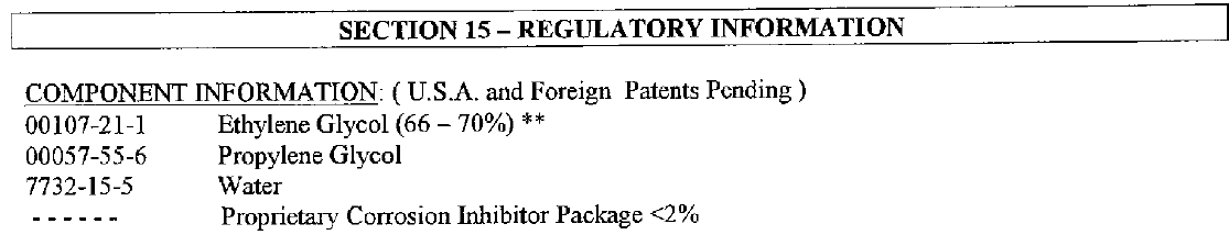

pshome Posted March 13, 2017 Posted March 13, 2017 Proper snake oil vendors they are... check out their pricing, the "powersports" stuff costs 20% more than the "high perfomance".Then check the spec sheets one by one and you will see it's all absolutely identical. Interesting read are the safety sheets.A recent one tells us the formula:http://www.hrpworld.com/store/media/media/manufacturer/evans/pdfs/EVANS-NPG+C%20-%20Evans%20High%20Performance%20Waterless%20Engine%20Coolant%20-%20SDS.pdf Ethylene glycol 80-85%2-Ethylhexanoic acid <1%Sodium Nitrate <1% that doesnt add up to 100%. An old spec from 2004 tells us what makes up the difference: http://contrails.free.fr/temp/NPG+_MSDS.PDFThe glycol content went up, but there is still 10% Water !! Surprising for a product advertised as "waterless coolant" Obviously their speak about the need to flush out the system and get all the water out is only to sell you their expensive "prep fluid". Final check, what is the "prep fluid" being made of? http://www.hrpworld.com/store/media/media/manufacturer/evans/pdfs/EVANS-PREP%20-%20Evans%20Prep%20Fluid%20-%20SDS.pdf Ethylene glycol 90-95%2-Ethylhexanoic acid <1%Sodium Nitrate <1% same stuff with less water... Vince70, M'coli, SiC and 1 other 4

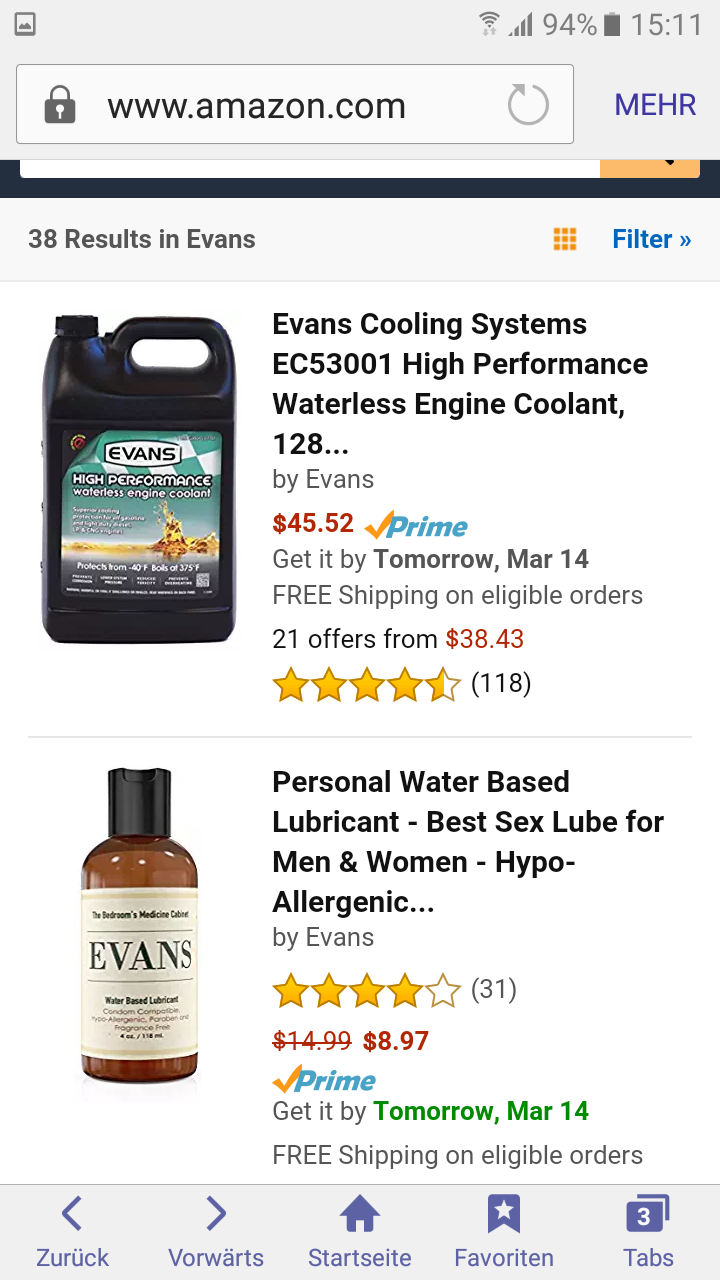

pshome Posted March 13, 2017 Posted March 13, 2017 Amazon finds other water based liquids when searching for "Evans" Vince70 and Magnificent Rustbucket 2
steveo3002 Posted March 13, 2017 Posted March 13, 2017 Amazon finds other water based liquids when searching for "Evans" Screenshot_20170313-151142.pnghaha they can stick it up their arse Vince70 and Richard 2
