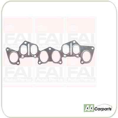

I've got an engine from a 1994 Pug 405 1.9d to go in my 2000 LDV Pilot. both have a 1.9 XUD dizzler engine. Should be a fairly straightforward swap BUT some exhaust/inlet manifold gaskets on ebay for the Pug engine have two big square ports for the exhaust manifold and seemingly the LDV has individual round ports. I haven't actually taken the manifolds off to check yet, the Pug engine has a big round thing attatched to the underneath, if that helps identification.
I guess if the manifolds cant be swapped about then i'll have to swap the heads instead.

Possibly a dumb answer, but the bolt holes and general shape of those gaskets look the same. I would get the gasket that matches the manifold and whack it on anyway?

The euro 2 Pilots, with EGR, used an exhaust manifold from a turbocharged XUD9TE and bolted the down pipe to the triangular flange. This manifold has the lower type gasket, the rectangular type will leak.
