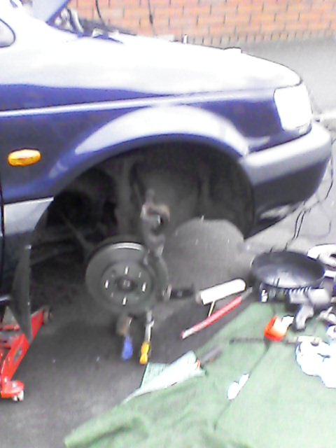

theshadow Posted February 16, 2017 Posted February 16, 2017 firstclass service from moog,his petrol station leaving picture,more pictures later,have upgraded the h4 headlight bulbs,had to remove the battery to do drivers side,them japs must have tiny hands,re corrision on rear,wire brushed both side,slapped some jenolite jelly on,will fill with metalik,than will spray on some black stonechip,bought some new freemax plus front discs,will be putting them on later today,, purplebargeken, Cavcraft, Skizzer and 3 others 6

theshadow Posted February 16, 2017 Author Posted February 16, 2017 discs will go on another day,just needed to put in new brake pads from spares pile,have filled the rear wheel arch,yes it seems very solid old bus,topped up with universal anti-freeze,screen wash topped up 50p stuff from former netto,oil filter change soon,got someone to do staff dicount at asda for 5 litres castrol gtx,10w 40m £8.00,greased all door locks,hinges etc,hope to under seal tomorrow, oldcars, purplebargeken, trigger and 4 others 7
theshadow Posted February 17, 2017 Author Posted February 17, 2017 new discs turned up today,changed the oil and filter,what i thought was the sump plug,was auto transmission,lost abit,topped back up through transmission dipstick,dexrons finest,done rear wheelarch,underseal tomorrow,see pictures.. trigger 1

theshadow Posted February 19, 2017 Author Posted February 19, 2017 if there fremax discs you can leave the coating on,no need to clean it off,seem to bed in quicker,good pedal feel,side light bulbs now upgraded,,now sprayed the gloop with black stuff,looks fine,its solid now,alba radio will pull out,must be faulty,lights up,but no sound,have managed to find a pollen,will get next week,does not need a cambelt kit yet,seems to have had gates kit fitted already..
