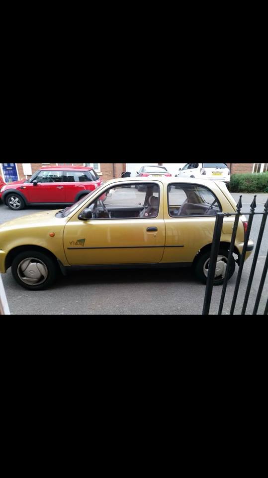

K11 Micra in Bedford - Free to a good home.
Not so much selling for a friend, as giving away for a friend. A much beloved K11 Micra that's failed it's MOT and is destined for the great scrapheap in the sky, but these little buggers get under your skin and she'd much prefer to give it away to someone if they can keep it alive.
Now I'm not as clued up as I should be about this particular car, but it's in Bedford and it needs to be gone by next weekend. Ask me what you want to know and I'll get you answers as soon as I can. I'd take it myself, but I can't weld and my wife would not be appreciative. Meanwhile here's some photos and the MOT history:
