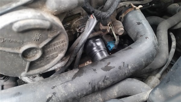

Guest Hooli Posted March 9, 2018 Posted March 9, 2018 Updatings! It's a hose. The hose off the side of the head to the heater to be precise, it's got a tiny hole just where the hose gets smaller after the connector. You can see a spot of water in the pic sitting on the leak, it sprays out when revved & the coolant pressure goes up. With the angle it comes out, it'll hit the wet bit of the bonnet & bounce onto the header tank, hence I saw more water there originally. So I'd best look on GSF tonight for a hose & check with the local breakers in the morning for prices.
SiC Posted March 9, 2018 Posted March 9, 2018 Doesn't look too bad. Can you get a bit of universal pipe in the mean time? Or is there enough pipe to cut it a bit shorter? I suspect it's getting to that age and mileage where the rubber pipes are probably going to start degrading.
Guest Hooli Posted March 9, 2018 Posted March 9, 2018 Nope it's not bad, it's about 1/4" or smaller. Unfortunately if you remember these hoses get bigger for the connection to the head & it's on the tapered bit so would be a bugger to join & I can't cut it short. Just means I'll have to get wet on the bike till I sort a hose.
SiC Posted March 9, 2018 Posted March 9, 2018 A few options here: https://www.neobrothers.co.uk/cooling-system-1368-c.asp
Guest Hooli Posted March 9, 2018 Posted March 9, 2018 It's the longer one of these https://www.neobrothers.co.uk/maptun-heater-matrix-silicone-hose-kit-9-5-98-09-no-heater-valve-5370-p.asp so £25 isn't bad for the pair at all. Ta for the link. SiC 1

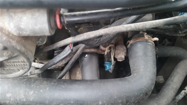

Guest Hooli Posted March 10, 2018 Posted March 10, 2018 Bodgery achieved! As no-one appears to admit Saabs ever need hoses (except the link SiC found) I was unable to get a replacement bit today, the local scrapper only has diesel 95s currently and GSF etc don't list anything. I did manage to find self-amalgamating tape though so after sealing the silly little split with gorilla glue & wrapped it in tape & run the car upto temp for 10mins. It seems to be holding even with the revs held up so the water is pumping faster. I'll order those silicon hoses but it looks like it's working until they arrive. I might have to invest in the proper tool for the bastidshitwankcunty TM hose clips as trying to get the end off near the bulkhead looks impossible enough without struggling with pilers. Pitchurs... The spilt, with fingers for scale The bodge, the lump in it is the gorilla glue Shep Shepherd, The Moog, Fat_Pirate and 5 others 8

Guest Hooli Posted March 11, 2018 Posted March 11, 2018 Well it works, 100miles to Bradford & back last night without leaks. At least I can use it till new parts turn up now. Exiled_Tat_Gatherer, Six-cylinder, The Moog and 1 other 4
