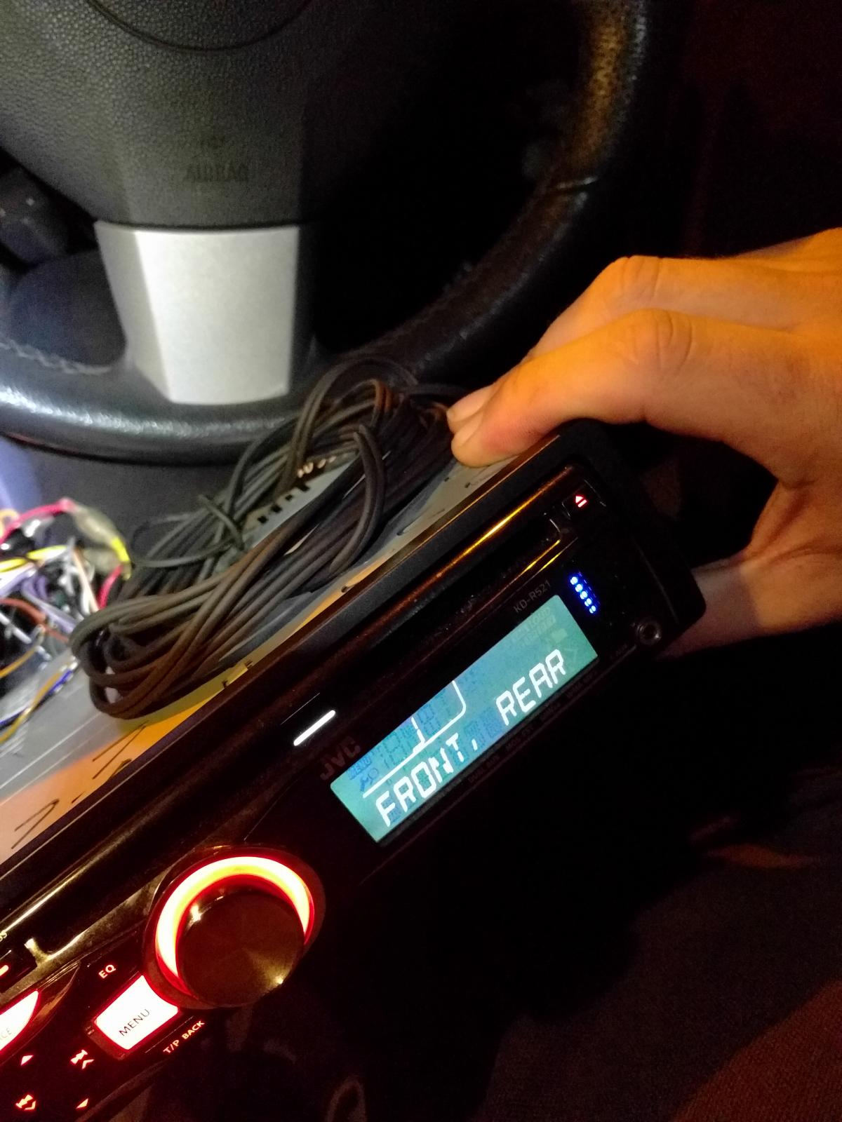

So this is plodding on, and apart from getting a nail in the tyre has had nothing do to it.
However, the cd30 stopped producing music. It worked, but no sound emerged. So I bought a cheap fitting kit
And as darkness started falling, had a go at fitting the jvc back in.
Reading forums, apparently the only switched live on the car lives in the fag lighter loom, and takes the light up ring if the car has the smokers pack fitted.
There it is!
I took the vauxhall unit out, and did a test run. 15 minutes of head scratching ensued before I remembered I needed to connect the Bluetooth dongle to the wires to make the connection. I twisted it all together and
It lives! I ripped the dashboard apart to turn the switched live lead down to the ciggy lighter
And sadly didn't have a nice spade terminal so chopped and crimped it together
Wrapped up the 4 miles of cable and stuffed it behind the dash to the right, and fitted the shit faceplate
Done! Sound is back. I'll set it all up later, I got told off for taking so long, and resisted the urge to be childish and take a hammer to the dashboard so came in and did the washing up... Hopefully it'll catch fire when it's just amy in there or something.
Just been back out to set the unit up, turn off demo mode and other button pushing, and the cars computer still works! The screen still does what it used to, bar the audio stuff. Glad I didn't bother spending out on the expensive canbus adapter now!
It also sounds much better, even through the stock speakers. Hope the new head unit I want for the gooner is this simple!
