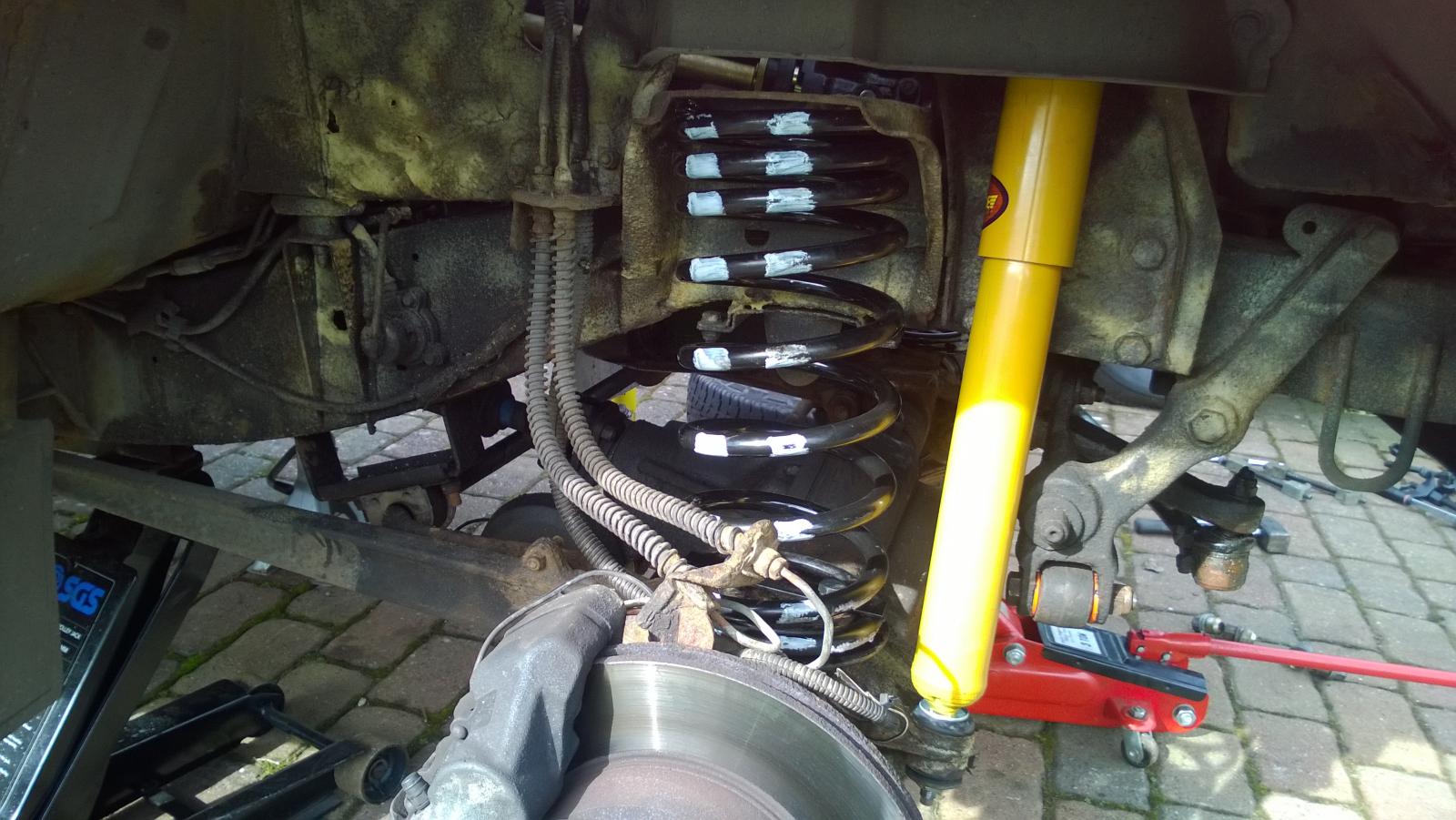

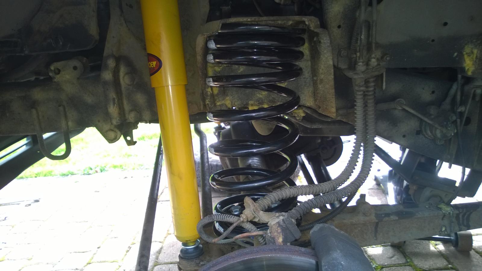

TL:DR I have fitted front springs without the 2 inch lift and new shocks, but ran out of time to do the rear so have comedy 70s Escort Van stance.
Also it didn't rain despite me spending most of the weekend outside lying under a Range Rover.
Parts
Pre-ftting view

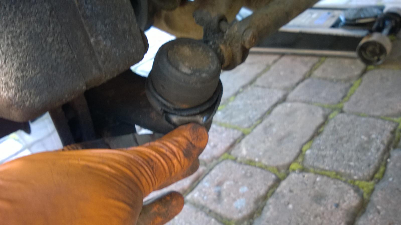

After jacking it up I found what I think may be the source of the steering knock - this TRE has a split boot and I think I could feel a little play in it -

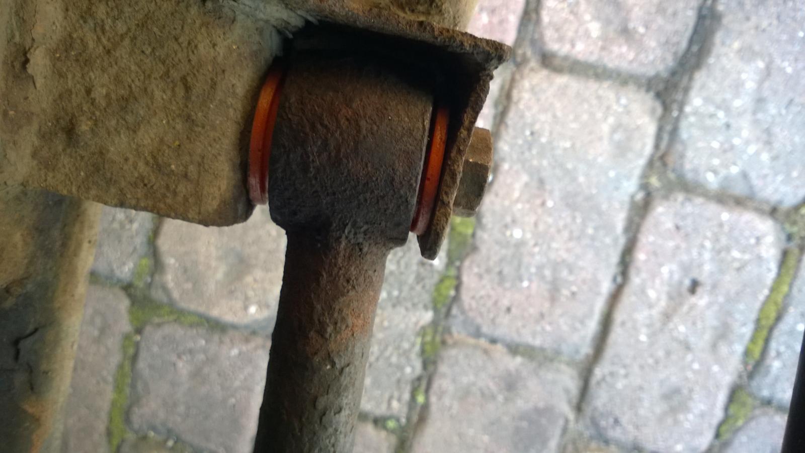

Someone's done the Panhard rod with Polybushes already

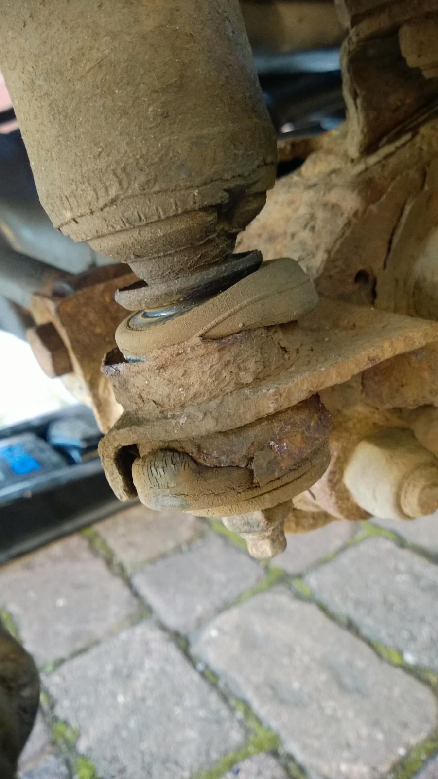

Old shocker bushes past their best -
The front springs had a 2 inch lift plate fitted - as far as I can see the springs are standard length apart from that - very similar length to the replacements.  They were colour coded (Blue and white or possibly silver) but nothing I can find on t'internet tells me what they are.
Old spring still compressed - new front ones are white/white - again confusing stuff in the instructions which says they are yellow/yellow and on t'internet which says lots of things.

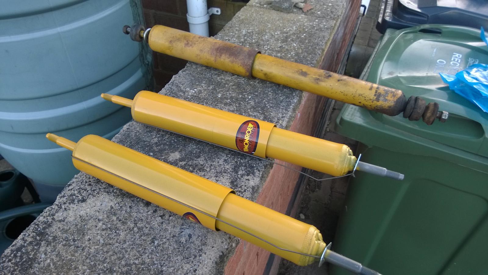

Meet the new shocks, same as the old shocks - which means ( I think) whoever fitted the 2 inch lift didn't fit 2 inch longer travel shocks.
Job done
New comedy stance
It doesn't drive any differently.

How well did those old shock absorbers come off?    I find it easier to cut them off than undo the bolts.
iirc rangies have different spring lengths longer left than right cos road camber- hence the paint marks
I have read a lot of conflicting stuff about OEM springs.  Paint marks are used on all sorts of chod - my old ALDI A3 had 'em and they are the same on each axle.
One thing I'm also unsure about is whether the coil sprung versions of mine that were made at the same time had the Boge strut at the rear - mine doesn't as it was on air originally.  The boge struts seem to be virtually unobtainable now as far as I can see.
They are on the Defender - mine sits a lot higher on the drivers side when parked, but it levels up with something heavy (me) in the driver's seat.
As above, I suspect mine should have different spring rates on each side - but reliable info. is hard to come by.  I would like the softest possible springs but I think no-one sells anything that isn't heavy(ish) duty now.  I notice the ones I've got are variable rate but the ones that came off aren't.
The old shocks were a sod to get off, but I couldn't get easy access at the top to cut them off - I think if doing it again I might release the tops first, as it'd be easier to cut the bottoms off.
Ideally, I'd have preferred to change the shock mounts to the coil spring ones rather than keep the air ones but I also wanted to get on with the job.

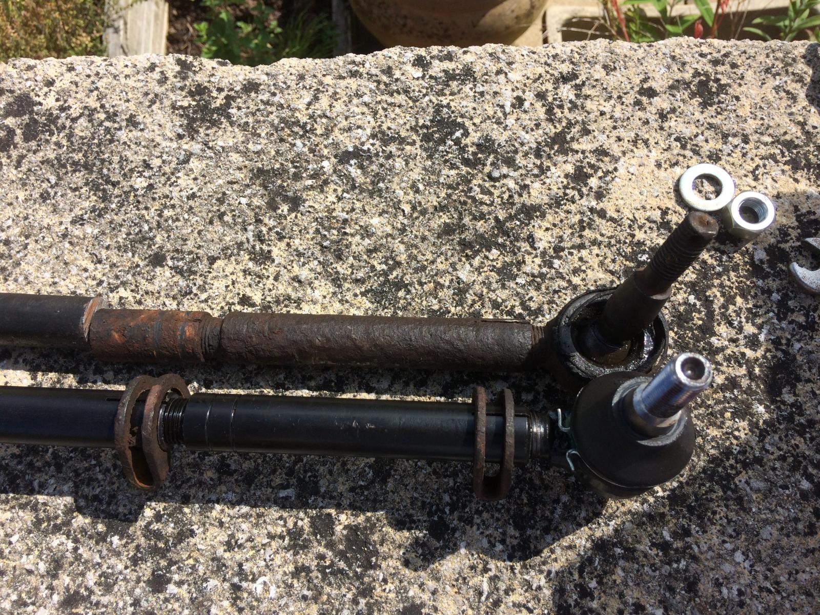

The death wobble came back.
Round about then I remembered the three track rod ends I'd bought a while back, so I decided to have at it.
It only took ...ages, but I removed the track rod.  I foolishly thought I could take the track rod ends out an replace them - no chance!  No amount of heat, force etc would do it - and then I remembered new track rods aren't ruinously expensive.

Keep your old trackrod. Once you cut the ends off you can shove it in a fire & put an airbed blower on t'other end & make your own furnace.  Not that we ever did this in Wales & ended up around the fire in t-shirts as the snow fell...
I like the sound of that!  I already had it marked down for use to give extra ummmph to my t-bar socket wrench.

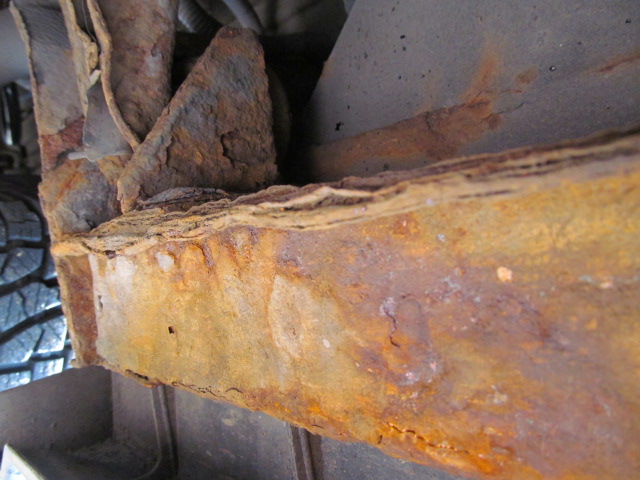

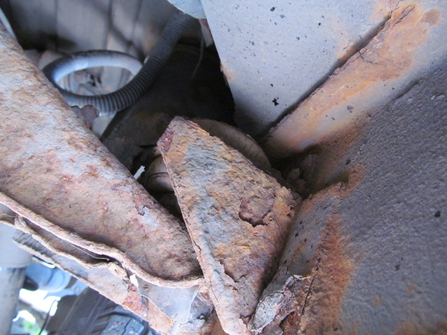

Unfortunately I noticed there's a lot more rust in the sills than I thought there was.  I highly doubt it will pass another MOT like this

Looking smart!  The sills look like they're 'about ready'; there's a few options nowadays instead of replacing like for like, for example chopping the lot out and using box section welded to the outriggers that attach to the floor.  You could probably have them patched and tarted up for now though, just to buy another year's MoT.
