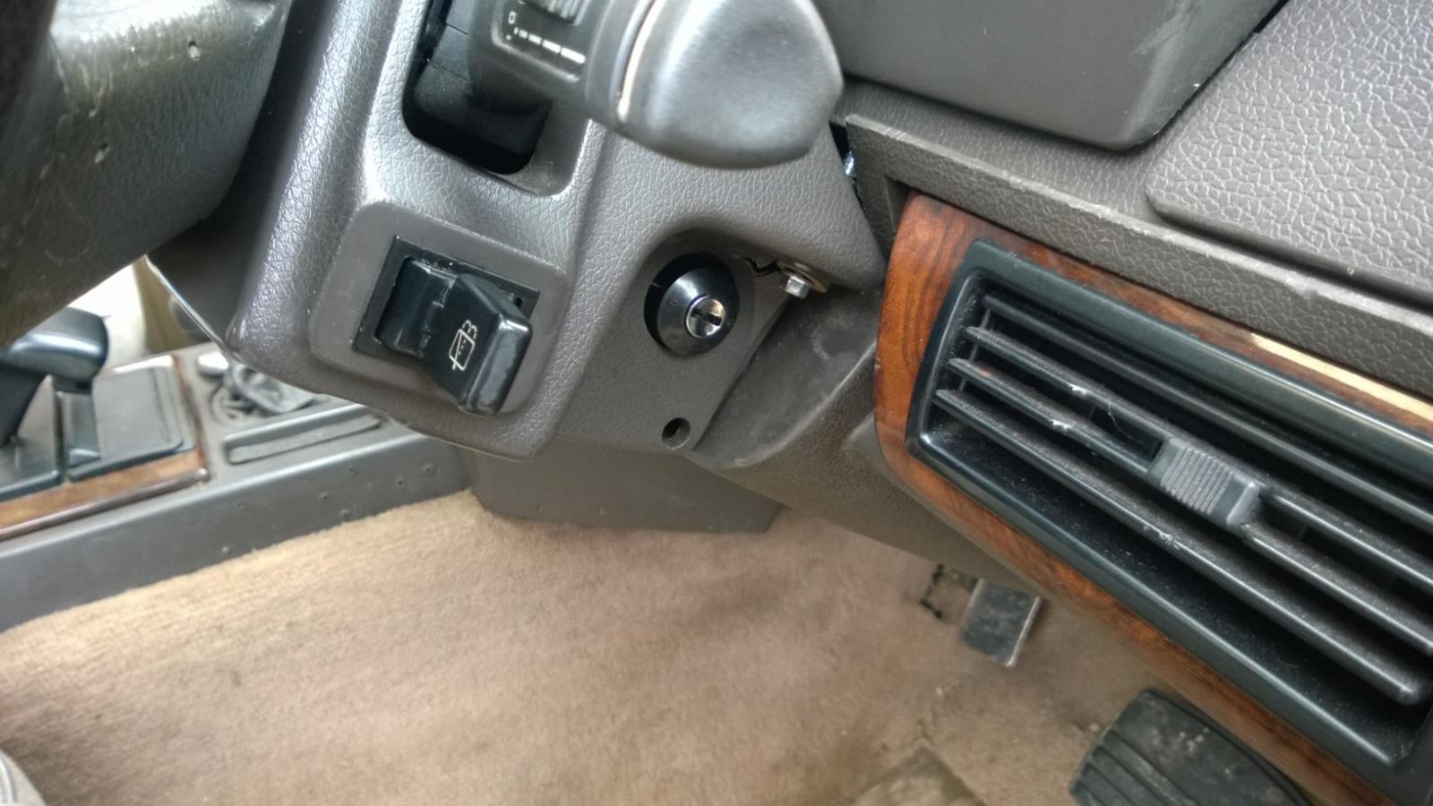

So today I decided to fit the new steering lock I bought a while back.  Upon removing the old one it was apparent why the barrel drops out occasionally - there were no tumblers in the lock mech at all.
It put up a decent fight against removal but I won in the end although it did mean dismantling most of the interior of the car.

And here it is resplendent with new steering lock -
