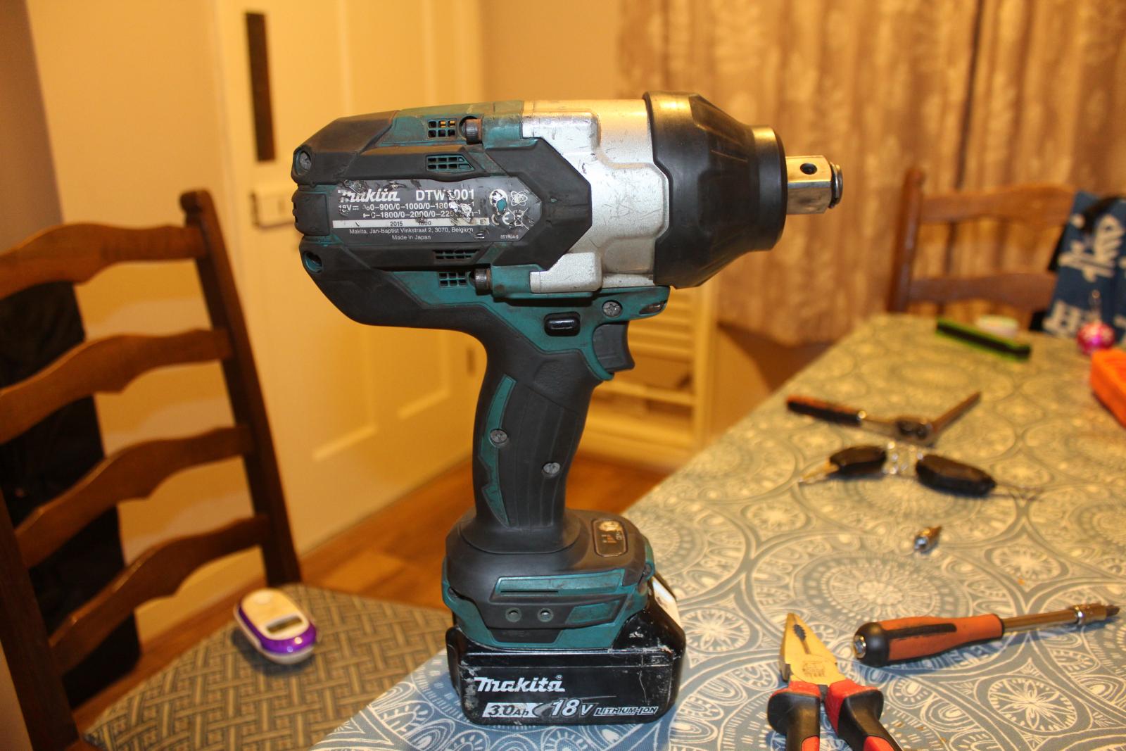

Today was particularly exciting because the Yodel lady brought me this.
Fuck. Yeah. This is the DTW1001, the most powerful 18v impact wrench that Makita make. It's 3/4 drive for ultra manliness. It can loosen nuts tightened (by Beelzebub himself) to 1700Nm. It weighs nearly four kilos and retails at over £200. This, my friends, is skookum as frig.
Only one small problem - it doesn't work. Well, it was "untested" supposedly, which as we all know means fucked m8. Hence it was mine for £73 posted from ebay.
I bought it, of course, in the hope that I could fix it. Parts are readily available for the LXT range. It could be anything from a broken connection (£pence to fix) to a trigger (£30, common issue) or - worst case - it could be a fault in the controller unit. That's £190.

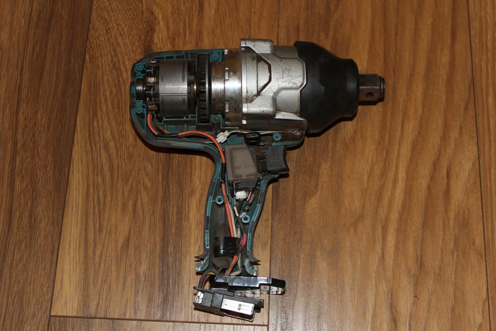

No time to waste, take the side off.

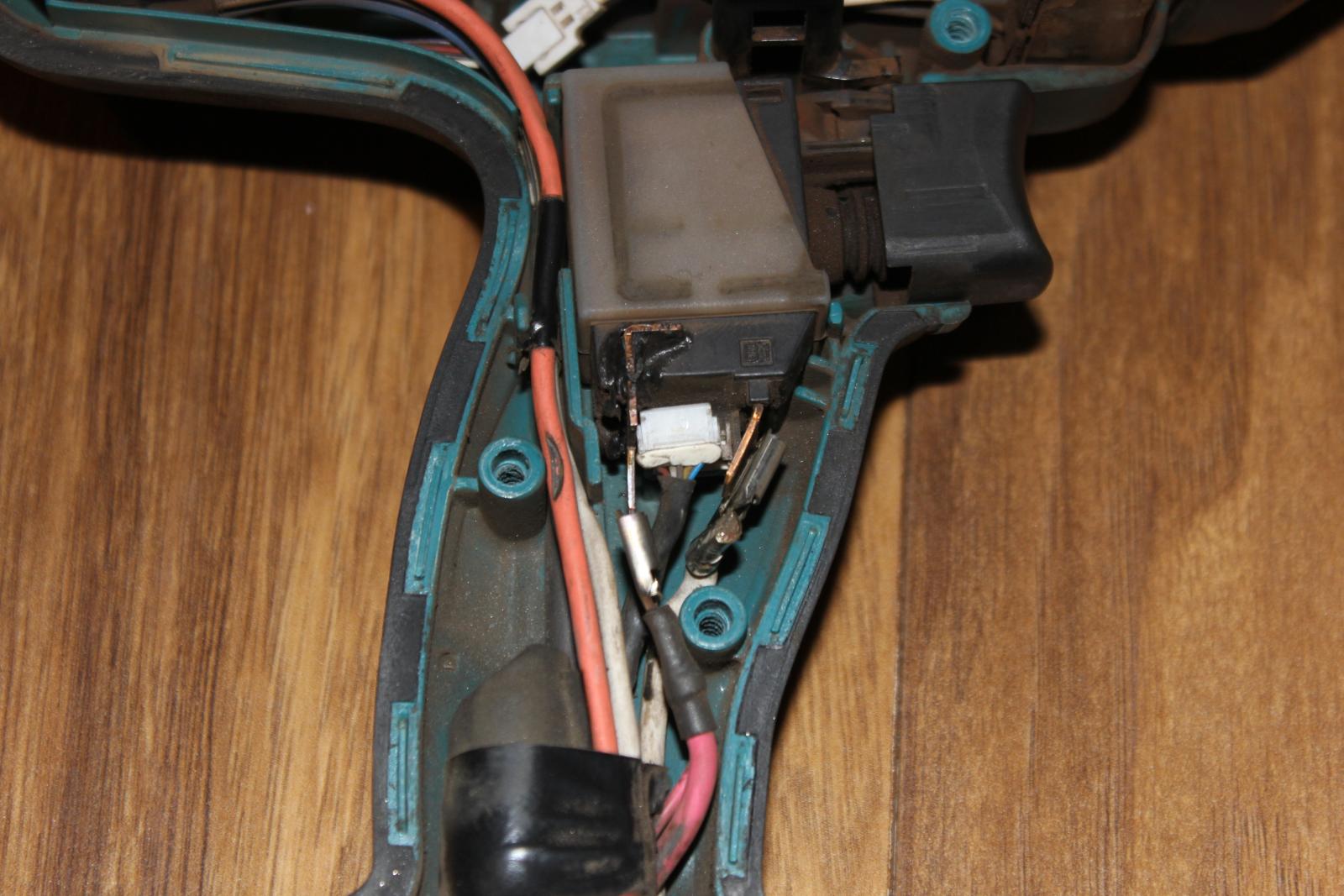

Mm, crusty. Lots of minging dirt, presumably brake dust from the many wheelnuts this thing has stripped bare. But wait, what is this?!
Look closely. The spade connectors are off the trigger. Presumably they'd been disconnected because some other bit is comprehensively fucked. Nevertheless I connected them back up and squeezed gingerly. Holy-o-fuck, it goes round and round! It rattled like a bastard, but I quickly remembered this would be because the casing locates the rear bearing on the rotor, and with half the casing off it's too free to move.

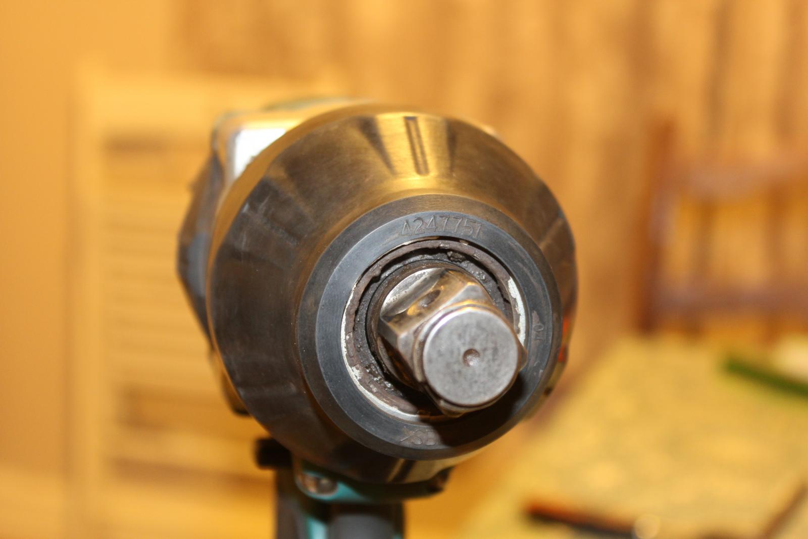

I gave it a quick inspection. It could probably do with a complete strip down and regrease. There's about a mm of play in the hammer, and I don't know if this means something needs replacing; could be the hammer casing or the hammer itself, though the latter is unlikely because it's super hard. There is no front bearing, the hammer just runs in the casing, so if there's been swarf ingress the casing could well have been worn away.

The electric smoke seems to have been trying very hard to escape from the trigger, so it may need a new yin before long.
You're right. It has got a bit hot. I'm going to strip it down and service the gearbox/hammer side of things; if that's all OK, I'll give it a new trigger.
