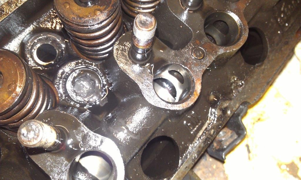

Royale80 Posted February 23, 2017 Author Posted February 23, 2017 Head now off- nearly killed me lifting it out-it's a bit heavy. Now to get out the camshaft-anyone know if theses hexagonal bolts need to come off to get it out? Will have to come up with an idea on how to get the head back in-may need to rig up a pulley. Steve Banger Kenny, Magnificent Rustbucket and Sigmund Fraud 3
Joey spud Posted February 23, 2017 Posted February 23, 2017 No them plugs are nothing to do with holding the cam.I remember doing a 4 cylinder Manta head gasket and that head was heavy enough and i tried refitting it on my own and managed to trap a finger under the head when guiding it past the cam chain cog and had to yell for help to get myself free. So yes i think assistance or hanging the head from an engine crane is advisable. The Reverend Bluejeans, Magnificent Rustbucket and Royale80 3
Royale80 Posted February 23, 2017 Author Posted February 23, 2017 Thanks Joey,I think it levers out-will have a look tomorrow. Definately need a few more people to put it in (!). It's a lot harder to position going in and it was bloody heavy getting it out. Steve

Jimbo Posted February 23, 2017 Posted February 23, 2017 The cam pulls out from the front or the back of the head after all the lifters are removed and the end covers removed. there are some plastic thrust pads in the ends of the cam that rub against the sheet steel covers either end. It's been 30 years since I stripped one of those but that how I remember it... Royale80 and saucedoctor 2

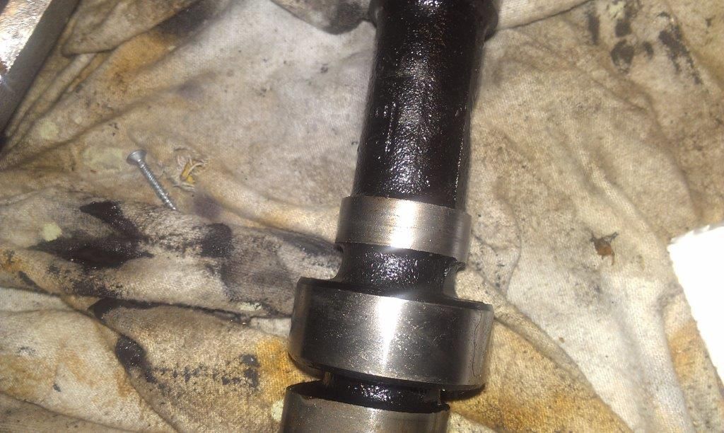

Royale80 Posted February 23, 2017 Author Posted February 23, 2017 Thanks Jimbob,Will have a go tomorrow and hopefully post a photo of the old cam. Steve
Jimbo Posted February 23, 2017 Posted February 23, 2017 A footnote the cam runs in white metal bearings be careful not to damage them with the lobes when pulling the cam, top tip stand the head on its end to pull the cam out. When we used to fit hot cams in these engines there used to be a small spacer to fit in the oil return gallery to increase the oil level in the head this stopped the cam wear. Magnificent Rustbucket and Dick Cheeseburger 2
Royale80 Posted February 24, 2017 Author Posted February 24, 2017 Thanks Jimbo,Cam now out-one of the lobes is nearly circular-no profile at all! Steve Lacquer Peel, alf892, danthecapriman and 7 others 10
Joey spud Posted February 24, 2017 Posted February 24, 2017 I had a V8 Range Rover with cam lobes like that.It made a massive difference to torque and mpg once it was replaced. Royale80 1

Squire_Dawson Posted February 24, 2017 Posted February 24, 2017 What on Earth were GM making these camshafts out of? Still, you could say ~60,000 miles is fair for a top overhaul. Royale80 1
twosmoke300 Posted February 24, 2017 Posted February 24, 2017 I think it was as much to do with oil quality back then Royale80 1

DodgeRover Posted February 25, 2017 Posted February 25, 2017 What on Earth were GM making these camshafts out of? Still, you could say ~60,000 miles is fair for a top overhaul.Mk2 Cavaliers from the same period used to be notorious for chocolate cams at one point as well. CreepingJesus 1
Jimbo Posted February 25, 2017 Posted February 25, 2017 I think the problem stems from extending service intervals but still using old fashioned oils. Looking back to those times OHC engines did suffer with cam wear remember pinto oil spray bar clogging with oil sludge. Was never a problem with OHV engines with pleanty of oil flying about in the crank case over the cam.
saucedoctor Posted February 25, 2017 Posted February 25, 2017 Although, a mate's Fiesta 1.1 rounded a couple of lobes. Not something I've heard of too often, to be fair.
Squire_Dawson Posted February 25, 2017 Posted February 25, 2017 Well, overhead cam engines have been around since the early 20th Century and they didn't go like that. So it points to poor design or materials on the part of the manufacturer. But forumites have said aftermarket cams are good, and Steve is doing a great job with this car, so all is hunky dory. Royale80 1
