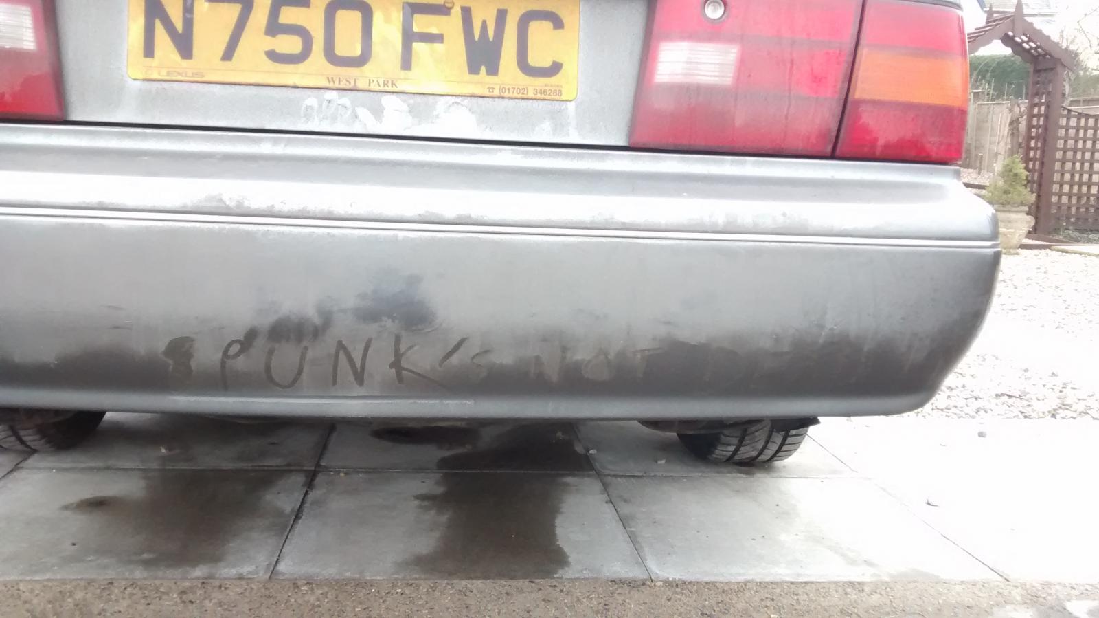

It hasn't been washed though, so PUNK'S (still) NOT DEAD.
