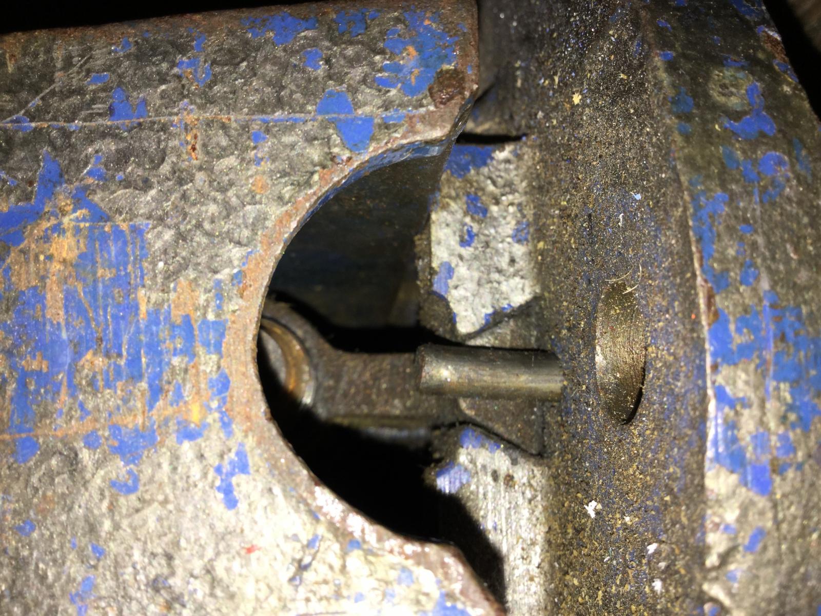

Underneath there is a pin that stops the Vice from opening farther than it should... knock this out with a drift. You can spot it from underneath...
As you withdraw the thread you can see the missing washer and the fucked split pin. Started degreasing with some 'Elbow Grease' - a surprisingly effective machine degreaser you can get in cheap shops. Whilst the Vice is apart I have some black enamel. Should I stick with the battered finish or give it a coat of paint???
