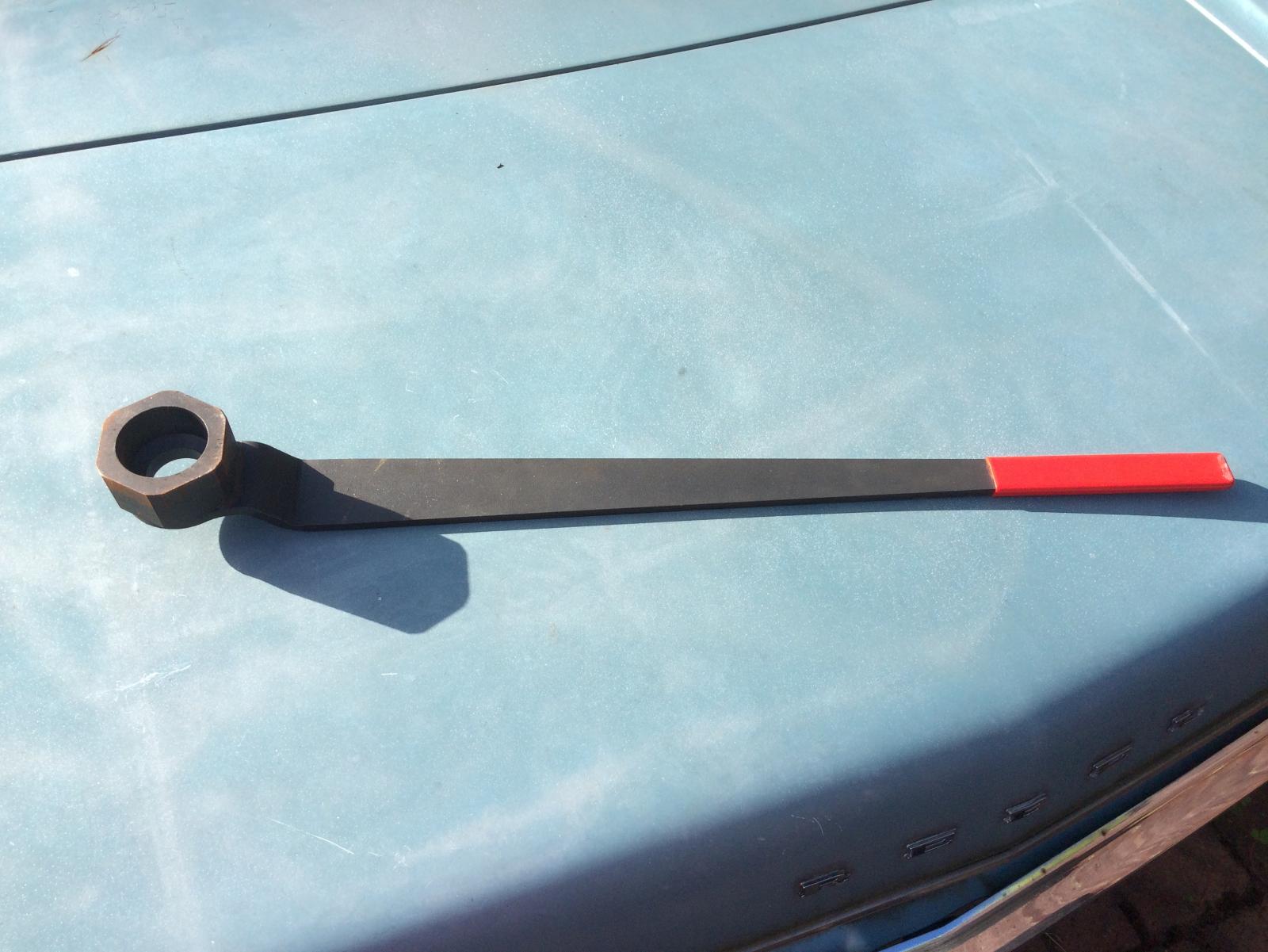

I need to do the belts on my 45 V6 soon. Is there a crankshaft locking tool available? I always struggle to get the crankshaft pulley bolts undone on these cam belt jobs.

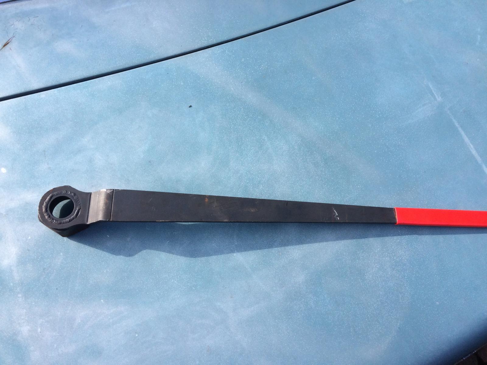

For Mr B and others, the offical(ish) crank pulley tool. I can't lend this to anyone as it isn't mine and it's overdue for return. A bloke on the Rover forum made his own.
That looks very similar to a Honda crank locking tool
<ted> oh well now I woudln't know about that sir </ted>
I can measure this one before it goes back I guess
It might be handy if they are the same size.
