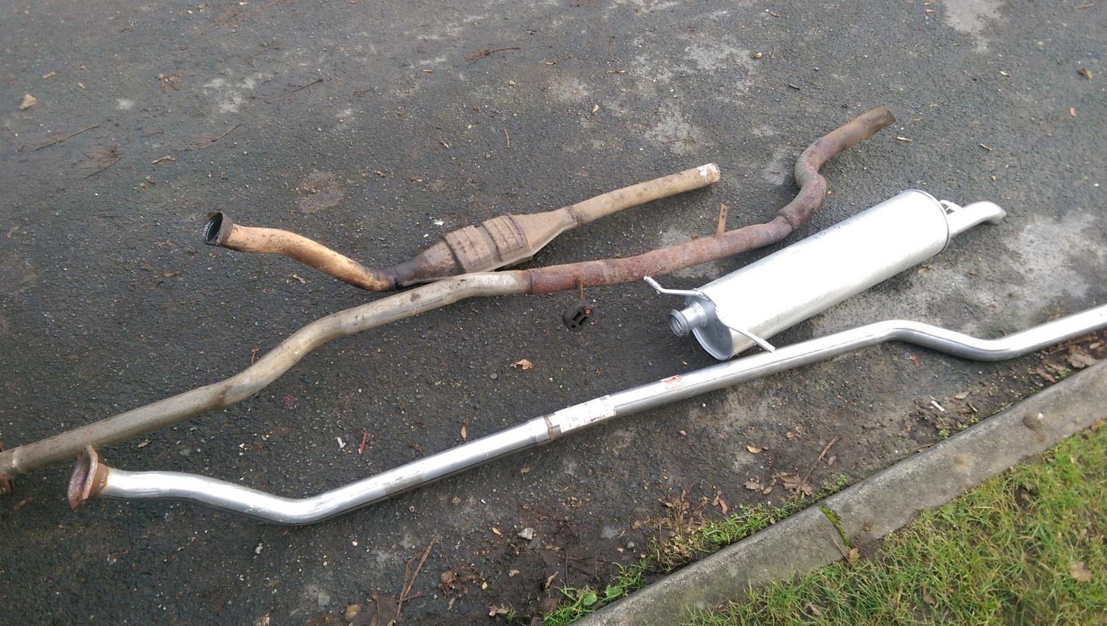

beko1987 Posted December 9, 2016 Author Posted December 9, 2016 The action turned up at 08.50 this morning, and by 11am I had this Big hole blown in the weld just before the cat case, which probably explains why it sounded quite shit. The new one went on very easily, all fitted perfectly and sounds silent! It's bliss. Gonna ring the garage up in a bit and see if they can have it in tomorrow for a re test Its alot easier to fit an exhaust to a 1.9td xant than a 1.9td zx, loads more room to get to the tops of the bolts and then hold everything in place. One of the spring cups had seized onto a bolt, which is why that bolt was always loose. Bfo screwdriver from the top had that off, and it all nipped up nicely on both sides Dick Cheeseburger, vulgalour, The Moog and 8 others 11

beko1987 Posted December 9, 2016 Author Posted December 9, 2016 All I plan to do now is loosen the throttle cable a noth or two so it wont rev as high, then drive to somewhere pointless before the MOT then to the mot place, maybe stopping around the corner for one last redline, then it's down to the shite gods I think! Would the big hole have affected the readings at all?
oldcars Posted December 9, 2016 Posted December 9, 2016 Good luck for tomorrow. I would guess a holed exhaust would affect the reading yes. Plus the new one will be clean and not sooted up. beko1987 1
