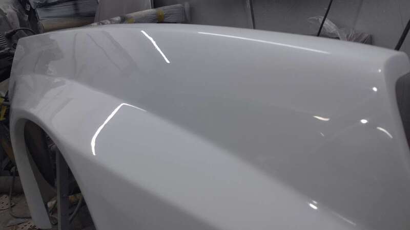

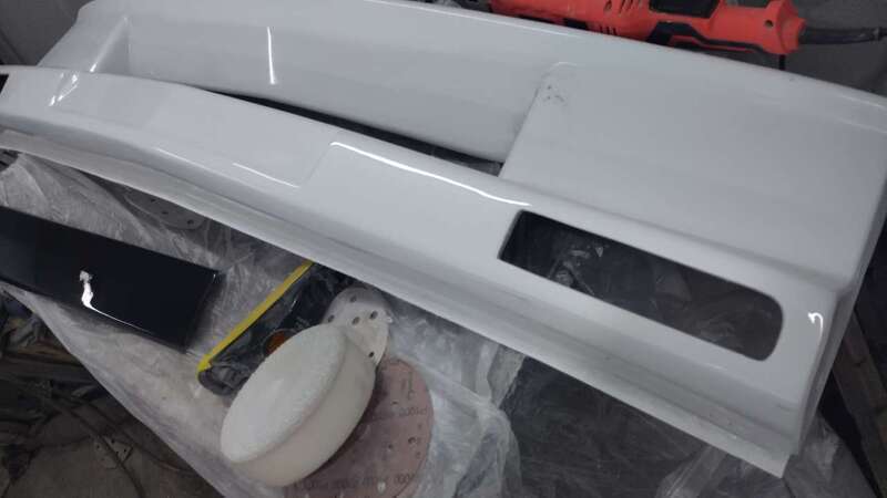

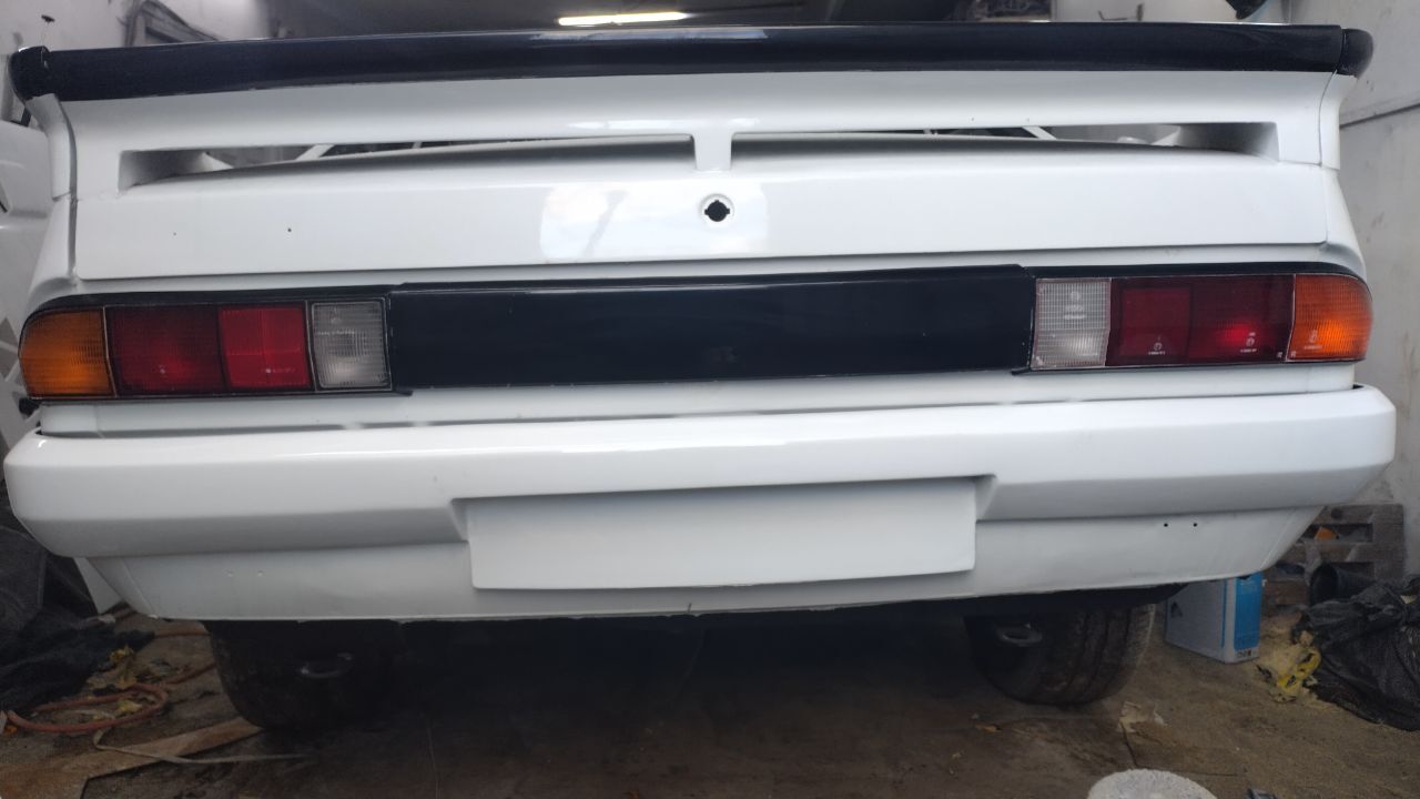

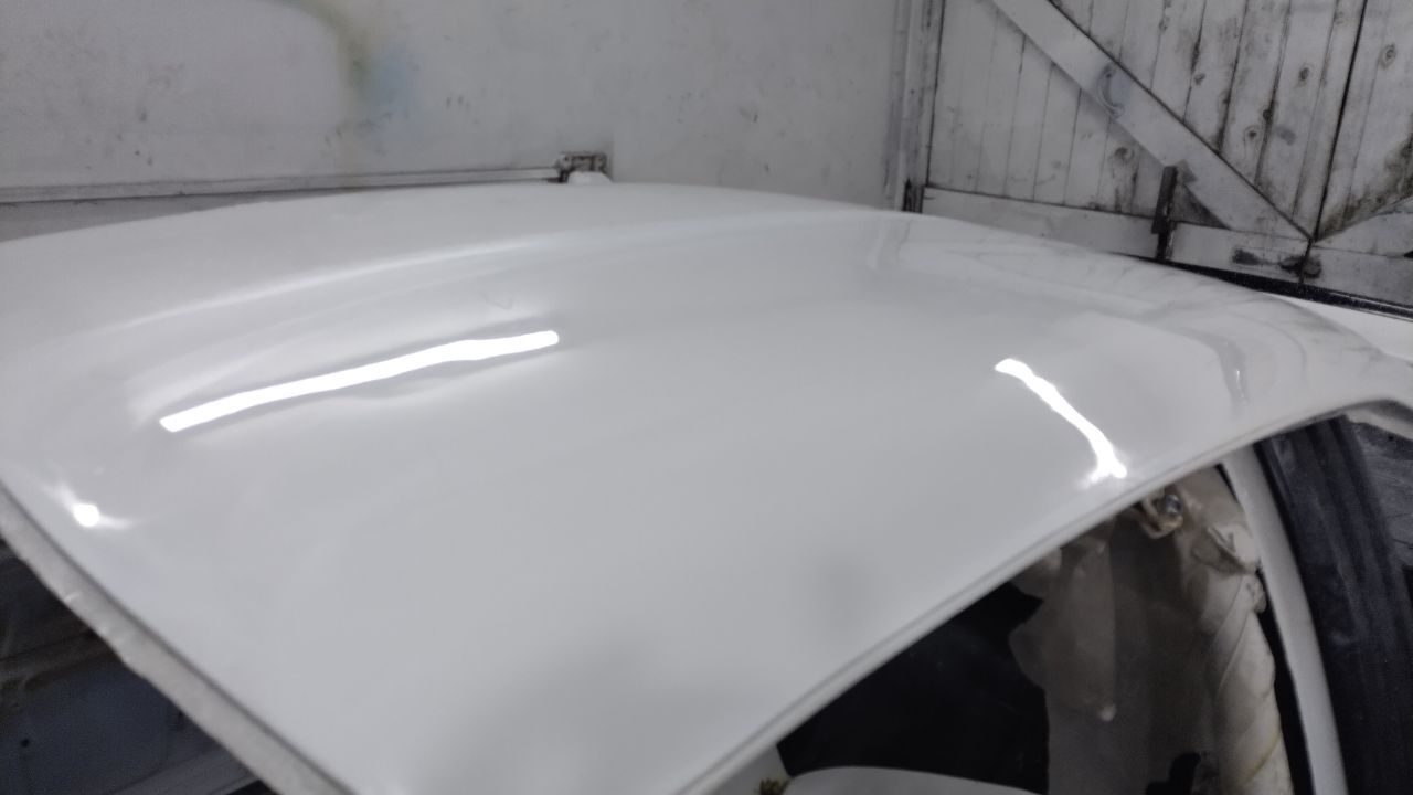

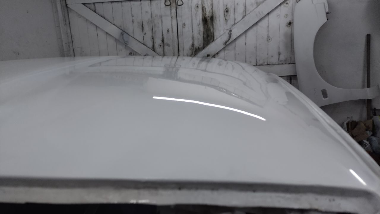

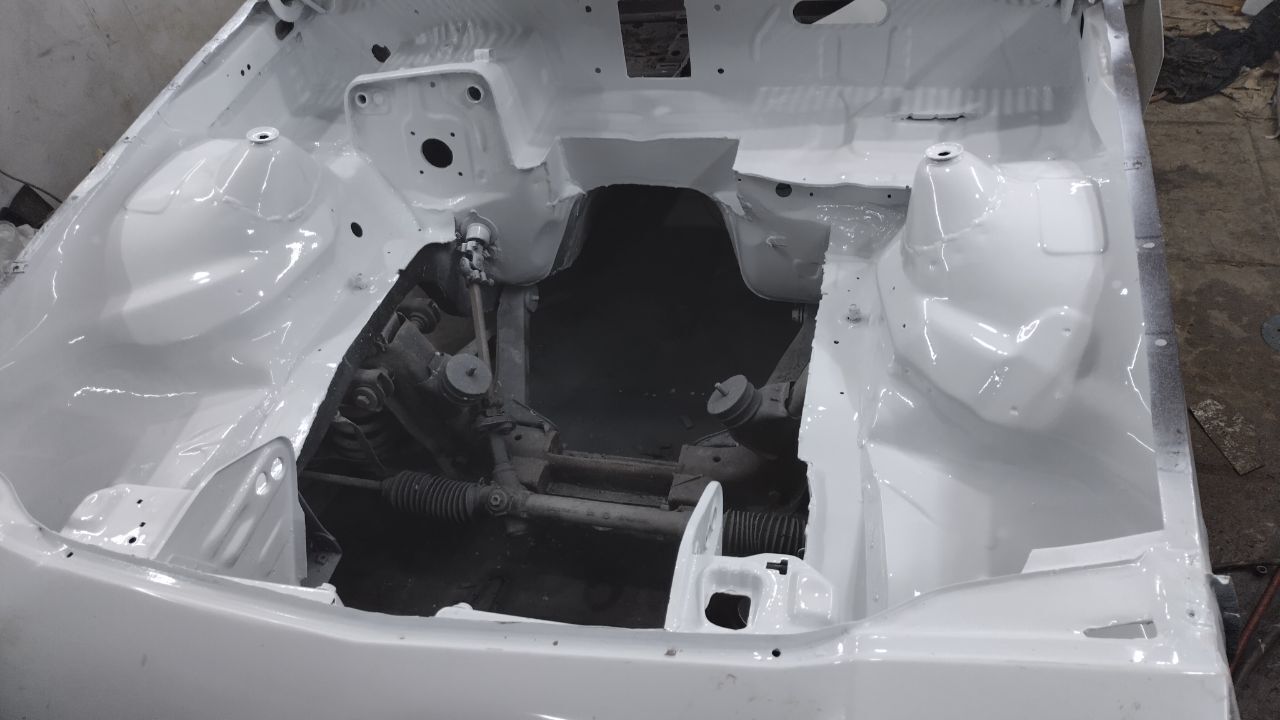

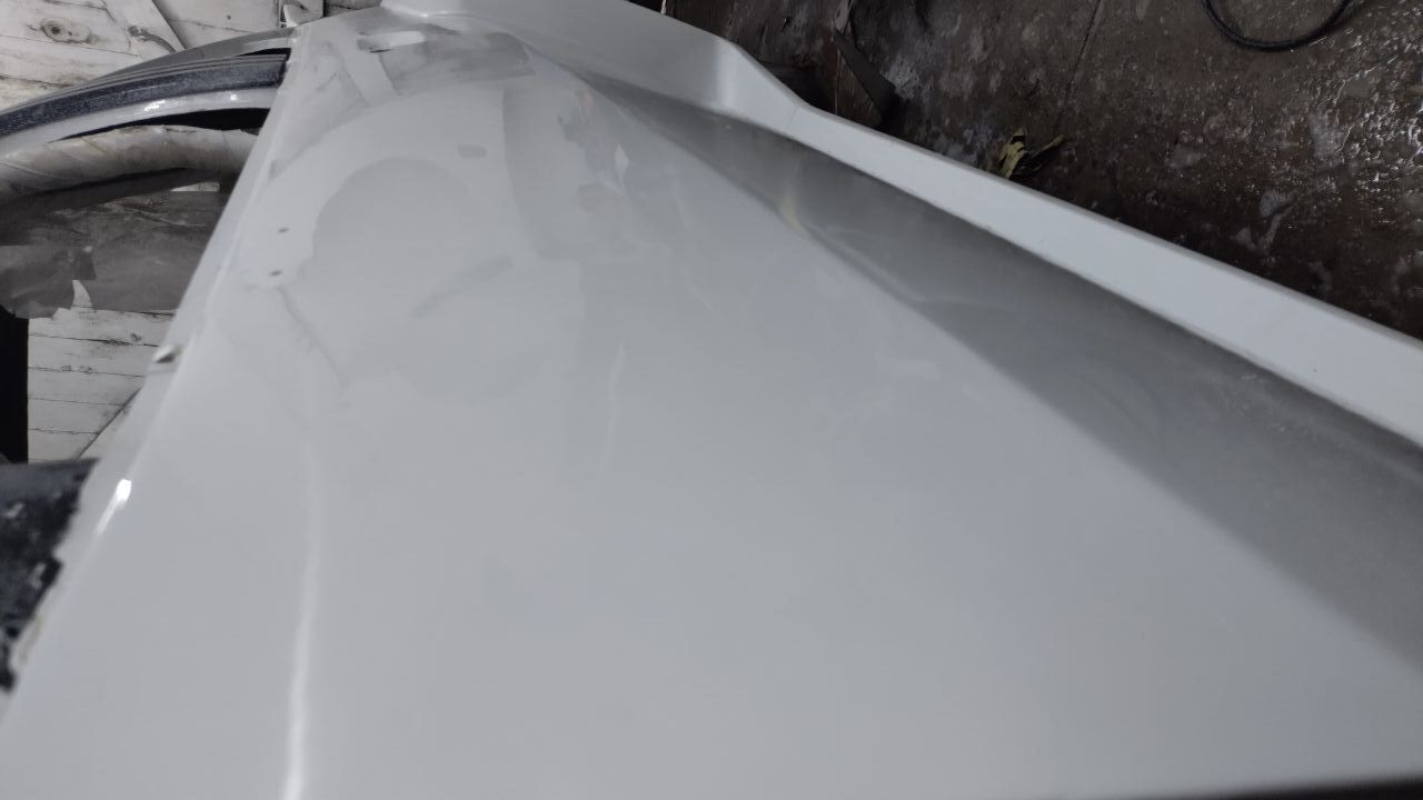

Tis very white 😂
IMG_20240904_102214.jpg.e8592923b36d050df00bf80d16542394.jpgIMG_20240904_102304.jpg.eee7b2ca89d61195f49283fc5ae1b983.jpg
The gaffer approves

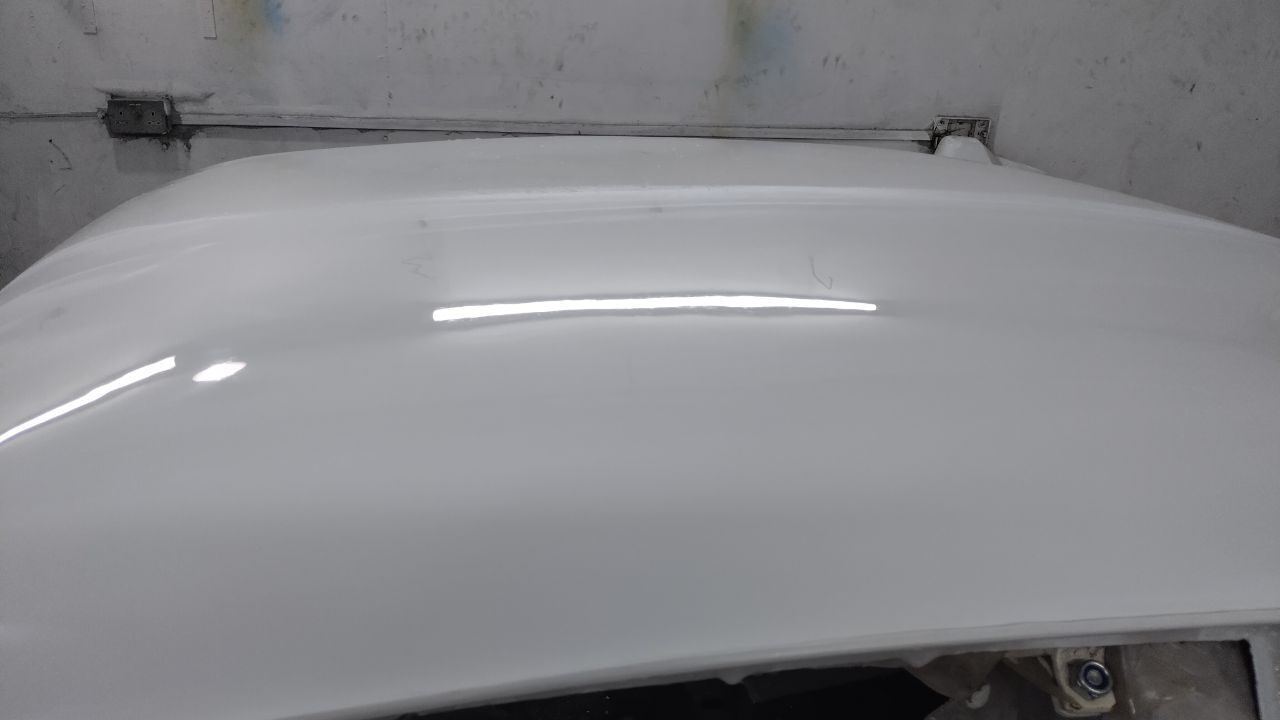

IMG_20240904_102314.jpg.5b6126cd786097a9a0db2ef4a892751d.jpgIMG_20240904_102119.jpg.f1fde383a313849a71f30d0298d94b46.jpgIMG_20240904_102123.jpg.36c11d18ccd8c9d5dd23efb02f406e17.jpgIMG_20240904_102652.jpg.0a4ef914b9f19b0cfc4ddeff4f3bac18.jpgIMG_20240904_102701.jpg.b1c6ed3861d553df919f1a9fbab8a2d5.jpg

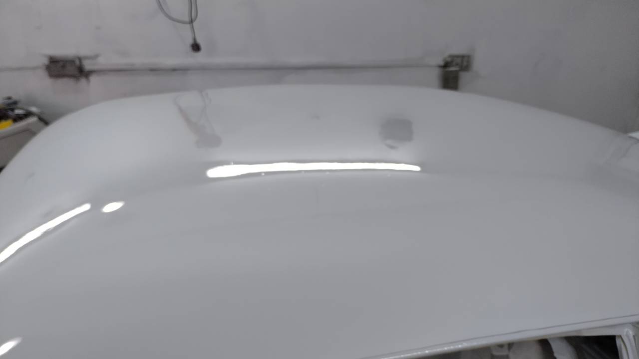

Little but of urethane wave but it'll block out before it's buffed.

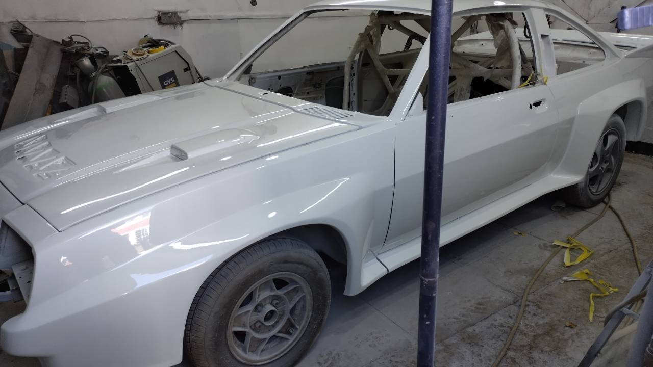

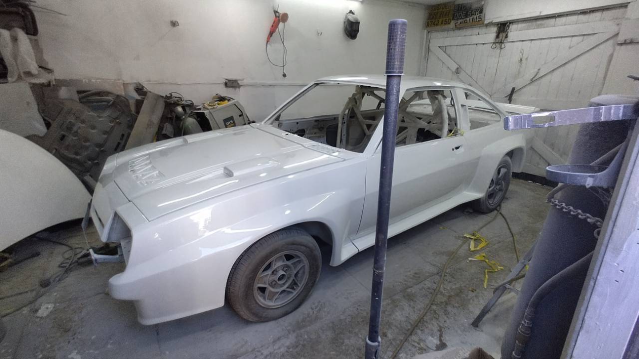

Front valance was done before I was put in hospital but I never posted a pic.
Just the black lip around the spoiler to do so hopfully that'll be done this weekend.

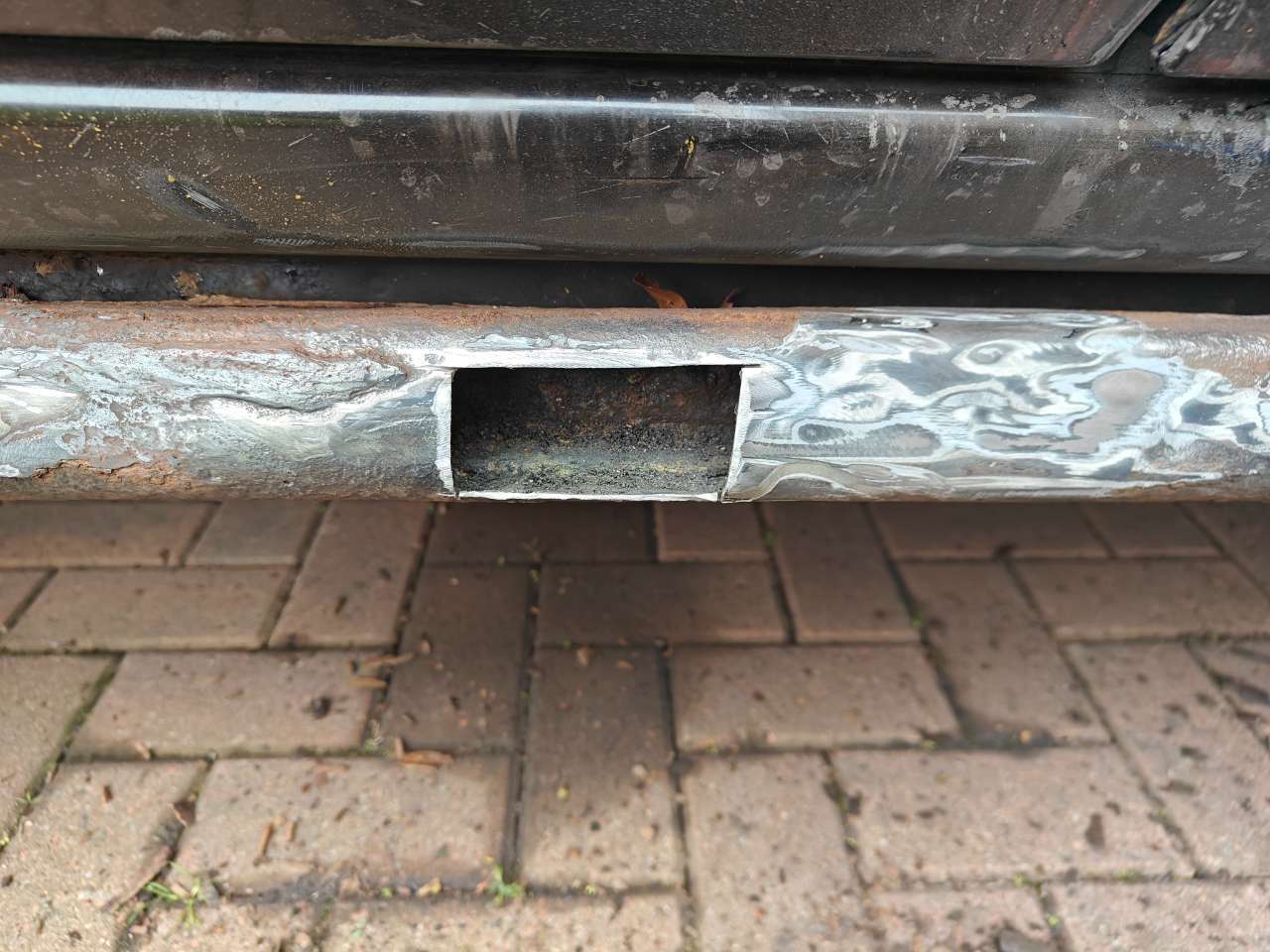

Well, it got advisories for rust on the sills last year but I chose to ignore them. The MOT ran out about a month ago so I set about prodding to see what I could find.
It's got rock sliders fitted from the factory and these were rusty, I thought (hoped) that the tester had meant these. I started on the driver's side and cleaned it up.
Made a repair patch
I'll spare you the pictures of my welding as I'm still shite at it but here it is with some paint on it 🫣
I chose to ignore the sills in this side but couldn't do the same on the other side sadly😳

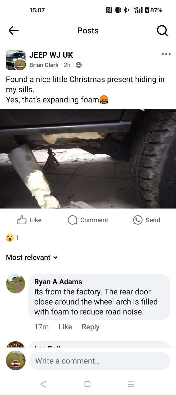

@GingerNuttz has cut all the old rust out. I posted this pic on the FB group and it would appear that foam is from the factory. Thanks Jeep!

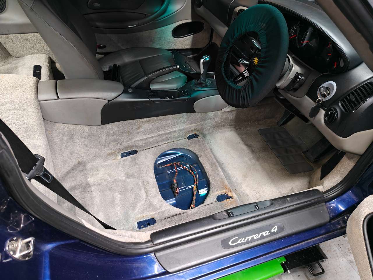

After getting this back from @GingerNuttz yesterday with added metal underneath I spent my Christmas Eve the traditional* way by trying to find the source of wet carpets in the Heep.
Removed the seats and carpet to get to this stage.
Despite spending a couple of hours inside with the hose pointing at various bits on the outside I'm no further forward.
There was a bit of a leak around the rear LHS door seal but the worst of the leak is in the front LHS and it doesn't look like that's where it's coming from. Sunroof, windscreen and door seals are all now fine so I'll dry out the carpet and try again in a few days time.
I did have a go at fixing it earlier in the year, checking sunroof drains and the drain for the Aircon which can cause issues.
I guess I might have sorted it but it's just never dried out properly? I think that's a bit optimistic though. We'll see.
