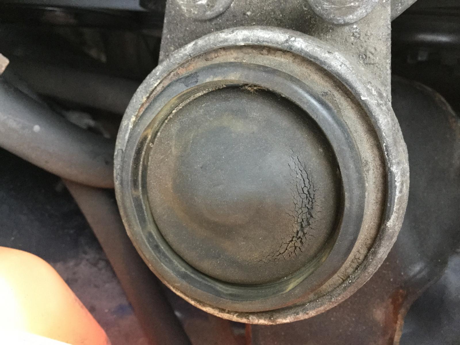

Take the cap off the engine mount - the one directly on the timing belt side. Underneath there's a diaphragm like top, mine is slightly perished and feels soft when I press into it. I'm guessing this is an oil filled mount. Could this be the problem?
yeah i did wonder if tired mounts arent helping , but the revs simply shouldnt drop with the accesories on , should stay the same or raise a little bit and if you do rev it yourself its totaly smooth
bet its something silly
Mine never feels as if it's about to stall it just vibrates. Hang on I'll take a picture of what I mean...
