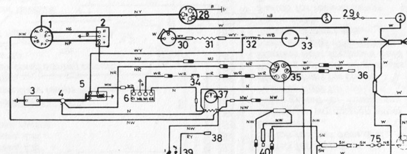

The fidgety rev counter might be interference from something electrical too close to the cable, Philibusmo's Mk1 Fiesta did the same thing and I found the wire for it in the engine bay was touching an engine component, tucked it up against the bulkhead and that sorted it.
I have the same suspicion, but believe it or not - I don't even know how a P6 counts its revs.
You've piqued my curiosity.  Let's have a look:
(click to enlarge)
The tacho (mis-numbered on the legend) is Number 34, top-centre.  It must have three wires (or two wires and an earth stud).
22 is the distributor, 44 is the LT winding of the ignition coil.
The W (white) wire is the 12V+ DC feed.
The WB (white-with-black-trace) wire is connected to the - terminal on the coil.
So, to cut a long story short, the distributor signal input is connected in parallel with the points.
This car is early enough to have an RVI tacho, which is wired in series:
(30: tach, 31: ballast resistor, 33: distributor)
Because they don't work with electronic ignition most people are converting to the later type, but there are a lot of "my rev counter has gone bonkers" posts about them too. Interference is the first thing I'll check for (maybe the wiring to that mystery 12v socket in the engine bay needs to be looked at closer) but I'll also dig out my spare cluster to see what kind of gauge that has.
Ahh, good.
So it's one of those tachos that if you disconnect it, the engine stops.
But your engine sounds like the ignition is running smoothly, so that suggests the points / coil / ballast / tacho series circuit current is flowing as it should.  This suggests the inner workings of your tacho are kaput.
Mind you, a dodgy condenser could also be telling you it's on the way out, so I'd check that first.
