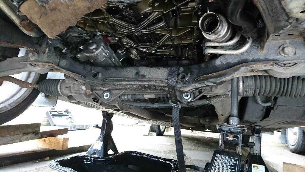

As Urko predicted it $h@t itself.
Anyway after about 14 hours under the car (on axle stands on my drive) and £400 on a recon left turbo it is working again.
The old turbo appeared to both be gummed up with carbon or something as it had partially seized and also the electronic vane controller box on the side of it was showing signs of distress as it had pulled the vane control arm hard up against its end stop, which according to the turbo specialist shouldn't happen.  I'm not 100% sure I believe that though.
The symptoms were slightly weird.  No error lights but gutless and the most horrendous jack hammer diesel knock if you attempted to push it anyway.  Limping home on a light throttle you wouldn't know that anything was wrong.  On the diagnostics we (me and a mechanic mate) noticed that the right airflow sensor was at 14 and the left at 1, and swapping them made no difference.
Although it's a twin turbo, with each side feeding its input through its own airflow meter, the outputs are Y'd together to go through a common intercooler, a common throttle flap and boost sensor, and then it splits again to go into the two inlet manifolds.
If one turbo seizes then the engine can simply pull all its air through the other side as they are Y'd together.

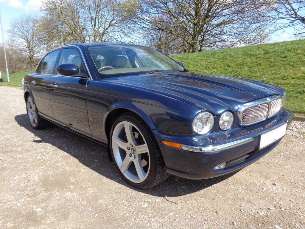

I had those 19" wheels on mine too, changed 'em for some 17s from a very early car - don't look as agressive but rode nicer, and as the wheels weighed less and had narrower tyres, but kept the same rolling circumference, I got a slight improvement in fuel economy.

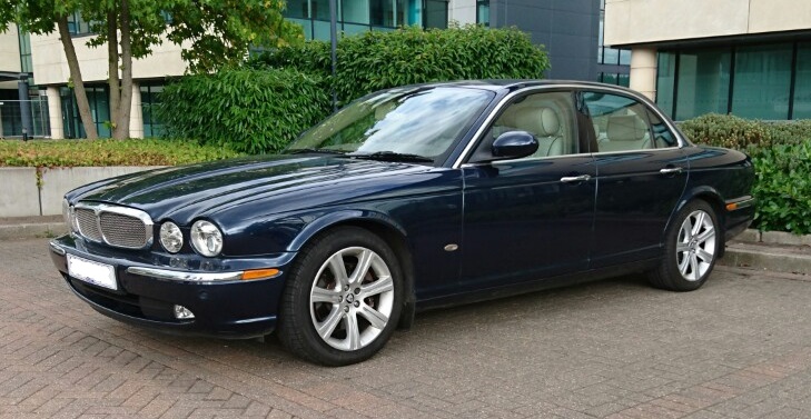

Here it is on the 17s
BL05 NOH was the reg - it's a very early diesel - the VIN isn't in the production range for Diesels and it has the 05 and a half updates - sound deadening glass, factory bluetooth, rubbing strip delete and side repeater update.
