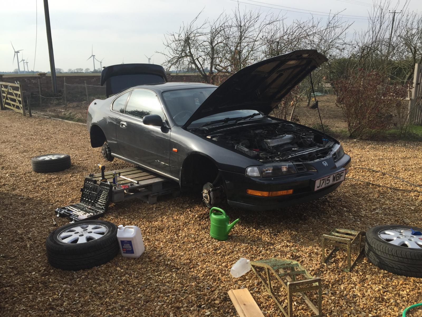

Back from Shah Jahan, now part 2.

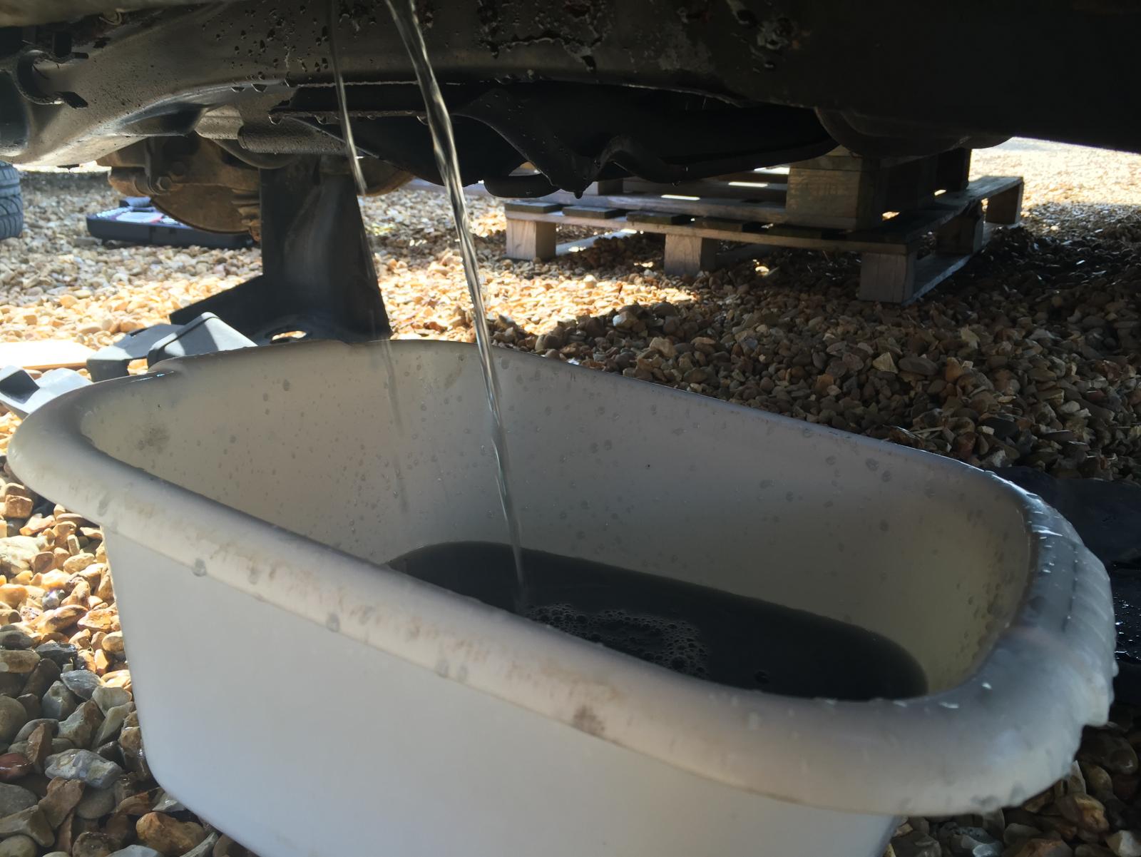

Coolant. First needed the entire engine undertray removing to access the radiator drain plug. The service manual has a picture of a bolt to drain the coolant from the engine block. This bolt either doesn't exist, or is definitely not accessible when the car is balanced on creaking pallets.  I tried one bolt that looked to be in the right place (looking a bit like a sump plug). This just pooped out a bit of oil into my bowl, so I hastily torqued it back up.   In the end I decided to change whatever was in the radiator and weird little expansion tank.
I measured a radiator full of plain water from my watering can (3.5 litres), dropped that back out, and then chucked in 1.75 litres of coolant and 1.75 litres of water to get the 50:50 mix.
Brakes. Turns our the Prelude's brake fluid tank isn't compatible with my Ezeebleed. So that will have to wait for another day.

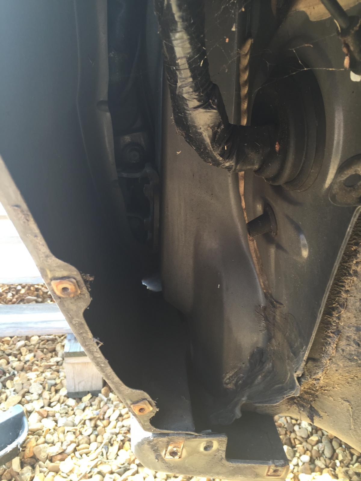

While I had the wheels off, I whipped off one of the front arch liners.  Not a hint of grot underneath, it looks brand new.
The back arches are a different story. I'll worry about that later.

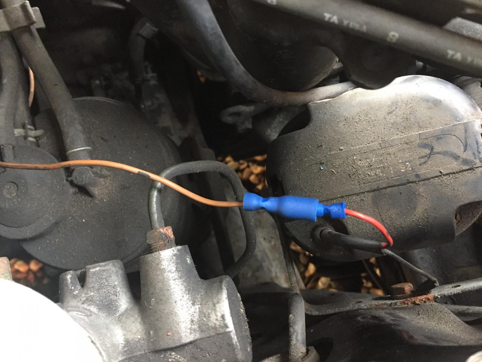

Last little jobs. DW had cut the alarm wire to stop it sounding when the battery was flat in the fob. I reinstated it with a crimped bullet connector. Not sure why I bothered, as no combination of opening doors, windows, or moving around inside the car with the alarm set seems to set it off. At least the bullet connector makes it easy to disconnect again if it gets a mind of its own.

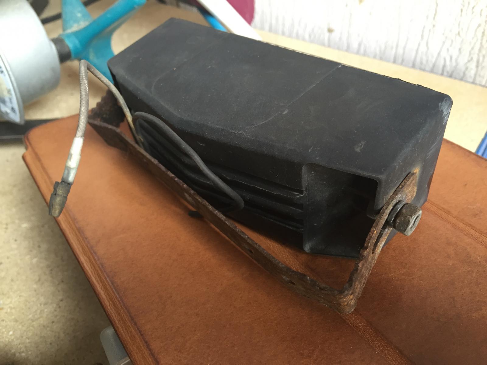

Final job, remove the fake fog lamps. These were just fixed to the front bumper with rusty self-tappers. Never connected, the wires were just tucked behind.  I had thought about keeping them and wiring them up, but decided against.

It was FPB7 who cut the wire, as I'd neatly demonstrated that the alarm definitely works and it was very, very loud. Alarm had been set with the blipping and all I did was unlock the door with the key and open it.

The alarm is indeed satisfactorily loud. Muriel had a well-spent £180 there.  However the only thing that I could do that actually sets it off is pressing the other button on the fob.  Presumably it's a cunning design to catch out thieves who steal the keys and press the wrong button.

Seems right to put up this picture of the new home for those spotlights.
