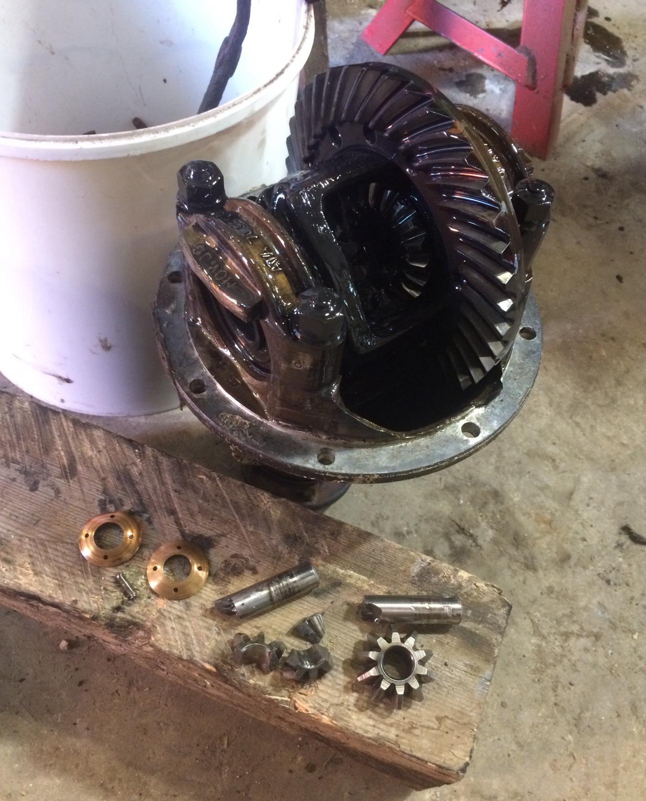

Coming home from work a couple of months back there was a big clonk and the engine stopped. I initially thought, shit, its seized up but luckily I managed to freewheel off the main road into the village, and when I stopped it fired up fine. Selected a gear, let clutch out... grrrrrrrrr clonk.... no movement... peep underneath and the propshaft is merrily spinning.

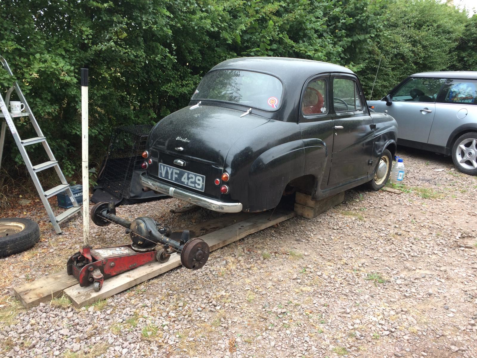

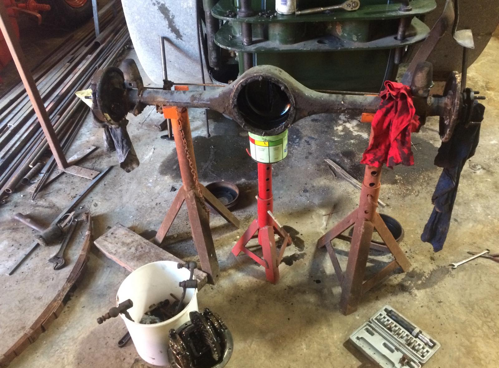

I needed to sort a crusty spring hanger out so dropped the whole axle off. Easy job with only one spring pin snapping.
One spring bush is shot so that's another little job. I got a 3.9:1 diff from a midget off a bloke on Facebook within a week but I've been so busy I've only had a chance to get the axle apart today. Bearings and hubs look fine so I'll order some gaskets and a pair of hub seals and bosh it back together. Really missing driving it and the bastard Land Rover drinks twice as much fuel on short journeys.

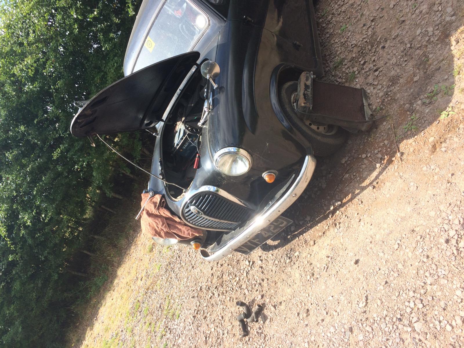

The a35 was dusted off and a test thrash revealed the new diff was almost silent, GR8 news, however the engine was leaking coolant from somewhere and upon investigation the usual A series cylinder head bypass hose was the problem.
I bought a whole new set of hoses and one lunchtime got them all swapped over, surprising myself and only swearing once.
