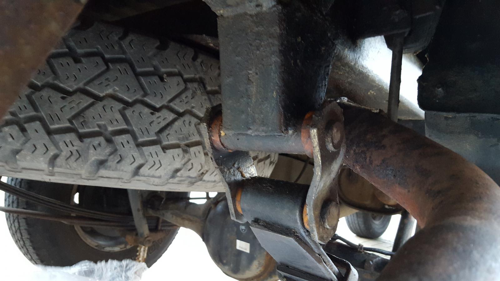

After the 2017 head surgery it has been 100% reliable but with the mot due in January I decided to treat it to a couple of days (5) of cleaning off the underside and it's chassis and applying the the best part of a gallon of waxoyl to it's nether regions.
There can't be a more hateful job than chipping/scraping away at scabby chassis box sections but once done and treated it did look good.
With the waxing taking me longer than I anticipated the mot had ran out on the 17th but I booked it in for tomorrow morning with the plan of giving it a seriously big clean up and then trying to sell it on to the dubious community that like cheap 4x4's.
