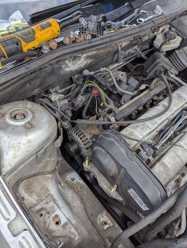

The focus was running like a bag of nails.
Code scan showed misfire, O2 not working, dash cluster loses connection, Imrc stuck open.
Swapped in a new coil pack
PXL_20241207_130608223_MP.thumb.jpg.bfd1a8adbc28e9ccfaeed858f204cc19.jpgPXL_20241207_130729088_MP.thumb.jpg.aa57c16952cd246480e17c22a7aec0fb.jpgPXL_20241207_130958203_MP.thumb.jpg.3441cc3b7c824c2b879f02298098a1e9.jpg
