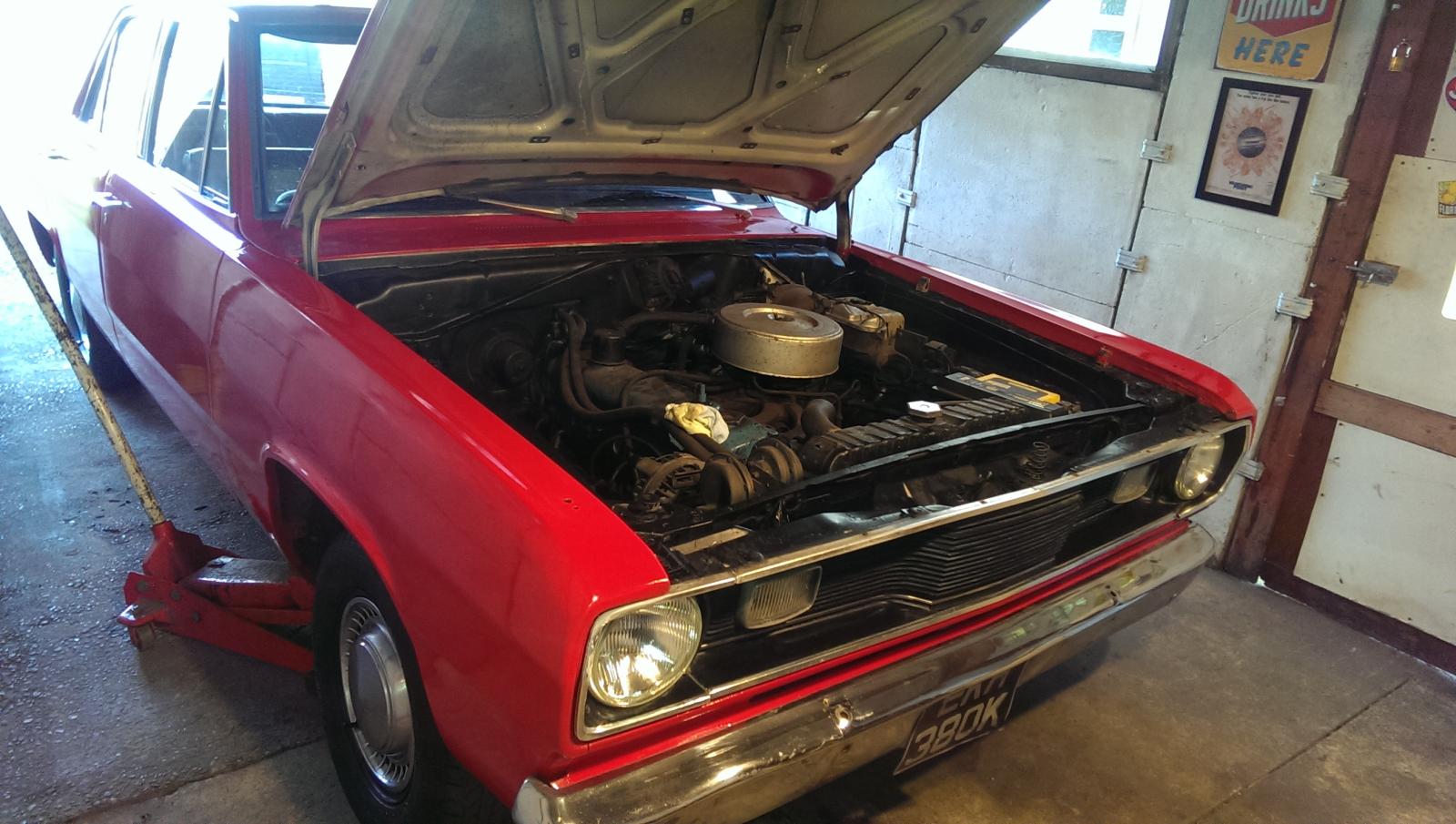

DaveAspley Posted February 28, 2016 Author Posted February 28, 2016 Mines a generic screwfix 90 quid bag of arse with whatever wire I can find, it's utterly terrible. Constant live torch too, gr8++++100 for accidentally spot welding the engine block

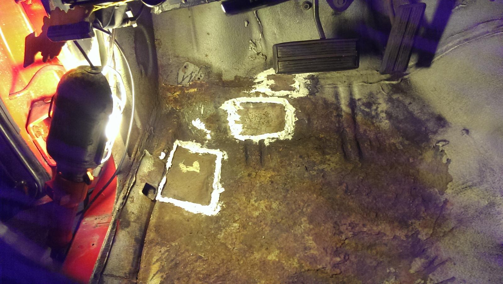

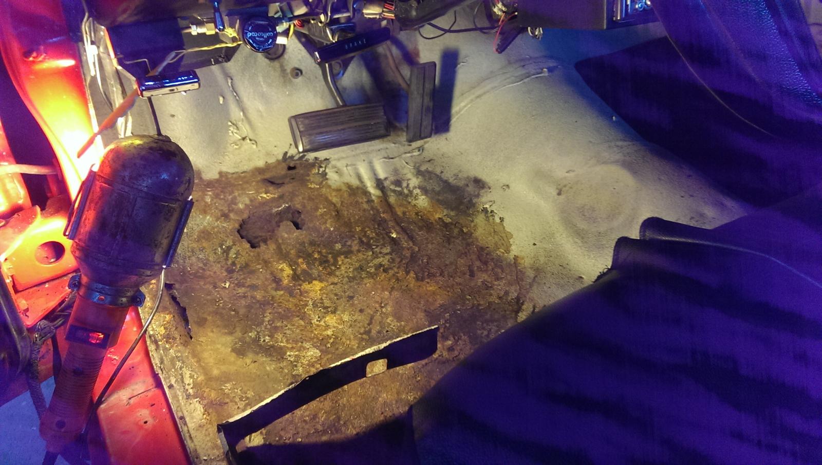

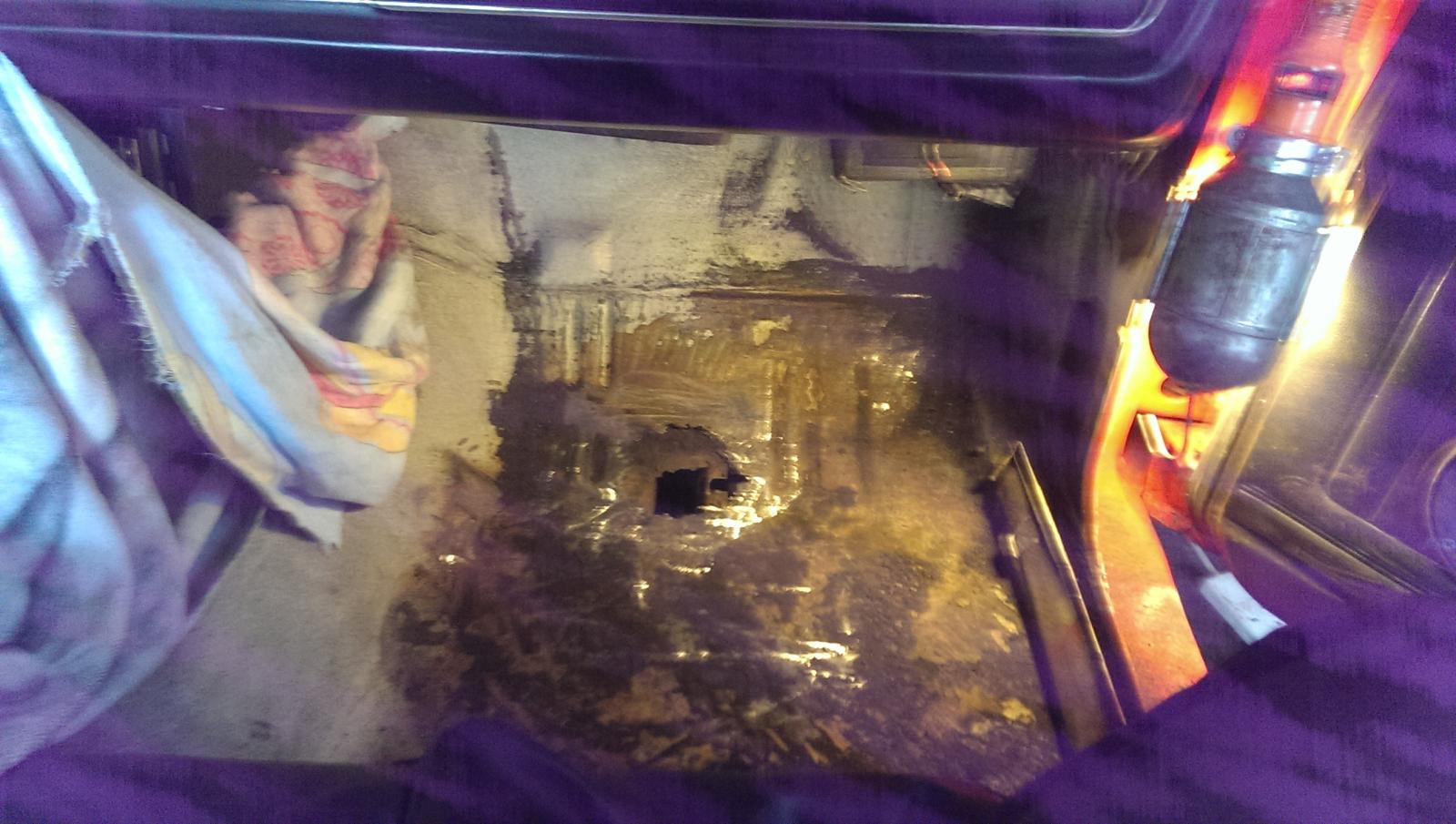

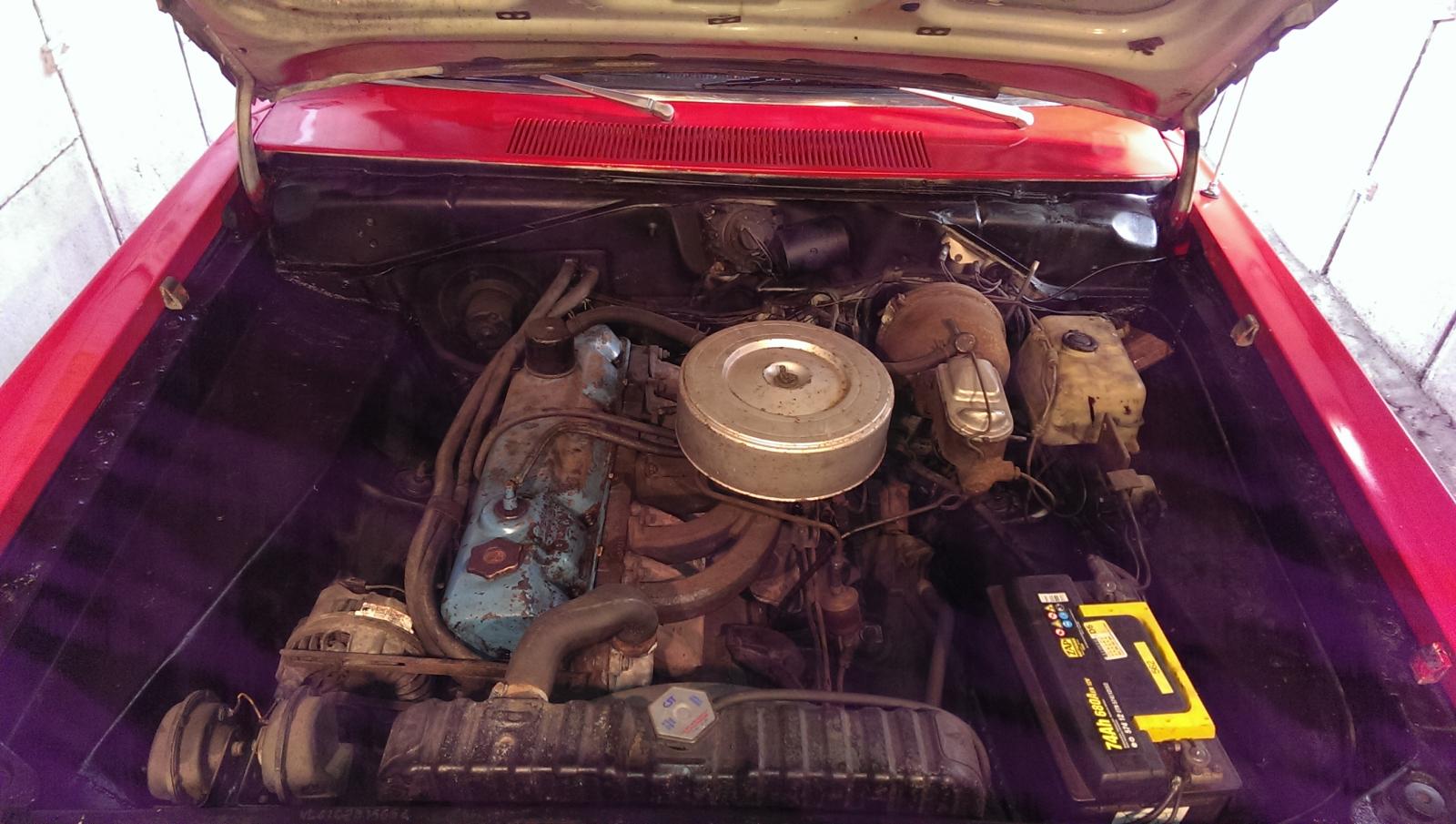

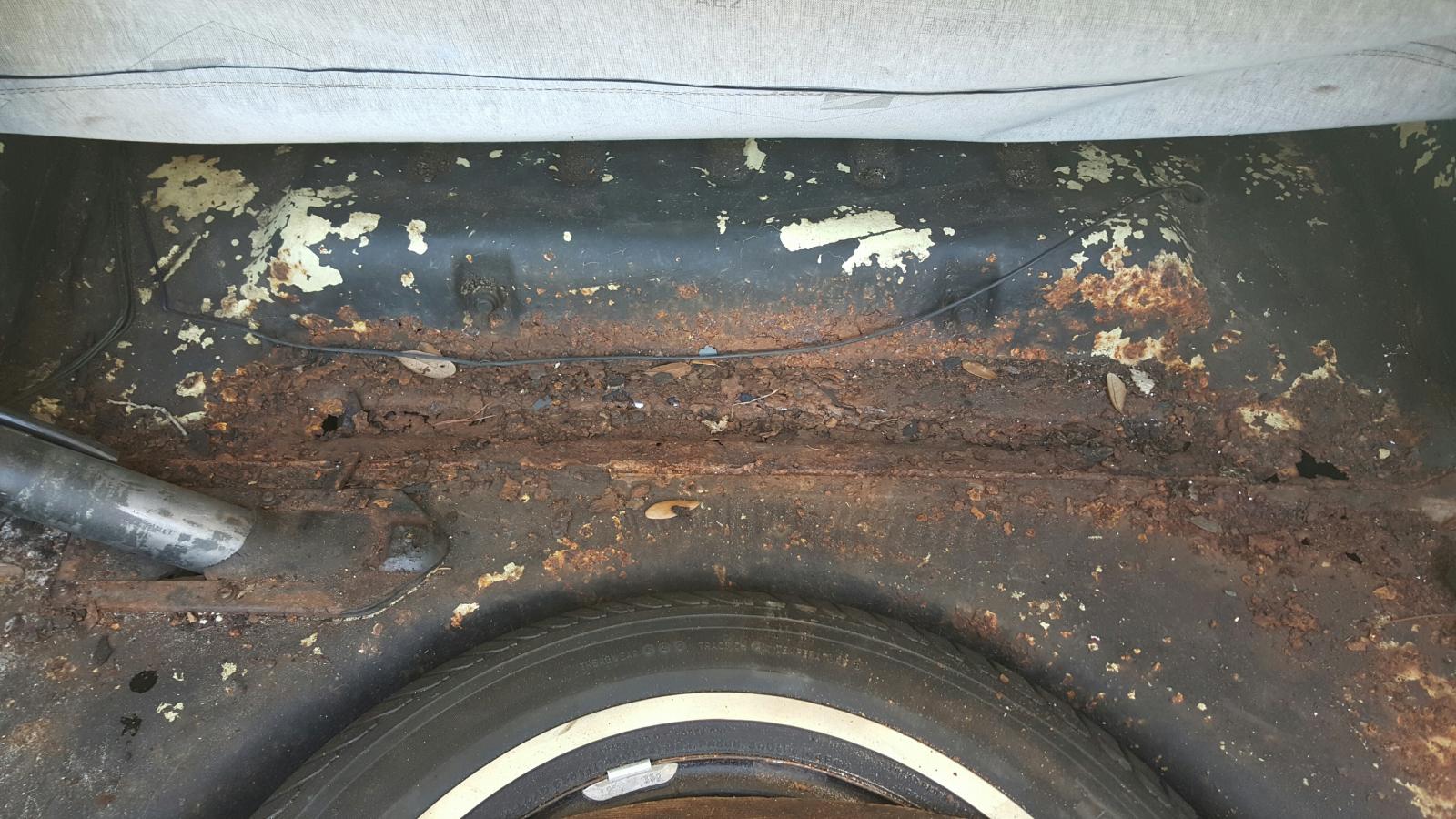

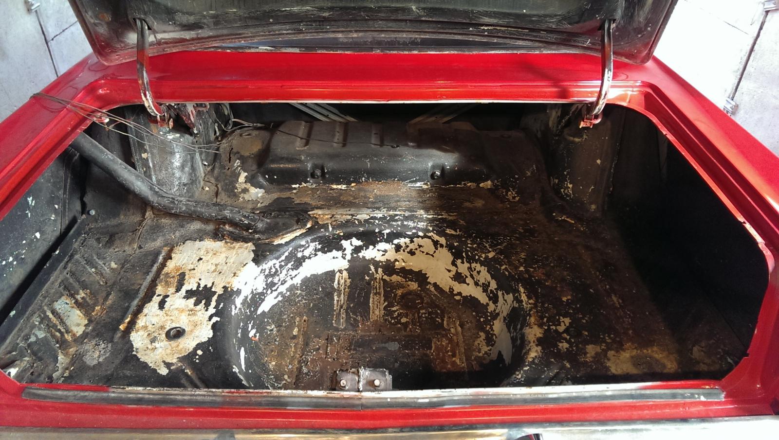

DaveAspley Posted February 29, 2016 Author Posted February 29, 2016 Kicked off at 8.30 this morning and managed to get nearly all day on it. Works always dead at the end of Feb so trying to use my time wisely! Enigine bay now the satin black has cured. Massive chunks of fibreglass pulled out of the boot floor, pigeon patches firmly in place now Gave the floor a good scrub , recoat the whole lot in waxoyl and painted the inside of the boot lid satin black Poked more holes in the floorpans Bunged some more scruffy patches in , once I'm more flush I'll be buying new floor pans, inner wings and stuff and get it done properly. Panels are 30-40 quid each. brickwall, UltraWomble, Skizzer and 3 others 6

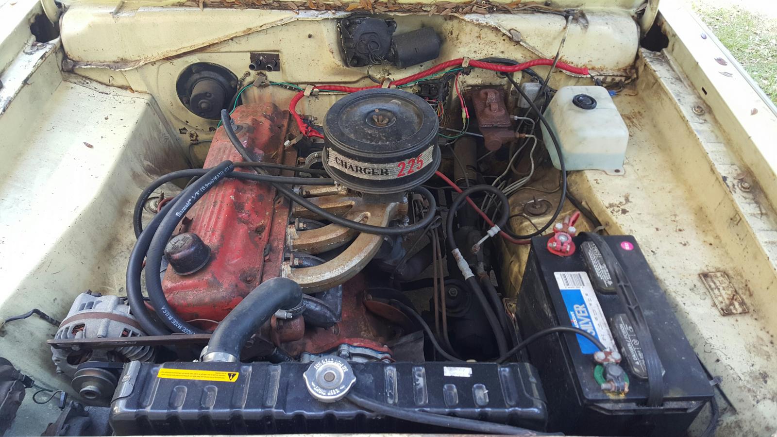

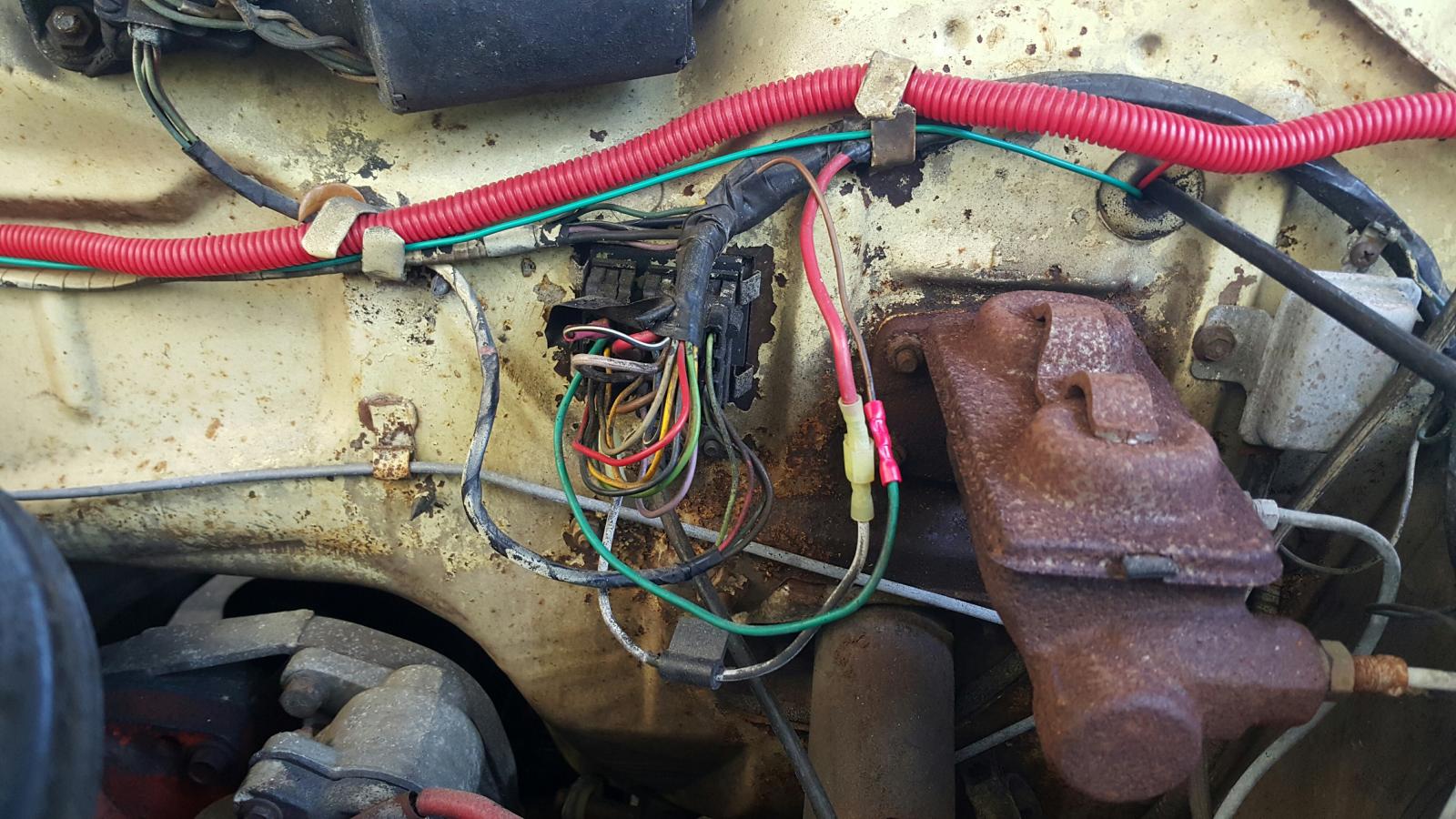

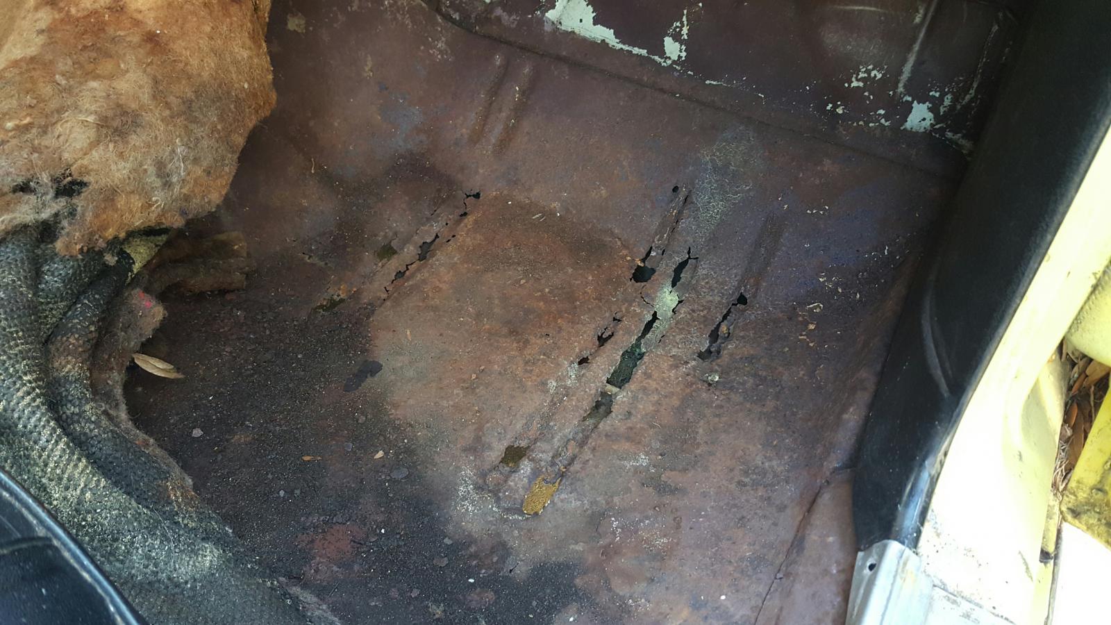

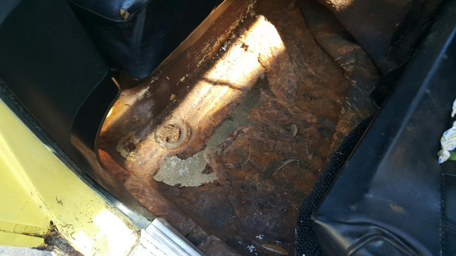

darkfour Posted February 29, 2016 Posted February 29, 2016 Your floor pans could be worse, this is what I'm neglecting to address on my 67 convertible. I have new floor pans for both sides but haven't found the time to get stuck in. Passenger (Right hand side) front Passenger rear Trunk Here's my engine bay for reference and if you have any electrical problems then this should be your first port of call. Mopar's notoriously unreliable bulkhead connector. eddyramrod, danthecapriman, Fat_Pirate and 6 others 9

DaveAspley Posted February 29, 2016 Author Posted February 29, 2016 EEK! Now THATS corrosion! Will check the bulkhead connector , have lost the 12v down to the oil pressure switch so the light doesn't come on.

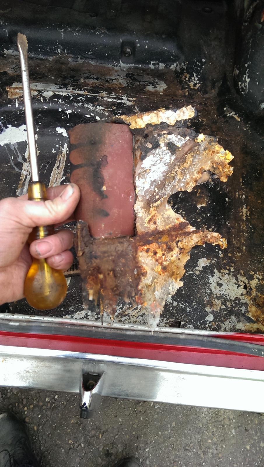

DaveAspley Posted March 1, 2016 Author Posted March 1, 2016 Feeding the pigeons again today....Also made a new trunk lid support bracket (American yo!) Once I'd finished "welding", all the surfaces have been treated to a thick coat of FLAG rust convertor paint. Brilliant product from toolstation , it's left nice shiny metal and a protective skin to paint over. Arrggh my eyes!!! Yeehah cowboy!!! In other news , ordered a new screnwash pump for £5 from the states. And the indicators are flashing pure white at the front, so I need twin filament orange bulbs. brickwall, eddyramrod, andrew e and 1 other 4

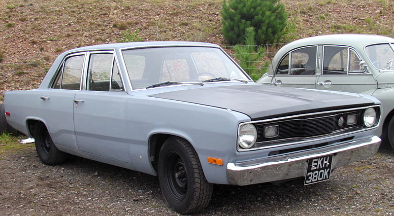

DaveAspley Posted March 1, 2016 Author Posted March 1, 2016 How it used to look apparently. Have got the trunk trim but its bent to buggery, side marker lights have been blanked too by the looks of it. I like the grey version... Tempted to redo it like this! And in its ratty orange stagehttps://www.flickr.com/photos/gmhorsepower/15244682588 Skizzer and danthecapriman 2

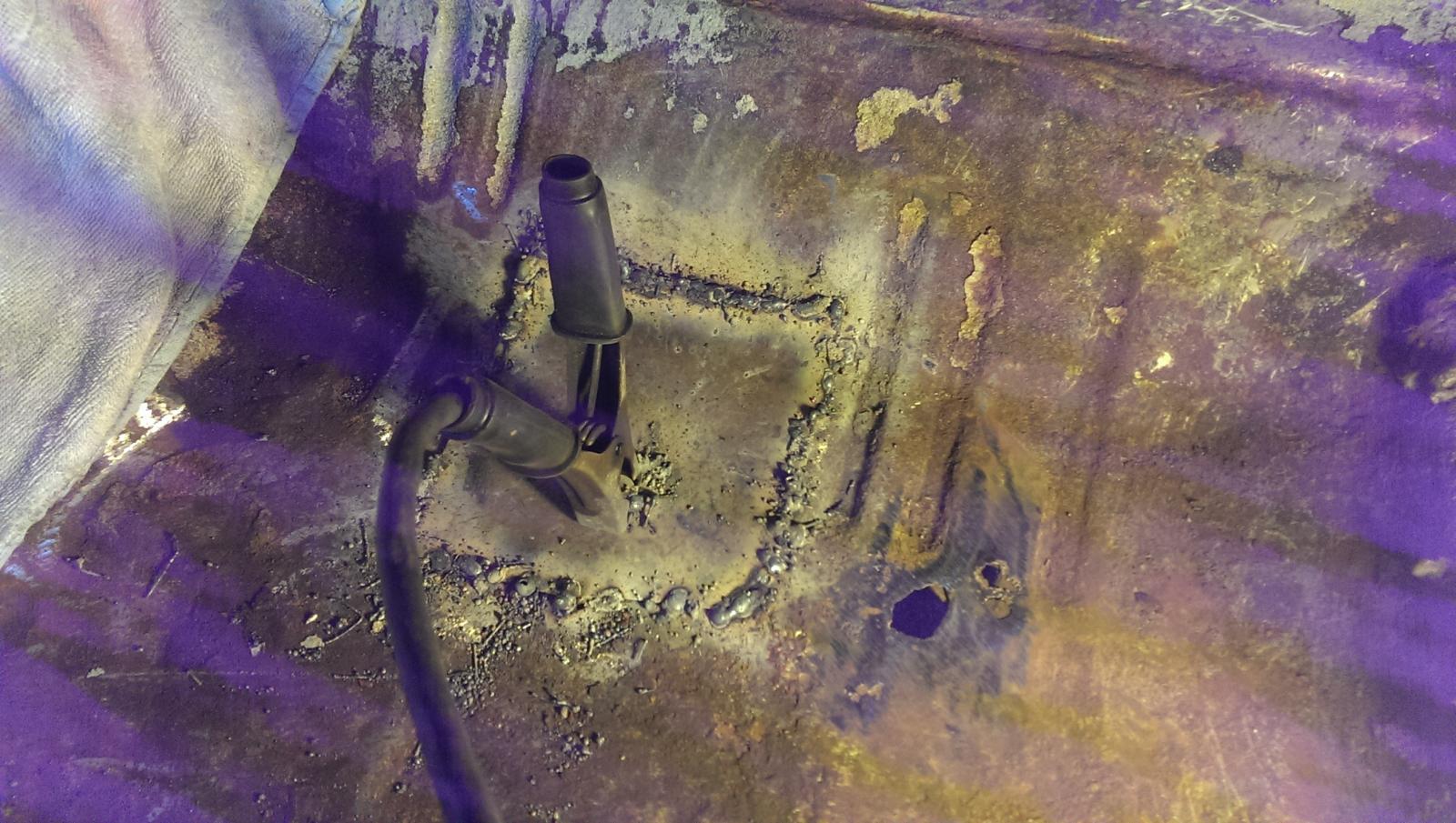

danthecapriman Posted March 1, 2016 Posted March 1, 2016 Coming along nicely. Not intended as a criticism, but when your welding the two steel surfaces to be joined must be as clean and shiny as possible. If there's even surface rust still there the weld won't penetrate well or 'flow' properly. It'll also spatter and fart as your going along. The rust doesn't conduct very well when the arc is struck and it contaminates the weld pool.In the pics it looks like your trying to weld straight onto the rusty floor pan surface. alf892 1
DaveAspley Posted March 1, 2016 Author Posted March 1, 2016 All advice welcome, I've never worked with anyone who could weld so it's all self taught through trial and (mostly) error. Its hard to see because of all the crap around it but I'd ground a border around the hole to stick the patch too, even welded a stud to the plate do the earth and that didn't take either just a pile of slag. Hate welding!! danthecapriman 1

Bren Posted March 1, 2016 Posted March 1, 2016 All advice welcome, I've never worked with anyone who could weld so it's all self taught through trial and (mostly) error. Its hard to see because of all the crap around it but I'd ground a border around the hole to stick the patch too, even welded a stud to the plate do the earth and that didn't take either just a pile of slag. Hate welding!!Once you have picked it up a bit better Dave you won't look back. danthecapriman 1
danthecapriman Posted March 1, 2016 Posted March 1, 2016 All advice welcome, I've never worked with anyone who could weld so it's all self taught through trial and (mostly) error. Its hard to see because of all the crap around it but I'd ground a border around the hole to stick the patch too, even welded a stud to the plate do the earth and that didn't take either just a pile of slag. Hate welding!!It is just a case of plenty of practice and cleanliness. As long as the welder is set up properly, and you have clean rust free surfaces it should get better with practice. Speaking from personal experience, I'd recommend using gas instead of gas less wire. I've tried gas less and didn't get on with it. Once I started using a small regulator and disposable Co2 bottles I found my welding improved massively. The bottles and regulator aren't expensive and most gas less mig welders have the ability to run with gas if required. Keep at it though, your cars fantastic and well worth the effort. DaveAspley 1

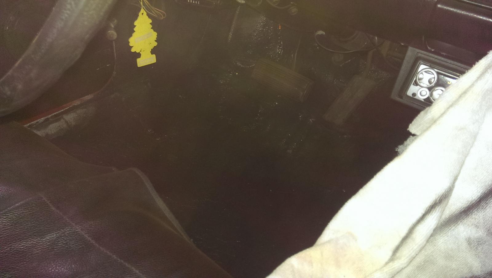

DaveAspley Posted March 3, 2016 Author Posted March 3, 2016 New carpet for the front purchased from a mate who trims classic Jags and the like. £20 for a considerable amount. Will cut and fit tomorrow some time. Was hoping to get the seats done when we go on holiday, same mate has quoted £300 to retrim in black vinyl and restuff both benches, got to see how the £££ go. Been driving it all over the area , any excuse! eddyramrod, alf892, danthecapriman and 1 other 4

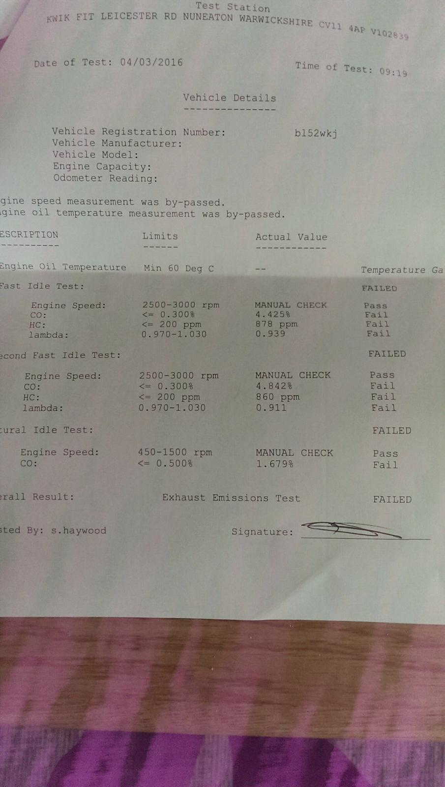

DaveAspley Posted March 4, 2016 Author Posted March 4, 2016 Today, my Mondeo did this during an mot: Which means it's got the usual Duratec 1800 issue of being terminally bollocksed. So this happened (once I'd fitted* the carpet) Retro rush hour! Held its nerve very well in two hours of errand running. Treated it to a visit to Stateside auto parts for some amber turn signal bulbs and parked next to a c-body Fury. Poor Valiant looked lost, they are tiny for a yank! danthecapriman 1

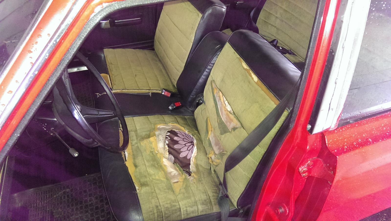

DaveAspley Posted March 4, 2016 Author Posted March 4, 2016 Just pulled the old vinyl seat covers off, it's LIME GREEN cloth and black vinyl!! My god the original owner was either color* blind or so frickin' 70's he looked like Groove Champion from Interstate '76...epic mid 90's pc game.. r.welfare, vulgalour, andrew e and 2 others 5

danthecapriman Posted March 4, 2016 Posted March 4, 2016 Today, my Mondeo did this during an mot:IMAG0836.jpgWhich means it's got the usual Duratec 1800 issue of being terminally bollocksed. So this happened (once I'd fitted* the carpet) IMAG0837.jpgRetro rush hour! Held its nerve very well in two hours of errand running. Treated it to a visit to Stateside auto parts for some amber turn signal bulbs and parked next to a c-body Fury. Poor Valiant looked lost, they are tiny for a yank!And people bang on about how good moderns are! Sell the Mondeo and run the Valiant I say! eddyramrod 1
vulgalour Posted March 5, 2016 Posted March 5, 2016 Lime green cloth in an orange car is a BRILLIANT colour combination and cannot be faulted. 42/10 eddyramrod 1
