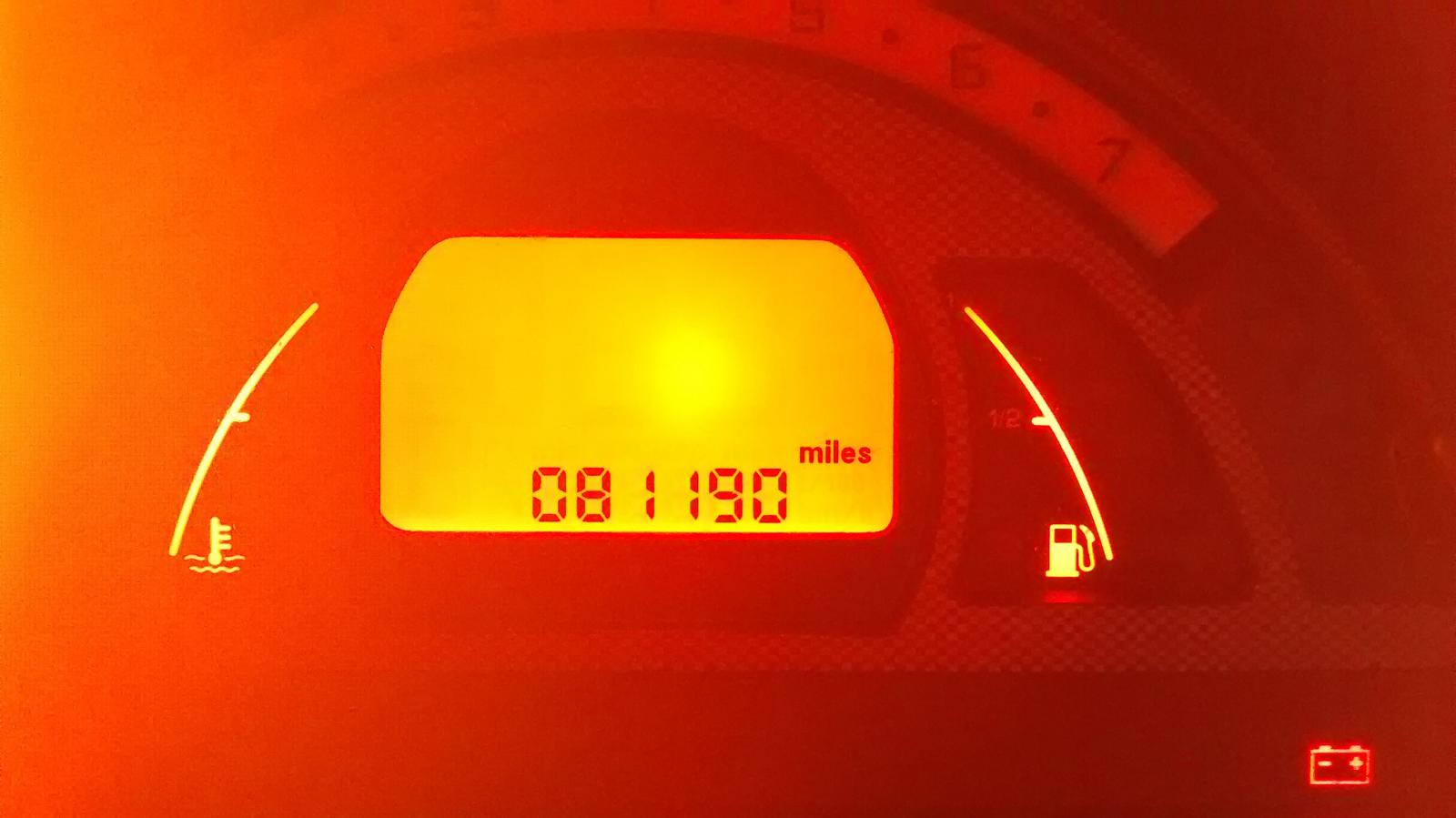

Can i ask at what mileage did your gearbox shite itself? As i currently have a car that uses the MA box, just thinking if I should be worried or not.
Can't remember tbh 80k poss, bought it for £250 the story I was given was the lass who owned it took it to her local garage when the clutch went. Was told it would cost too much to repair and she sold it to the garage who sold it to my boss who pinched the fuse box for his and I bought it off him for my dad.
