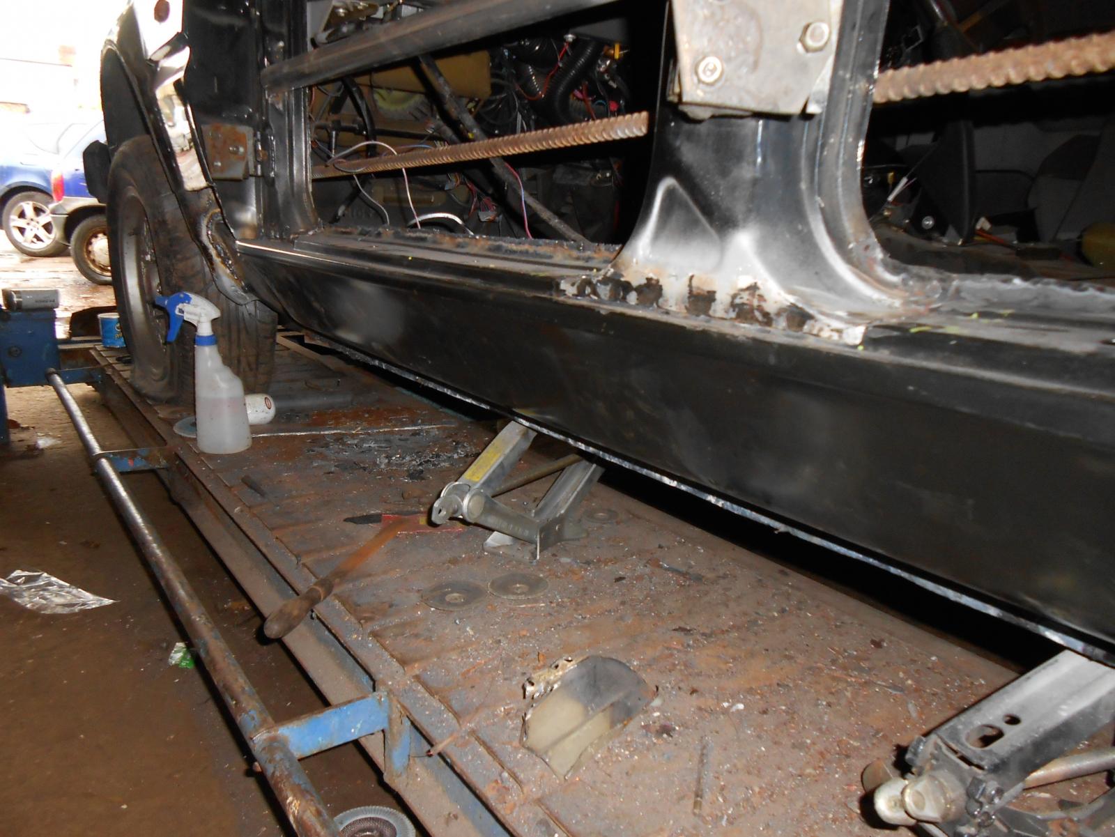

The formerly hacked up SD1 now sports a new nearside sill, a B-pillar with no crumbly bits and a floor without holes. The offside sill was thought at first to require similar attention to the nearside, but closer inspection reveals it to have only needed a few small patches (is this the first time an Austin Rover car has been found to be less rusty than expected?). This means the welding is now done and dusted, and the only bit of rust requiring attention is surface rust on the front valance area.

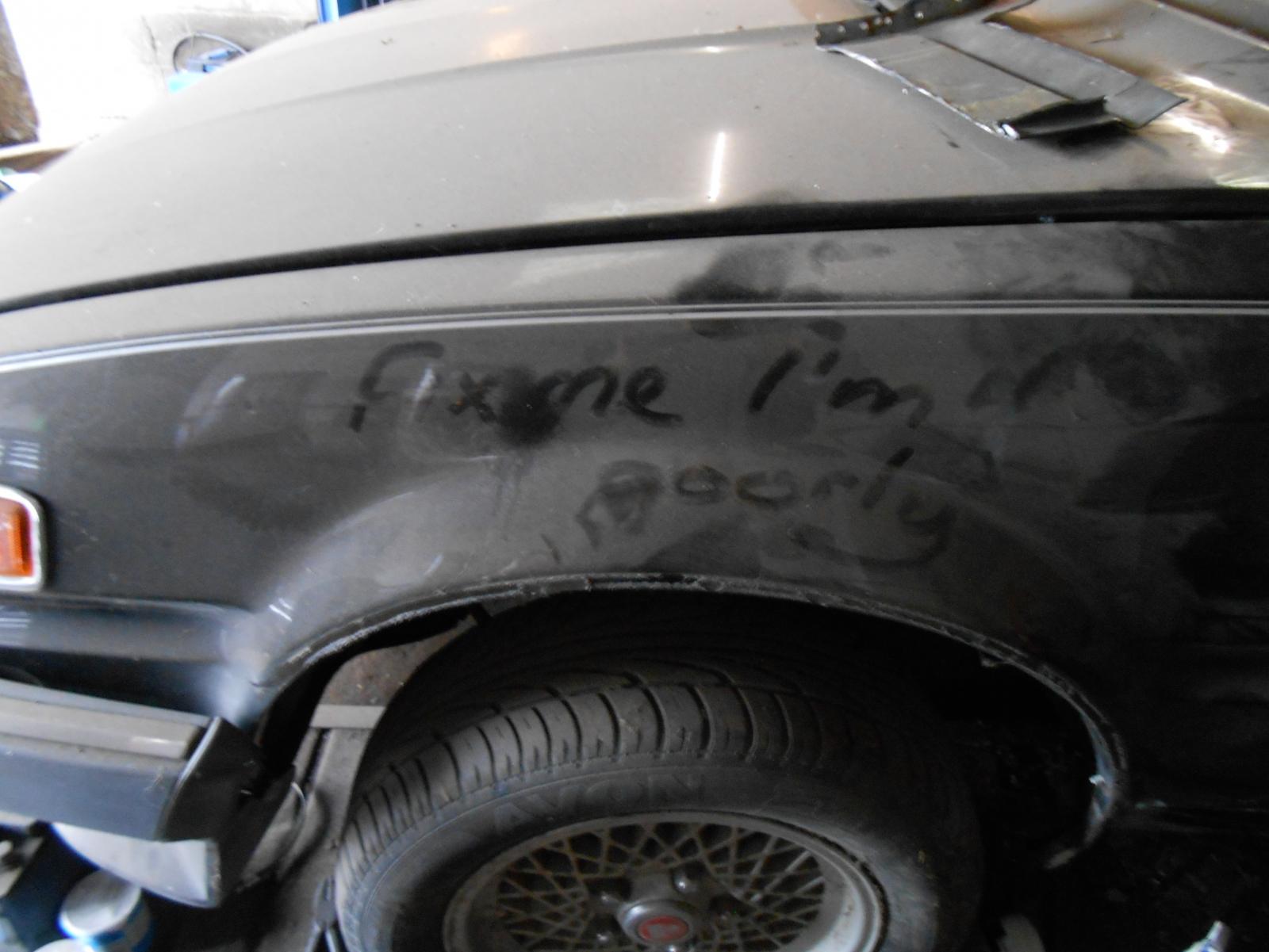

As you can see it is now coated in a protective layer of dust. Enough to be able to sell it for £3,000 more than it's worth as a 'genuine barn find'. Paintwork still immaculate underneath, though.
Other customers had left their mark.

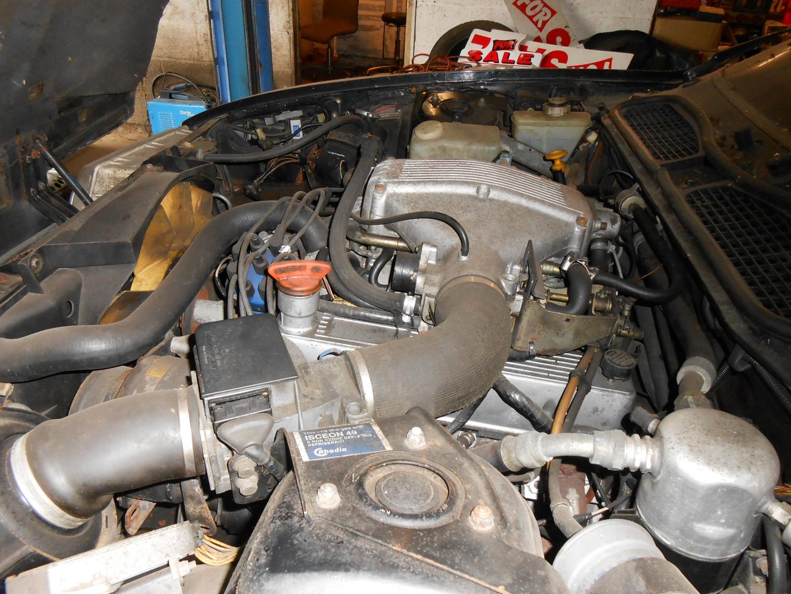

I observed the vast expanse of engine and ancillaries.

So, that's structural work, the rear axle rebuild and rear brakes done, what's left to do?
-New springs and dampers
-Fitting of polybushes, as having to fit a full set of replacement rubber bushes before each MoT is a bit annoying.
-New exhaust and manifolds, a Rimmer Bros stainless steel item which will probably need fitting with a sledgehammer.
-Four new tyres
-Fit new thermostat, vacuum hoses etc.
-Sort infernal gearbox oil leak, which seems to unsolve itself everytime it's solved. The gases created when the oil hits the hot exhaust could be distilled and sold as psychedelics.
Plus there are finishing touches like a bloody good tune up and service, and sundries such as a working windscreen wiper motor. But the finishing line is now in sight, and completion should be speeded along as I'll be going down to help spanner/carry stuff around gormlessly over a few weekends (which should also help cut down on the probable prodigious labour bill).

I have done all the welding myself - I will fit the new panels. It's a respray that I will have to farm out.
